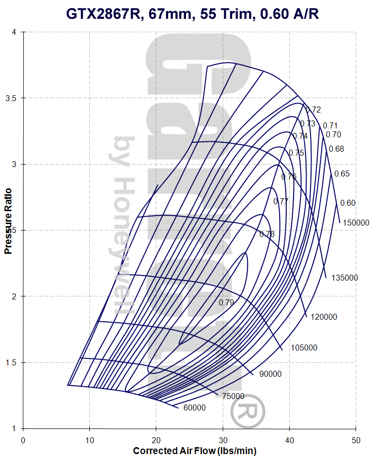

Anyway, back to superchargers and trying to make the XFs go faster. The following is are the compressor maps of the Eaton TVS R1320 and TVS R1900 supercharger on the XF 3.0 S/C and 5.0 S/C engines. Note those contours and their numbers. A "65" means that about 65% of the boost is actually useful increases in density while 35% is useless "heat generated. If you draw a line horizontal line across at 1.6 "Pressure Ratio" level you'll see that it'll cut across the most efficient horizontal traverse of the map. This is what your engine will see when you run the blower at 0.6 bar of boost (1.6 bar of absolute pressure is 0.6 bar of boost over atmospheric pressure which is 1.0 bar at sea level). If you draw a line across at running say 2.2 bar (corresponding to 1.2 bar of boost) you'll notice that the supercharger much less efficient -- doing less useful work and making a lot of useless heat.

Now, compare these maps to that of a good, modern, turbocharger like the Honeywell-Garrett GTX-2867R, you'll notice that the centrifugal compressor on the turbo (which is an internal compression air pump) is much more tolerant of increases in boost and higher boost levels. Not only does it reach 79% efficiency, you'll cut the maximum efficiency island contour whether you operate it at 1.6 bar or 2.3 bar. This is why generally speaking Turbocharged designs do better in mega boost applications while supercharged designs are best for modest increases in power with the focus being on being lag free and having a linear relationship between your left foot and engine behavior.
