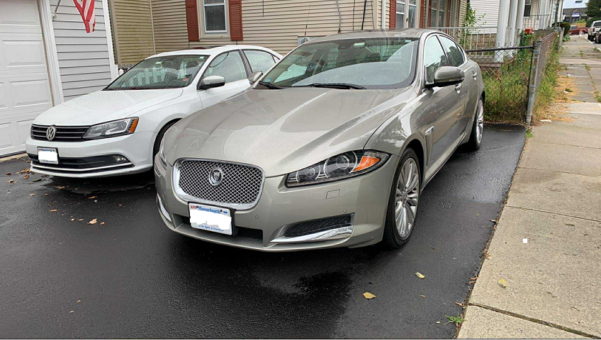

(Photos for reference and showing off...lol)
October 25 in Fall River, MA.
October '25 in Fall River, MA.

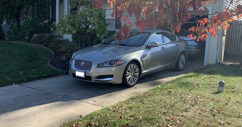

After an interstate thrash to my PA home.

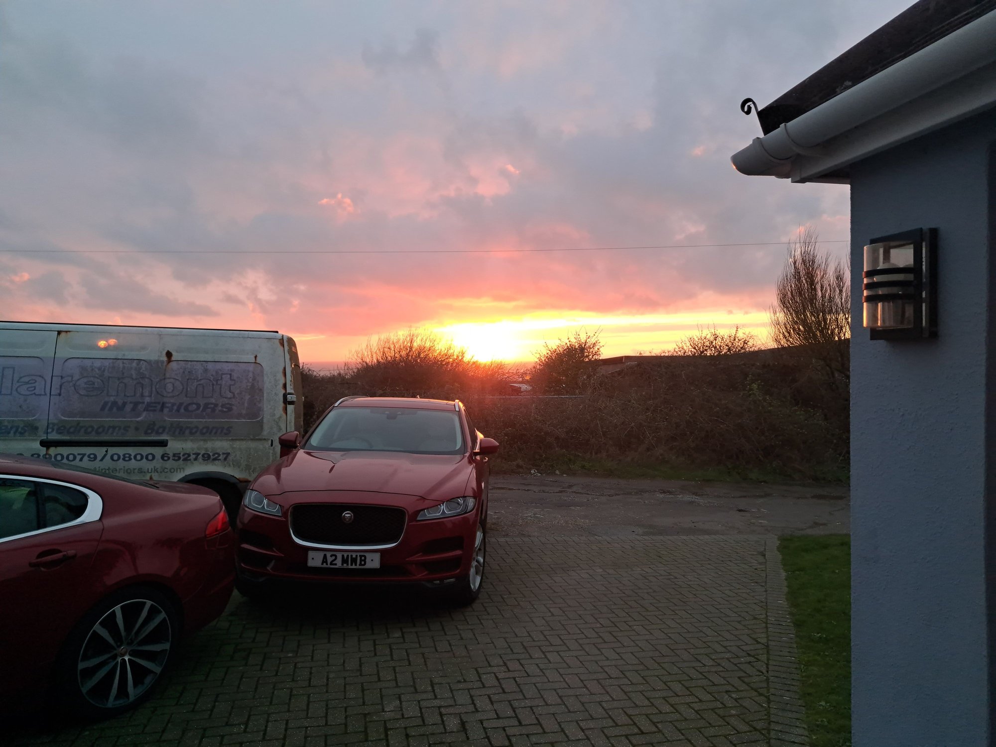

I have the same wheel fitted with winter tyres
next month they will be swapped out for my 20" wheels
shame they dont make those in 20" i really like them
picture last year of my 20" wheel
