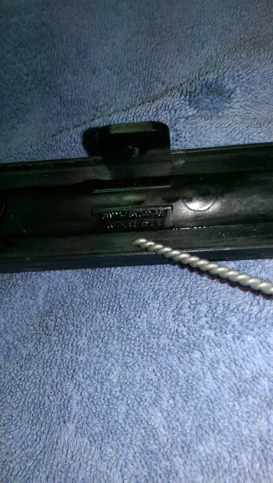

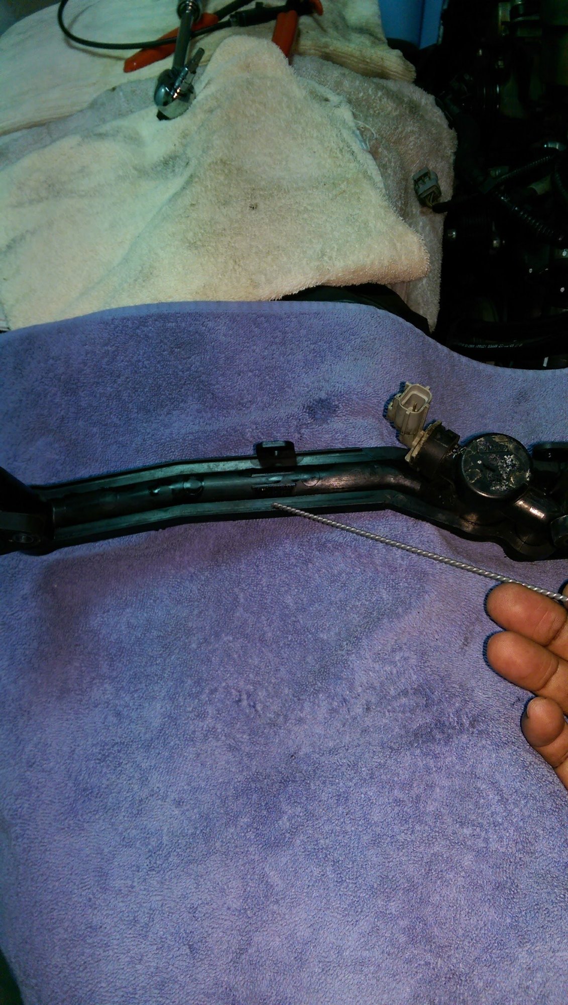

The rear cross over pipe that let go on my XFR a year ago, it's cracked but the only way to know it's cracked was to pressure test the cooling system.
It looks normal.
Until it's under pressure.
