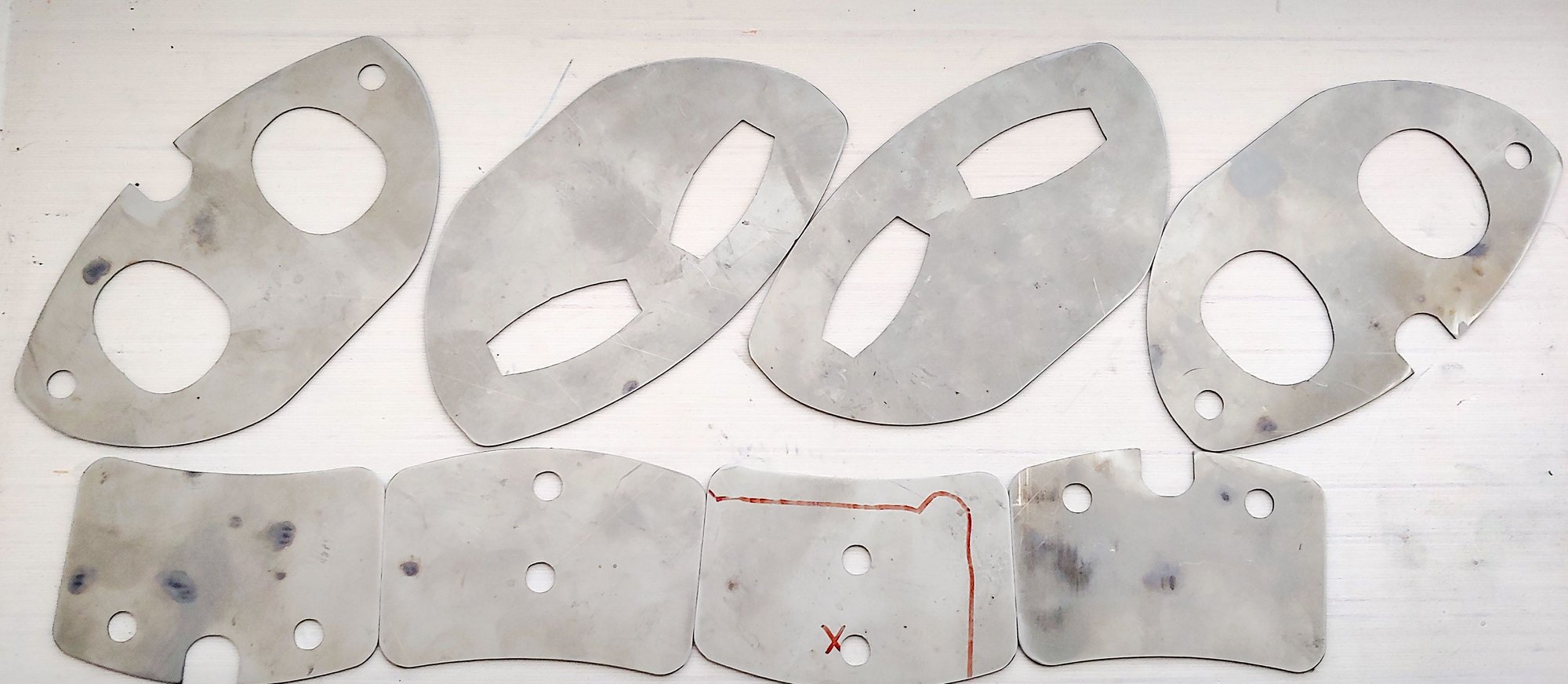

Is there any interest for HPDE track setup with Titanium brake shims for Jaguar R cars? I just designed and made some 6AL4V Shims in .050" for my XFR and wondering maybe some of you would want them too. I can make the standard .020" or Race .050" thick shims. The thicker the more the heat rejection. I can have these also ceramic coated as well for more heat rejection. Ceramic coating does not add any significant thickness. Only a micron or two.

XFR Titaninum Brake Shims .050
XFR Titaninum Brake Shims .050"

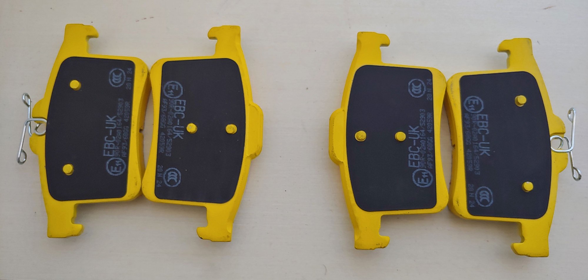

rear Brake Pad Shape

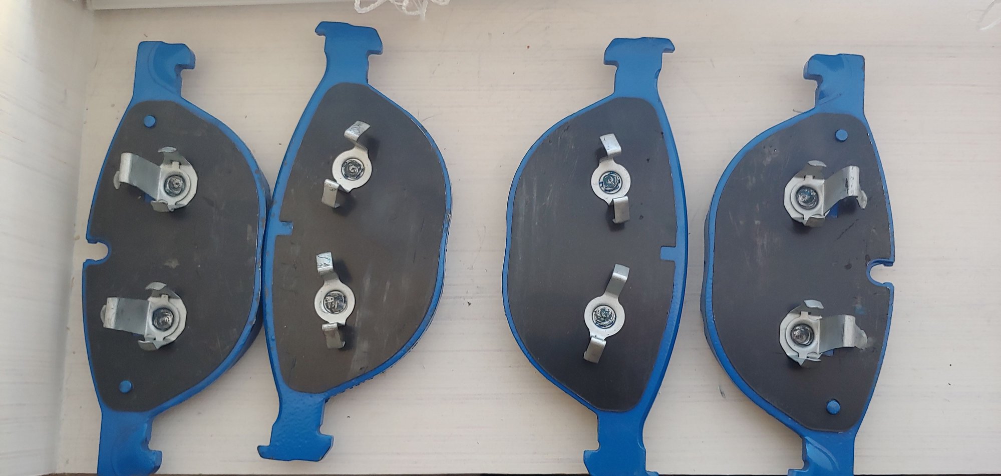

Front Brake Pad Shape

Got these shims installed yesterday with fresh pads and racing fluid. Did a bed in procedure. All working well.
Interesting note the pistons on the factory brakes are steel not aluminum. That is fantastic so no need for Ti. I can just have the factory ones ceramic coated with the Ti shields. I also found out the pad has clips that insert deep inside the pistons, and I don't think that is a good design to have hot metal from the pad baking inside the pistons. I will be replacing this whole setup with something more HPDE worthy next year.
