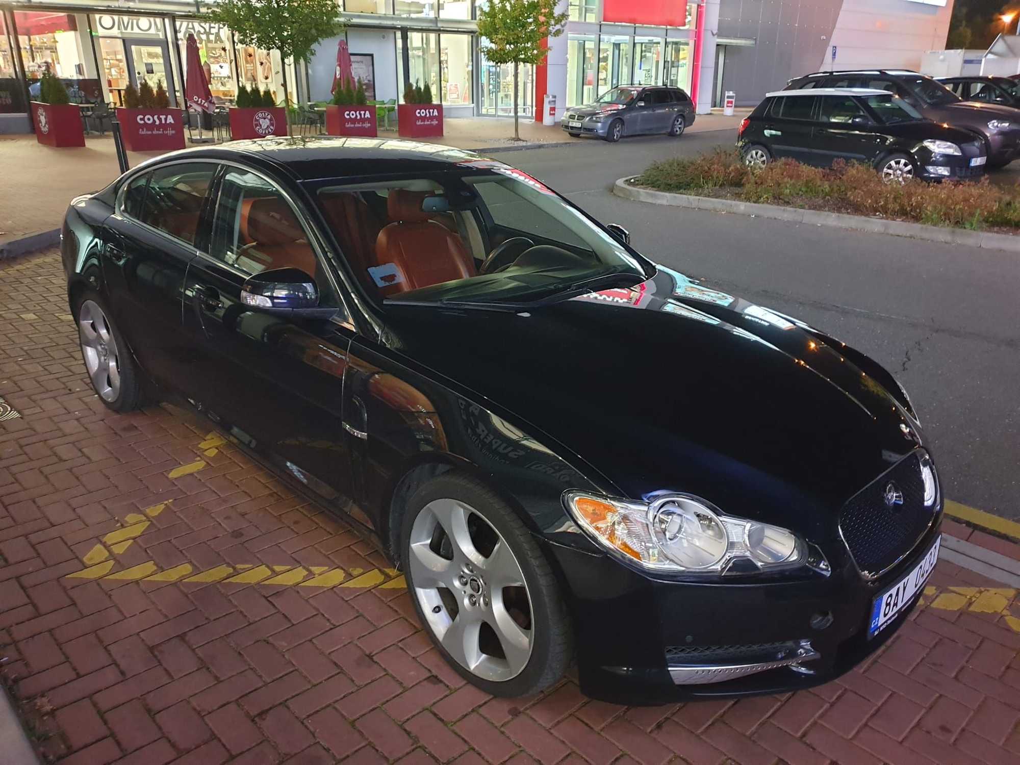

Hi everyone.
Totally new here, fresh account, fresh Jag owner
Just got this 2009 beauty for killer price in Germany. Little hailstone damage, but 130 000km on the clock and basically like new.
