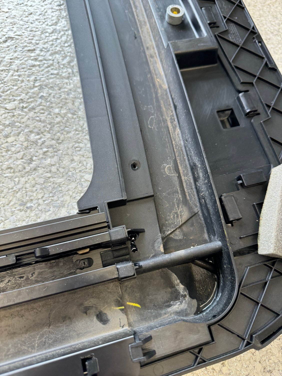

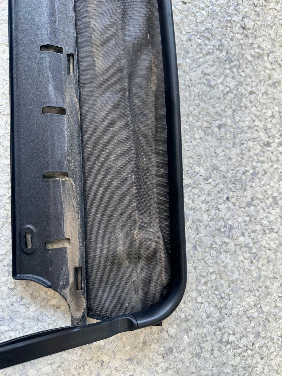

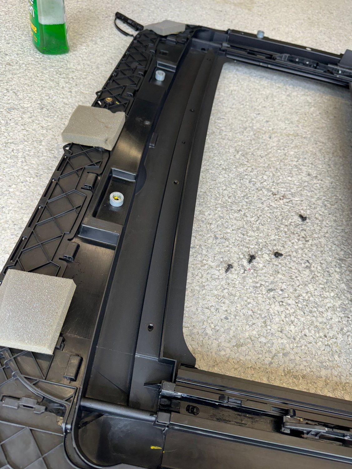

I also solved a slight odor issue I was having after washes/rain. Dry floors, dry rain tray cowl, dry trunk /spare tire well, etc. The car never had any water leaks or wet floors but a musty smell for about 12-24 hours after washing or water. If I avoided the roof during a wash - the smell didnt happen. After dropping the entire headliner, cleaning and testing all the drain tubes, peeling back carpets to confirm no water damage, and testing glass seals - I found it. The wind deflector screen on the sunroof had so much dirt on it, it had generated mildew/mold on it. Since I rarely open the sunroof I never noticed it, but enough water gets past the seal to saturate the area, and it takes some driving / time to air out the area I suppose. I ended up removing the entire sunroof assembly, cleaning the water trays/tubes, and disinfecting & cleaning the screen netting. No more smell. Ordered a new sunroof panel glass rubber seal from Jag and will be re-assembling soon.
So - Lesson learned, use your sunroof more often even if it's to let it air out, especially after water/rain/wash. It's easy to grab a chair or ladder and peak into the recess to verify your front drains are working, and with a flashlight you can see the rear drain tubes as well. Removing the glass only is quite simple of further verification. My seal was very dirty, dry, and slightly warped. Another thing to note - the drain tray is biased towards the front, so most of the time the car will want to drain out towards the front and down the front tubes, which exit behind the front wheels, under the liners. The rears go down the C pillars, through the rear deck, and then to holes just under the rear quarter panel line. Dumping into the rear bumper. There are too many bends to run a wire or pipe cleaner through without removing, so I suggest gravity draining some soapy water down the tracks, and observing at each corner if you ever want to rule out a drain tube leak.
Removing the headliner is no small feat - you have to remove the door seals, driver seat, and all the pillars. Lots of clips and parts, easy to break something but not has bad as other cars I have done a headliner drop on.

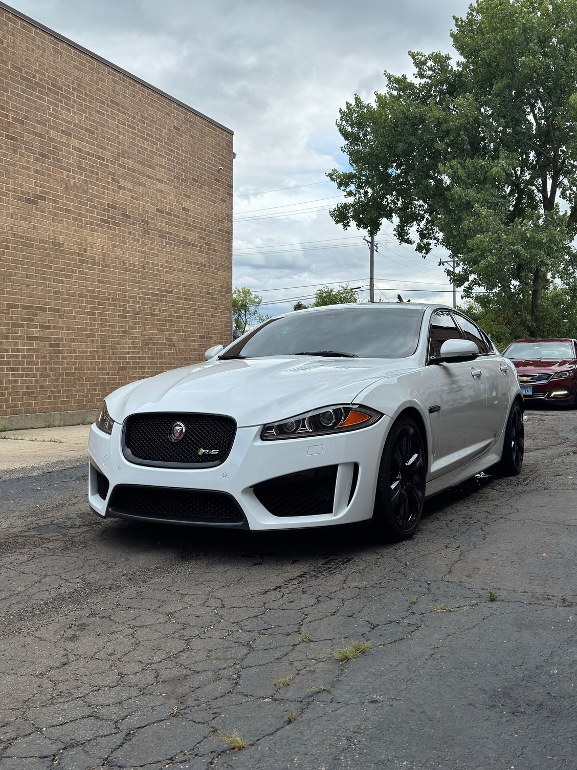

Back in August I did get the car's paint corrected/polished professionally, and had my wheels ceramic coated. There was a local jag show (Illinois Jag Club's Concours show) that I attended, and while mostly older cars and F-Types, I did meet another X250 XF owner there with an NA 5.0. Very few people, even in the Jaguar community, are aware of what the XFR-S is. The amount of people who said "my so-an-so has one of these with the supercharged v8 in it tho!" is kind of surprising. Assuming I didnt have that same motor, in top spec at that. LOL. Having a rare car has its pros and cons I suppose Anyway, here are so pics of that.

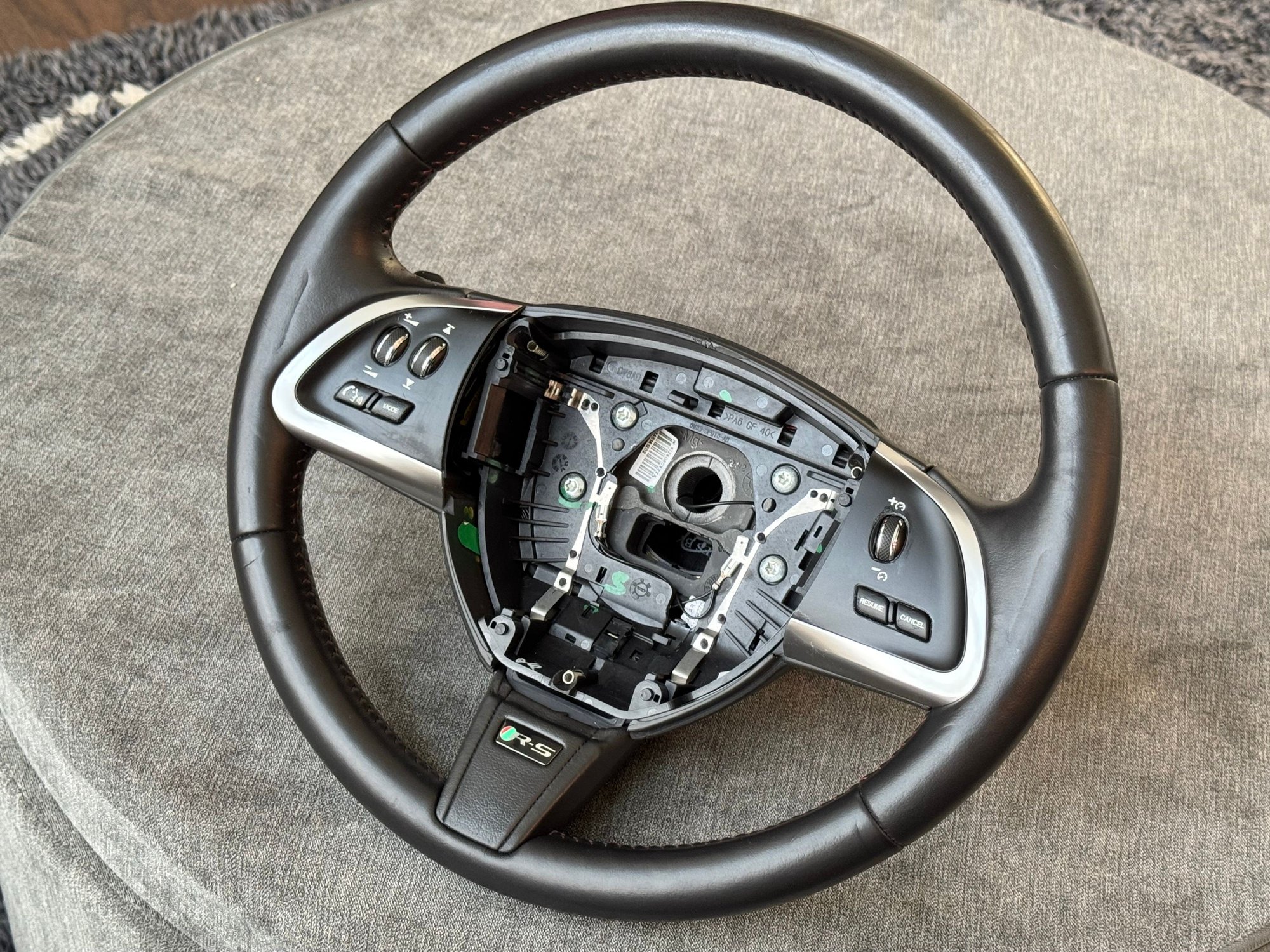

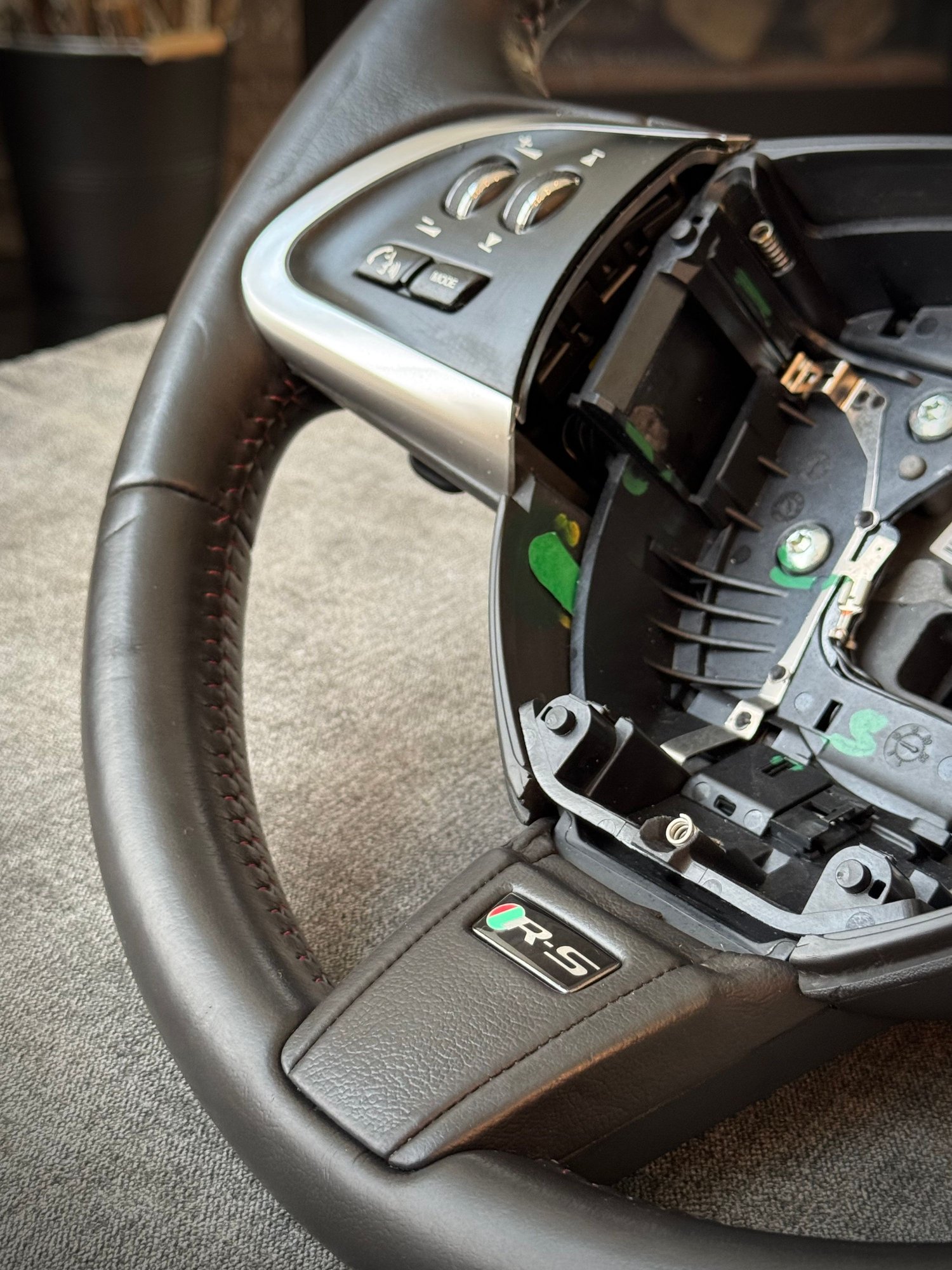

I also have my spare steering wheel (red stitching version) I bought to re-wrap and it won't go with the car. Lmk if any other RS owner wants it for a spare, $250OBO, I think I paid $300 shipped over 3 years ago for it. Oops
