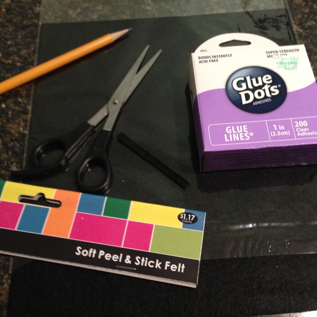

First, you'll need some basic school supplies. (i.e. scissors, felt sheet, glue lines, etc. from your local craft shop) damage: [under $7]

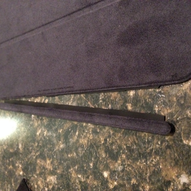

Next, (and this hurts a little) is obtaining an Apple Smart cover (with the MAGNETIC spine!!) and separate the spine from the cover. This spine is great. It has a strong magnet and nice felt wrap. [damage ~$30]

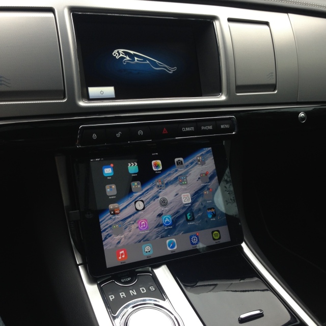

This involved some patience. You must take it slow here. I gently held each side with my index fingers and ever so slowly raised it into position above the cd insert hole. You want it to be centered and level! Once you pick your spot. Press firmly and let it settle for 24 hrs. If done right, it'll look very flush and barely noticeable.

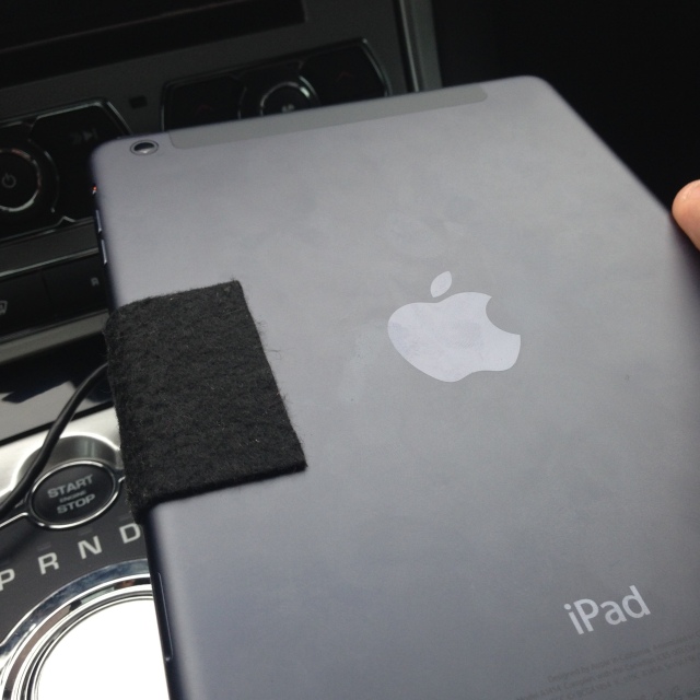

I suggest prepping the bottom the iPad Mini's surface with the felt. This way it doesn't scratch any surface on the console.

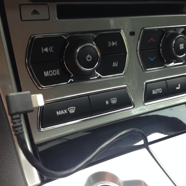

Run a lighting cable through the cup holders/ash tray. Mine is barely noticeable. I picked up this black L-shaped one to give it a slick look when it's plugged in.

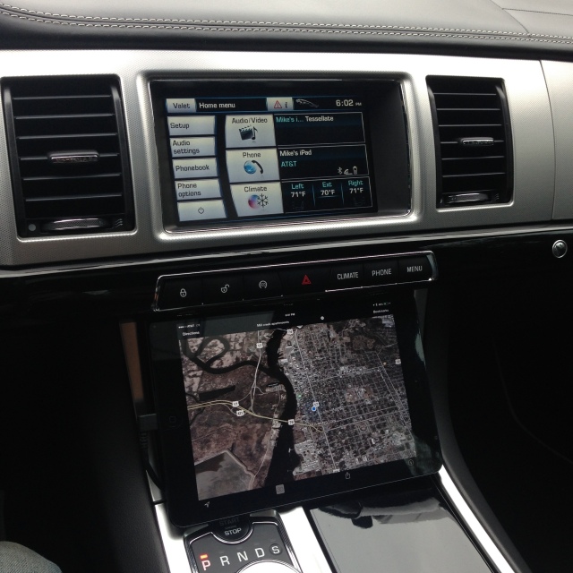

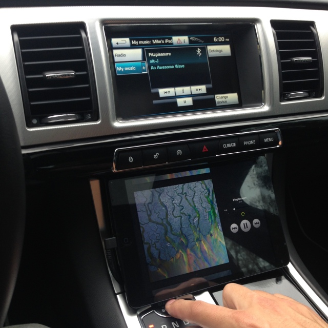

You're done! I absolutely love having this piece of gear below the touch screen. Now you have two and can enjoy many benefits it offers like...

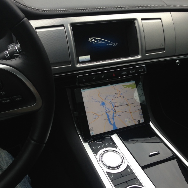

...like Nav (Waze).
...or fancy Nav.
Bluetooth connection to all your media. Very cool
There you have it. There are some drawbacks however. You just have to outweigh them and see what is worth having. What I'm talking about are the functions behind the ipad. Now most functions are controllable through the steering wheel but some like temp control can not. Luckily it's magnetic and the ipad comes on and off very easily. But hey to each their own. Enjoy
