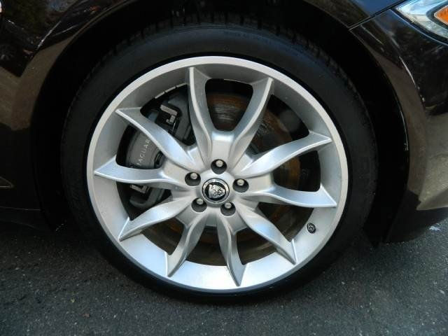

Thanks for the feedback. Not sure that my calipers have existing covers that can be replaced. Here is a file photo of what mine look like:
2013 Jaguar XF 2 0T Wheel 10 Photo #340352 - Automobile Magazine
They appear as unfinished steal. May I ask what caliper covers you're referencing and where I might purchase a set?

Yes, the little brake pad covers (rectangular piece) can can be replaced. It's quite easy, once you remove the wheels, should take no more than 2 minutes each. Just have to be careful getting them off and putting them back on as they are spring loaded. See in the picture.
You can get them at any Jaguar dealer on even online. I can't imagine them being too expensive.
This is what your looks like.....
This is what the one that says JAGUAR on it looks like....
Attached Thumbnails Jaguar wheel offset-edobernig-107535-albums-xf-sc-brakes-6097-picture-front-caliper-16016.jpg   Jaguar wheel offset-07.jpg   Jaguar wheel offset-jaguar-f-type_v8_s_2014_800x600_wallpaper_ca.jpg
