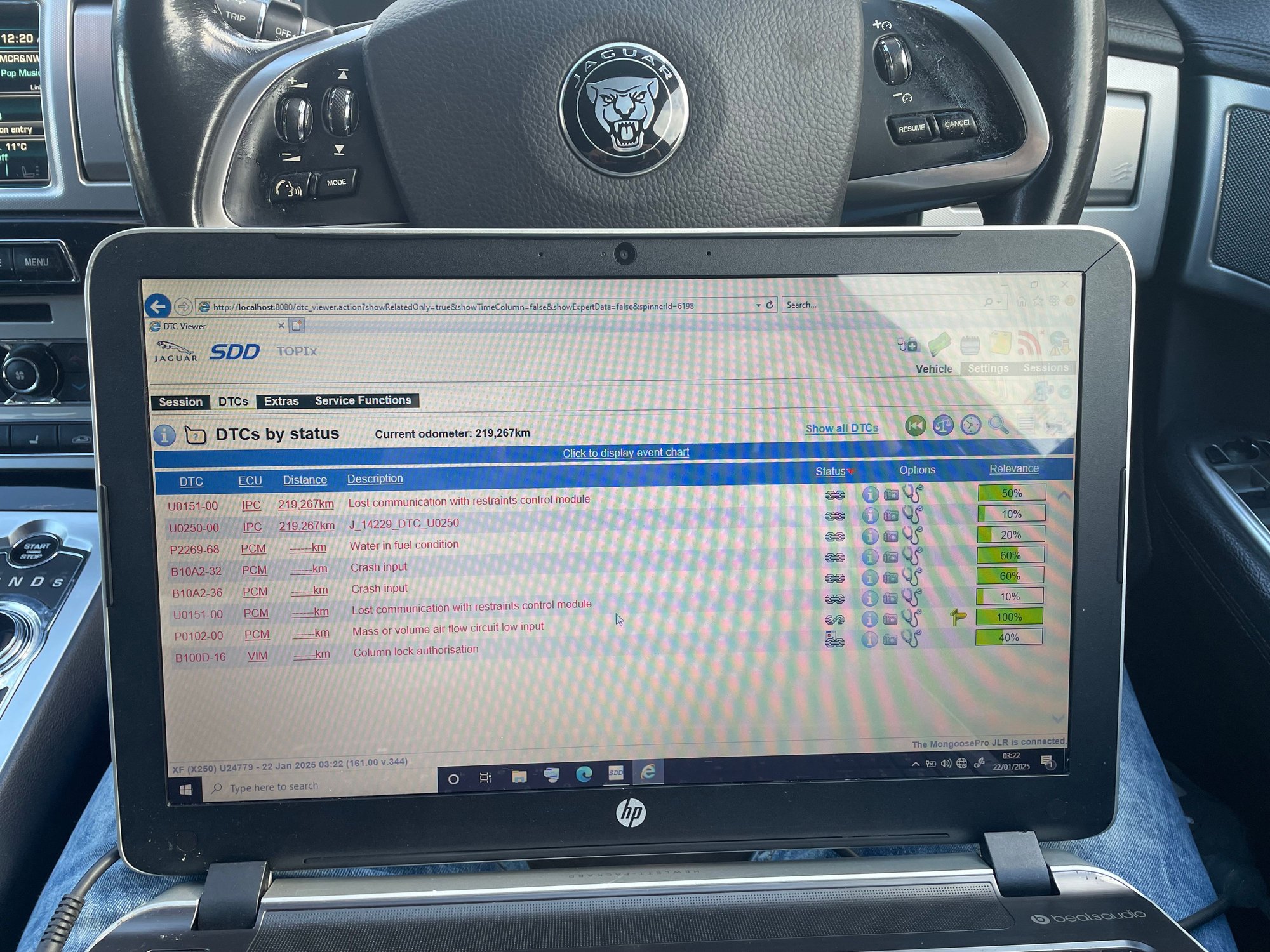

the car starts up for about 3/4mins then cuts off soon as the airbag light comes on then don’t start back cause it says check pedestrian system

One big red flag is your battery symbol is yellow. Number one rule of SDD.
ALWAYS use a DC power supply and NOT a battery charger! What are you using if anything?
Always keep the laptop on AC power.
Next note that SDD is bugging you to update. If you let this go SDD will start disabling functions in SDD. It looks like yours has already started that.
I would work on getting a properly setup SDD first.

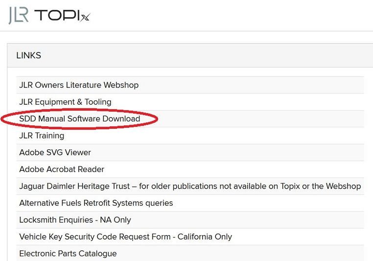

I did just recently find from JLR the latest V166.xxx of SDD if your looking for a copy?
Requires no log in or sign in but it's big at around 3.3 GB. I just checked it and it downloaded fine.
Here is where to go;
Download SDD From JLR
Then go to the red circle.
The download will start automatically and it was very fast too!

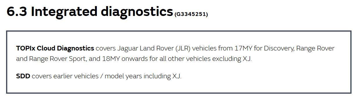

Depends if your car is covered by SDD or Pathfinder?
If you read the links I posted above that information is in there? SDD will require lot's of study on your part so get to reading!
Here is a small bit that might help.
Pathfinder is the one that requires an Internet connection to work and while I do have a working Pathfinder without being logged into Topix it won't work (Yet? Maybe some kind of crack is out there?) They are calling Pathfinder Topix Cloud Diagnostics.
