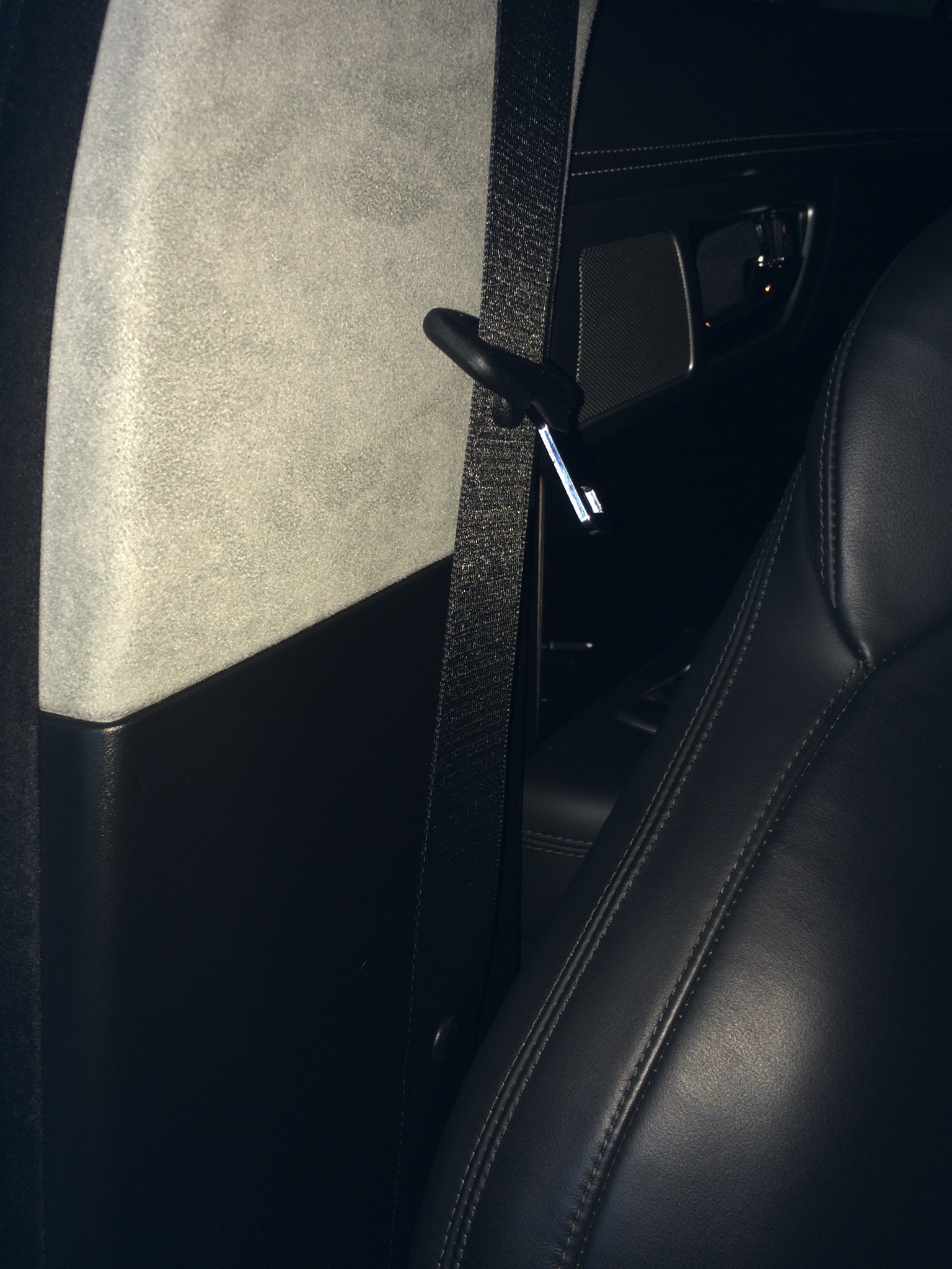

Autozone (and I am sure all other auto part stores) carry in stock the Dorman "help" seatbelt stop (part number 74357) in black for about $7.00 USD for a pair.
They click into place so you do not need to melt the pin tight.
Here is a pic of mine. You really only need to do the passenger side since the driver is always on when driving.
Attached Thumbnails Jaguar XF (2014) - Front Passenger Side (Left Hand Side) Rattle-image.jpeg
