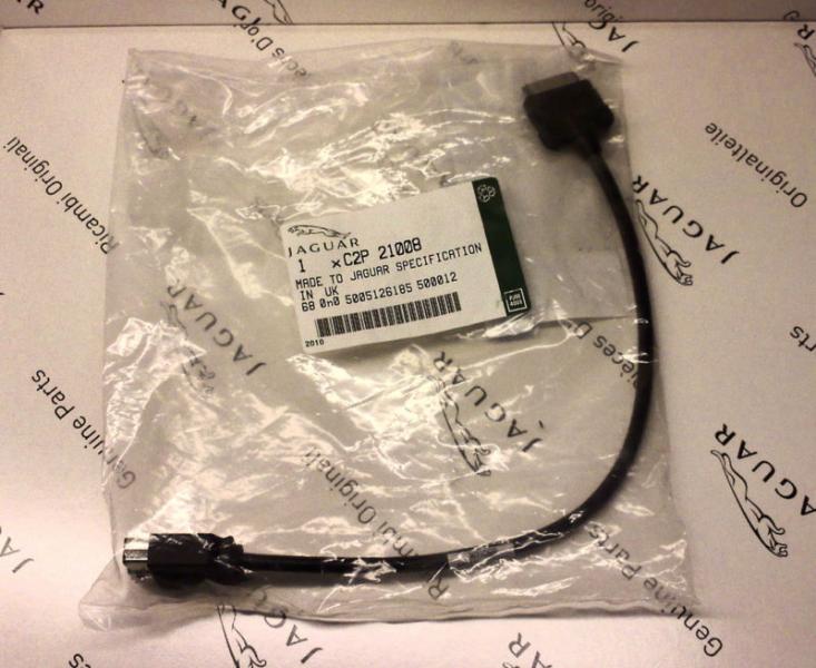

The module you're talking about is the AUDIO PORTABLE MODULE
Here are the picture of the module with code on it and cable for iPhone/ipad connection
Attached Thumbnails Jaguar XF display screen flickering / flashing-audio-portable-module.jpg   Jaguar XF display screen flickering / flashing-jaguar-connector-1.jpg

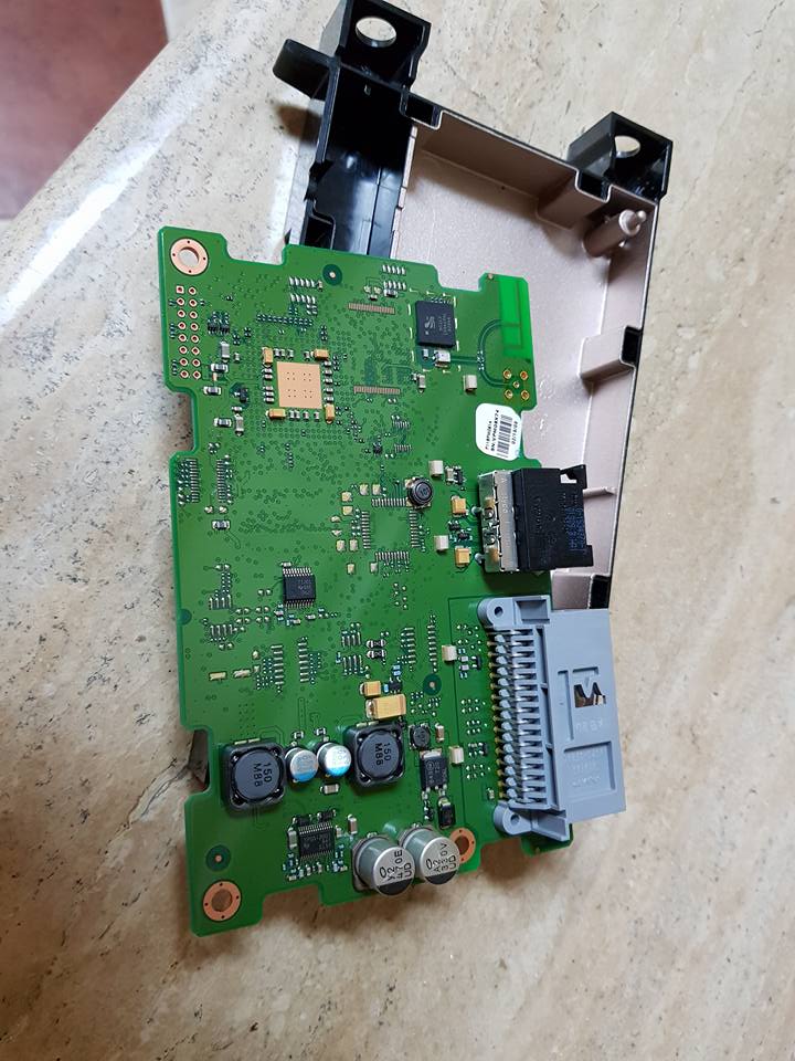

I'm reviving this thread in hope someone can help. I have had the same flickering screen due to flooding of the driver side floor pan. I have purchased a used Bluetooth module but it did not work.
My question is if the bottom box needs to be changed as well. They are interconnected and it seems work together. The board on my blue tooth module looks OK but is was wet so I guess its history. The bottom metal box however looks in dire condition.
Thanks for any input.
The fist time I only changed the bluethoot module and it blew and couple mounth late .. I changed both box and no problem since ... I sugest you change both but it's expensive so check on ebay first ! And check all other component under and around the flooded zone because it might have been touched too! And when you reinstall the module I sugest you let some space in between the box module and the floor otherwise water will always touch it !
Old May 8, 2017 | 12:08 PM
  #38
Rique's Avatar
Joined: Sep 2009
Posts: 316
Likes: 19
I got a used Bluetooth box and changed it and no results. I will get the second box as well and try with both.
