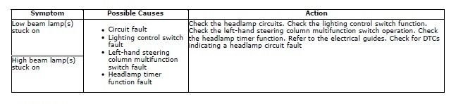

Old Nov 11, 2019 | 09:59 AM
The Workshop Manual has plenty about troubleshooting lamps OFF but isn't very helpful for lamps ON!
