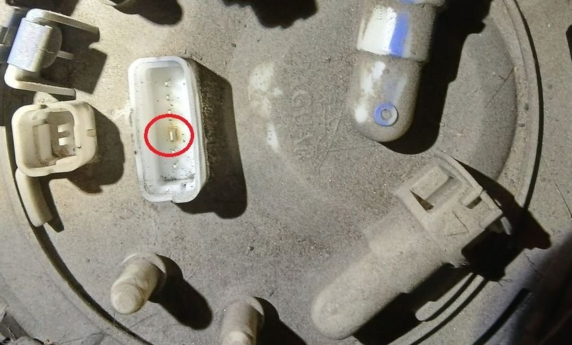

Did some research and got as far as removing the rear seat, cut the circular cut out piece and got to the top of the fuel pump...
Doesn't look horrible, but regardless grabbed some steel wool and cleaned up the connectors prongs. Then inserted plug in and out a bunch of times hoping this might fix 'a dirty connection '.

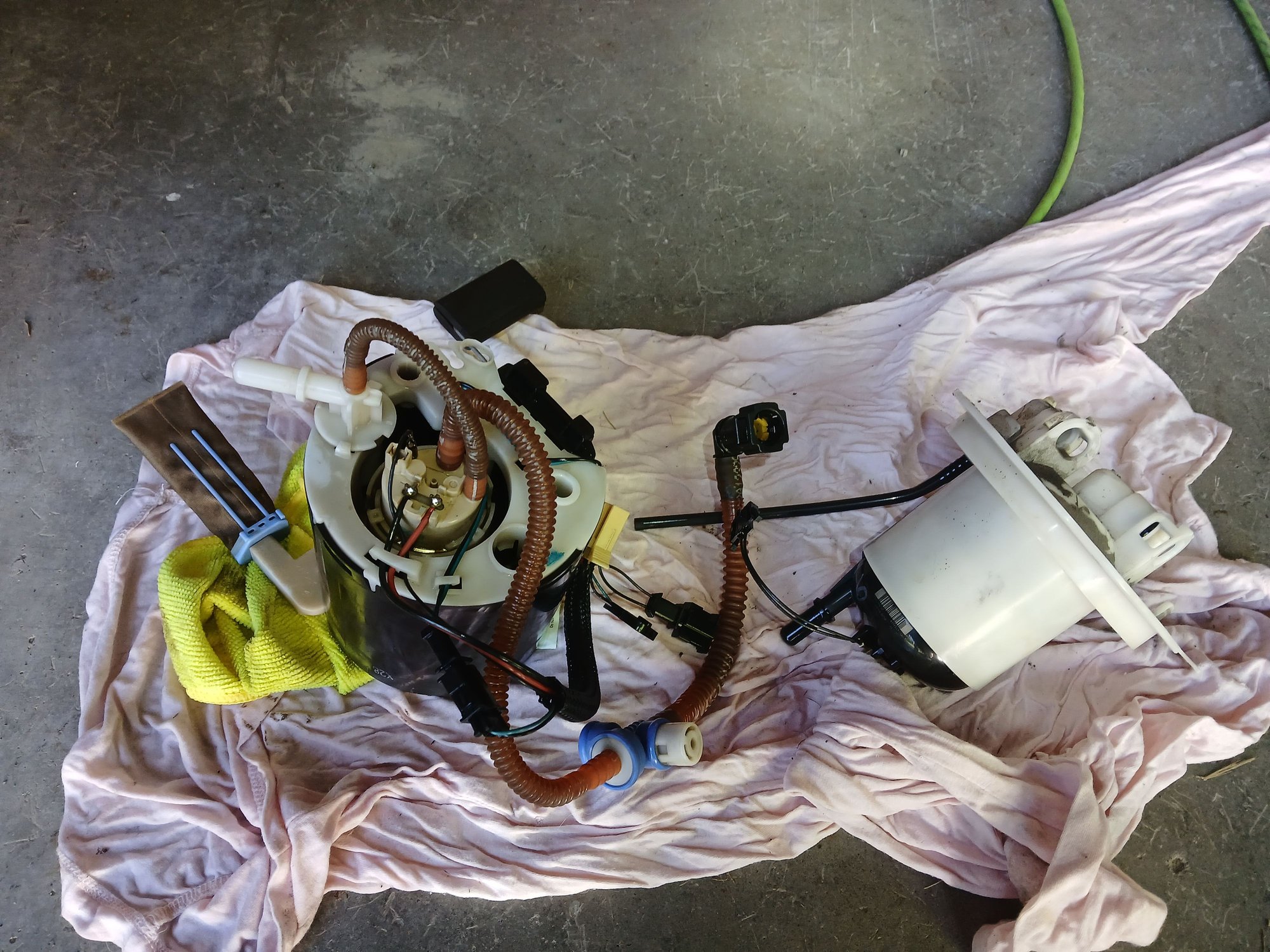

So decided to pull the pump/module etc.

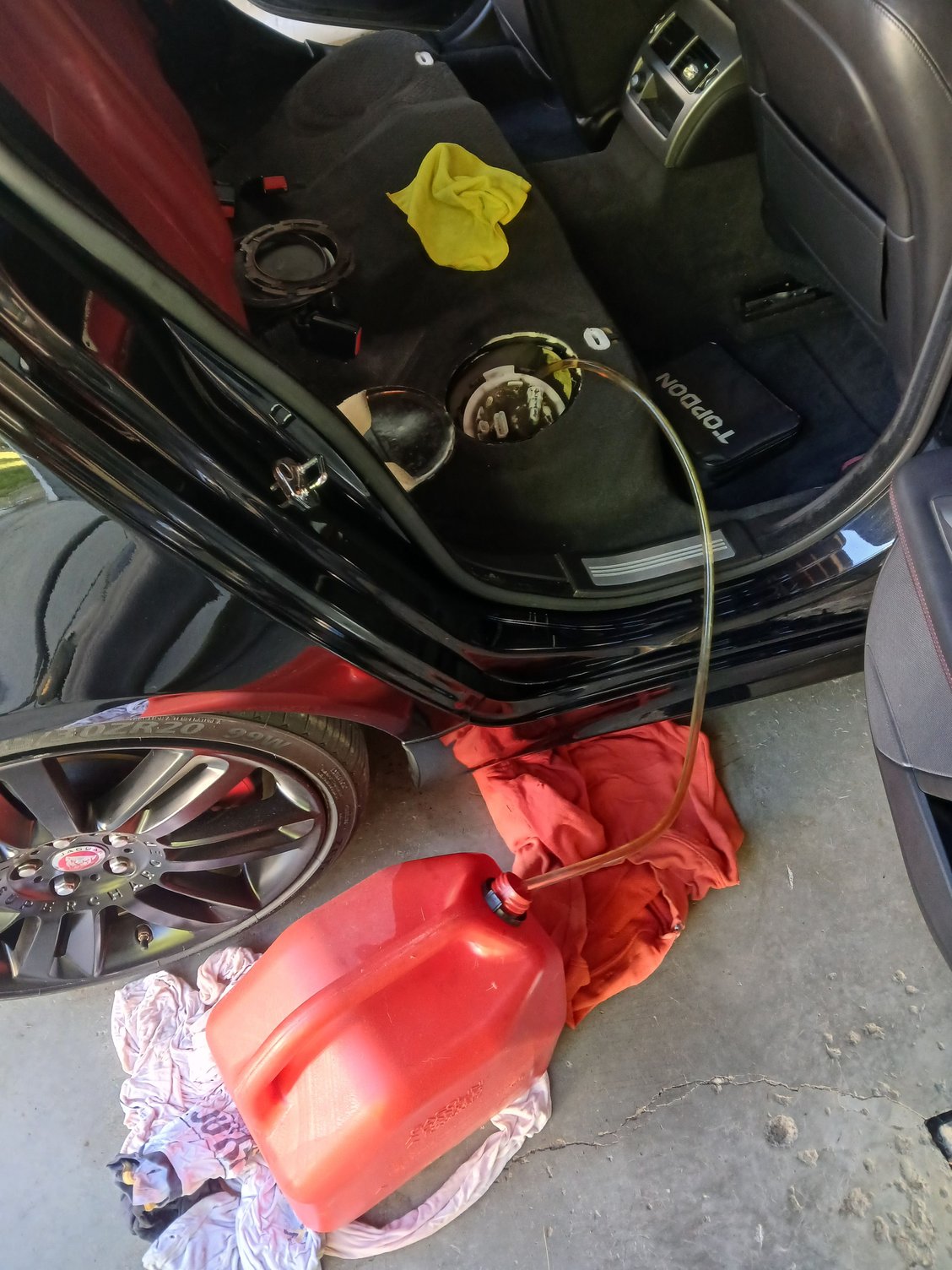

Of course I had to fill it to the brim yesterday so it started pouring fuel all under the car, I ran, grabbed some rags and start siphoning about 23 liters.

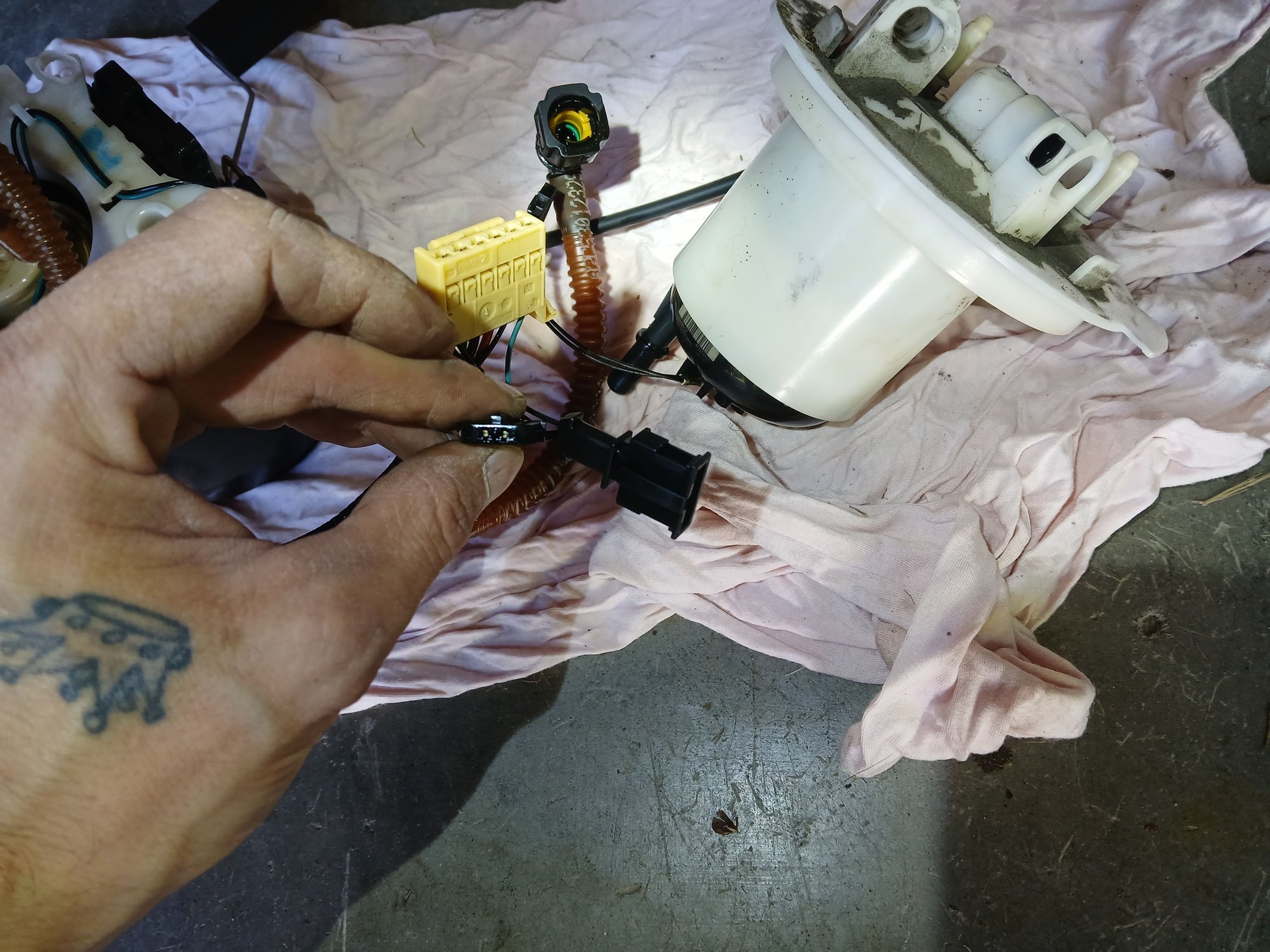

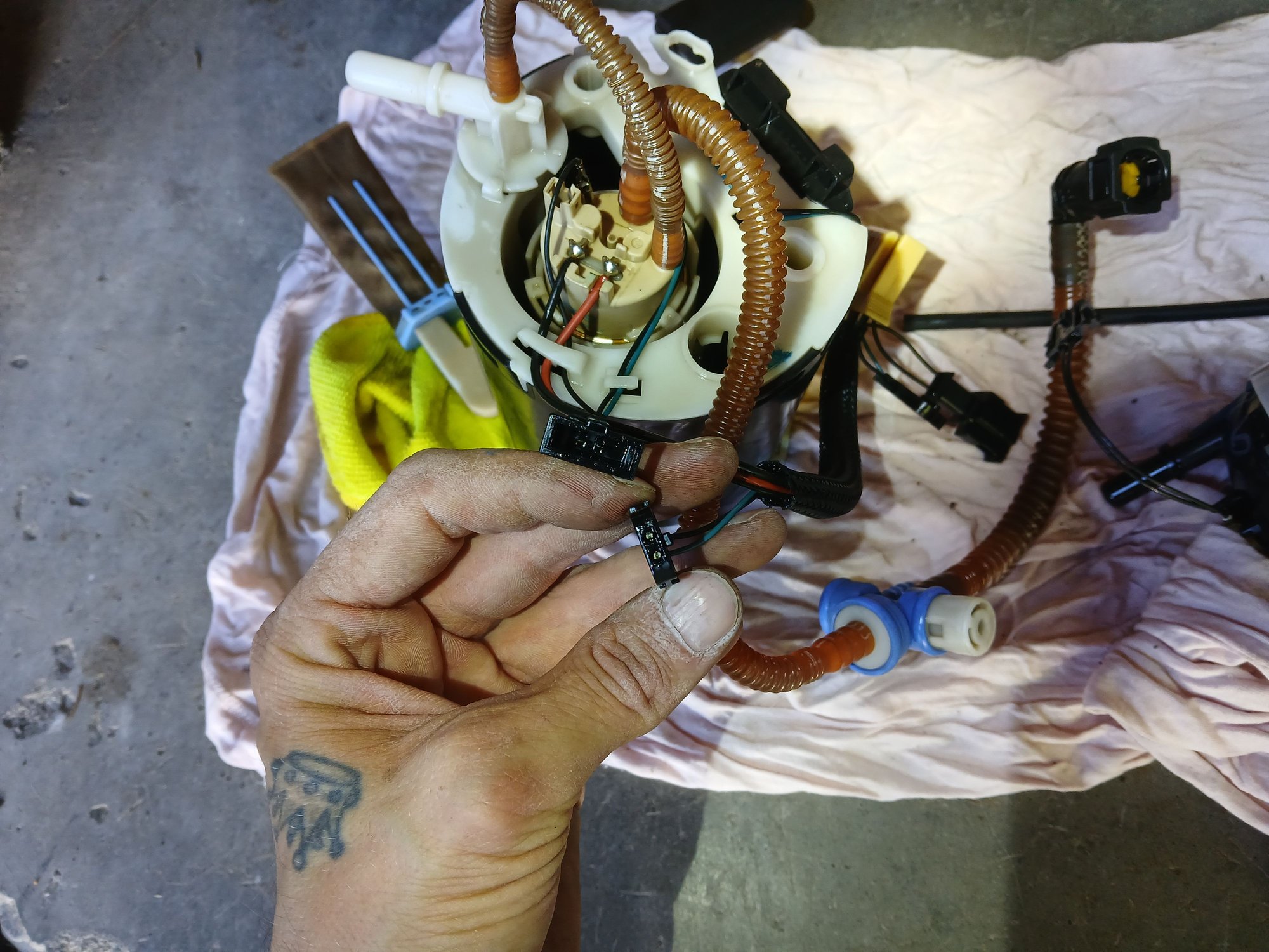

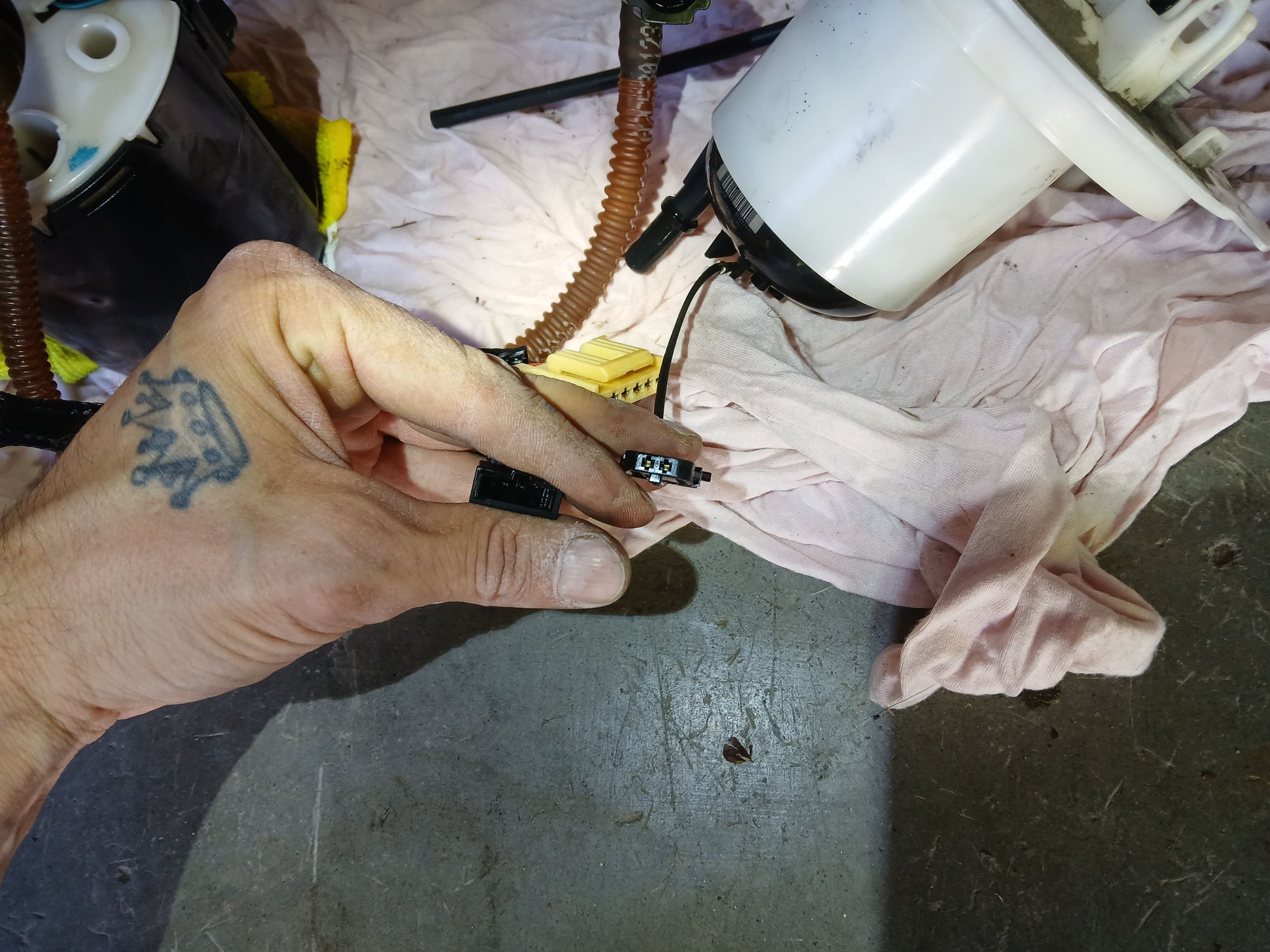

Pulled the pump, checked all connections fiddled with plugs bunch of times, ran a earth magnet up and down by fuel sender pivot, cleaned the fuel filter and re-installed it.
started the car for a minute to make sure everything is running alright before installing everything.
Tank showed just over half which makes sense after me draining a bunch. No light came on but time will tell- gonna have to take it for a test run... if still not fixed, I'll probably replace the whole unit with an OEM one.

Glad you got it fixed but you have some light burn marks on the pins?
Hopefully yours won't get worse but I have seen major black marks and melted plastic in that plug before.
With the age and miles on the car you "might" have to replace the fuel pump assembly if it gets worse.
