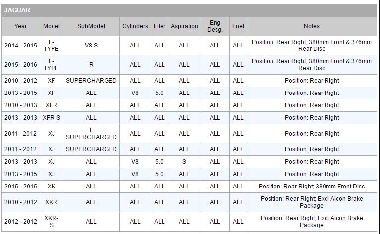

It's not an XFR-S, but I just ordered rotors and pads for all four corners of my '11 XFR. Until this past July, all of my service had been included, so this is the first time I've had to think about which brakes I'd want. I was leaning toward R1 Concepts' Premier slotted rotors with EBC Red Stuff pads, and R1 Concepts generously offered 15% off of my total order, which would've put me at around $1,100+.
But, while talking to R1, the rep mentioned that the R1 Premier rotors are basically identical to StopTech's Sport Slotted rotors (or whatever they're called these days - they've apparently changed names over the years); they both use the same Centric blanks, with the only difference being something like R1's slots are diamond-edged and StopTech's are round-edged. Whatever.
Anyway, long-story longer, AutoAnything was offering 30% off of the StopTech Sport Slotted rotors and 20% off of the EBC Red Stuff pads, with no tax and free shipping. R1's normal price for the EBC pads was higher to begin with, and their discount wasn't as good across the board, so I ended up going with AutoAnything for the StopTech Sport Slotted rotors and EBC Red Stuff pads, and saving over $200. My grand total was $893.77. I'm sure there are some similar or better deals out there; I actually found the EBC Red Stuff pads for less on a few different websites, but didn't feel like dealing with two separate transactions, etc.
I haven't received them yet, but I'll provide some feedback whenever I get them mounted (which I'll do myself).
Attached Thumbnails Jaguar XFR-S Break Pads and Rotors-autoanything-receipt.jpg   Jaguar XFR-S Break Pads and Rotors-brake-fitment-front.jpg   Jaguar XFR-S Break Pads and Rotors-brake-fitment-rear.jpg
