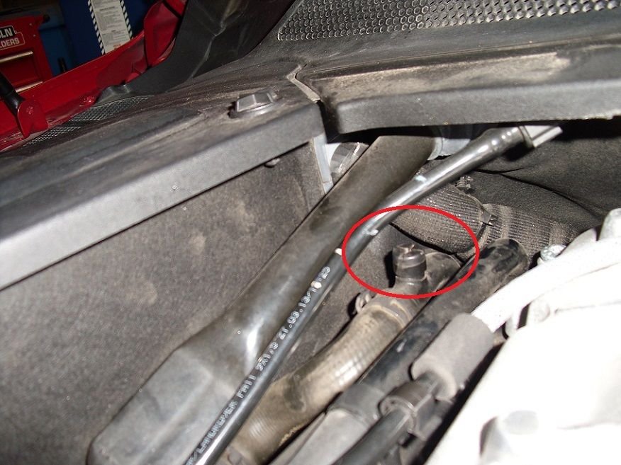

How did you fill the coolant? In the past I have just driven the car while checking the coolant level. Topping up as needed as the heat and cool cycles work the air bubbles out of the system. In a couple of days it's usually all bled out.
Did you open the air bleed port?

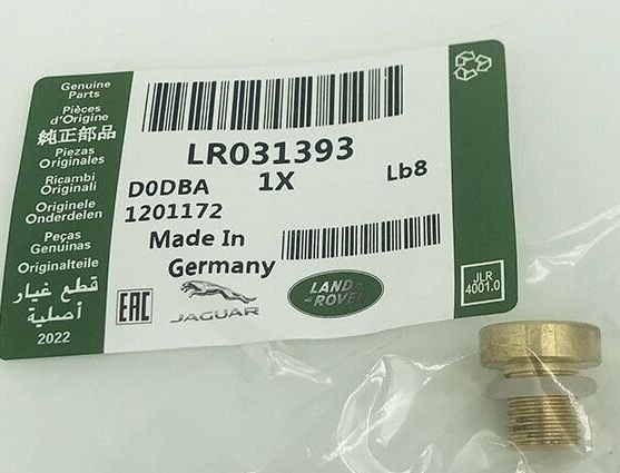

This is again another plastic cooling part that you can replace with metal. Here is the factory part as JLR has went back and released a number of coolant parts in metal instead of plastic.
Many of these out there as this same plug is used by multiple car manufacturer's. Ton's of BMW's have the exact same screw. So a lot of after market versions if you don't want to buy from JLR.
