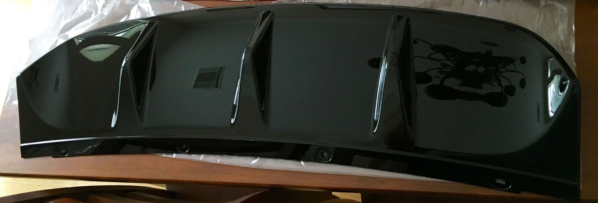

OK, decided my 2010 XFR would look nice(r) with the rear diffuser upgrade and Mina say they are reworking their design, so I decided to look at the YouTube version where the 2012 Jag parts are fitted to the 2010 by adding new slots in the rear bumper.
Was pleasantly surprised to find on parts.com that the lower valence and the insert came out at around $280 with shipping. I was concerned they might be OEM pattern but got a call from Jaguar San Juan parts manager to allay my fears - apparently they service the orders for Jaguar and Land Rover on that site. So three days after the order, Fedex showed up with my parts and they are totally kosher :-)
The diffuser insert is ready to fit glossy black.

Both parts are genuine Jaguar parts. The lower valence on the 2012 model is two part as opposed to single part on my 2010. The insert part (the actual diffuser) is ready to fit no paint needed....I guess that is why it's twice the cost of the bigger part. As to direct bolt on, well, it is once you add some "missing" slots. Jaguar changed the location in the later model year - here's the YouTube link:

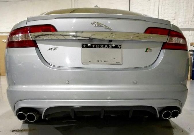

And here it is completed - not quite as easy as the YouTube video would have you believe as my shop wasn't happy with the solidity of the fit so they took the bumper off to make sure the fingers were firmly located in the new and existing slots. A little extra work but less embarrassing than losing it down the road....and at the end of the day genuine Jaguar parts...
