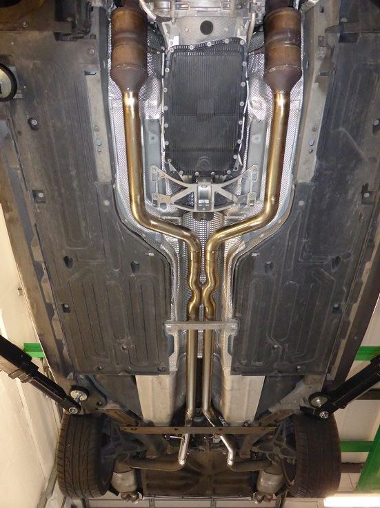

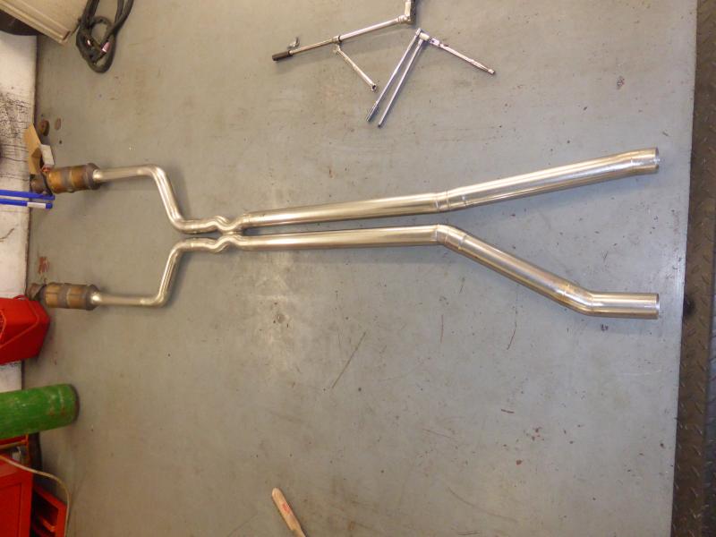

Default My XFR Exhaust - Modified
[/URL]
More info to follow.....

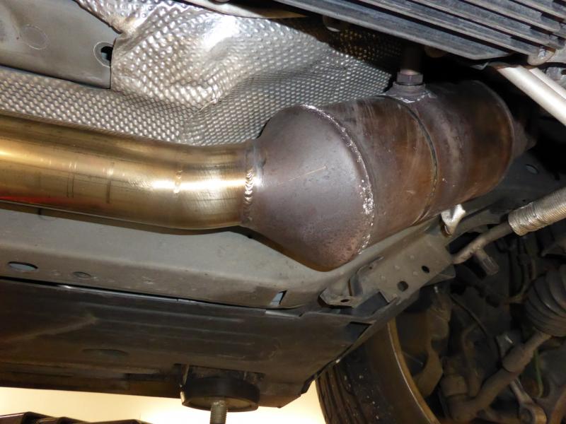

Hi, The secondary cats have been removed from the housing, the centre silencer has been removed and replaced with a proper X pipe and the rear silencers have had the passive valves removed.
I have video footage and db readings of before and after, just got to get round to editing it and uploading to youtube.
It is 2.5" all the way through now, the stock system internal diameter ranged from 2.1" to 2.4" at different points along it's length.

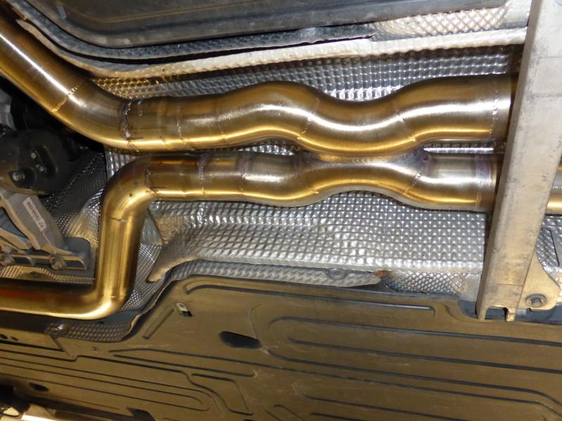

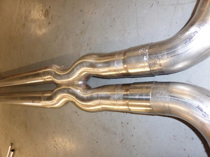

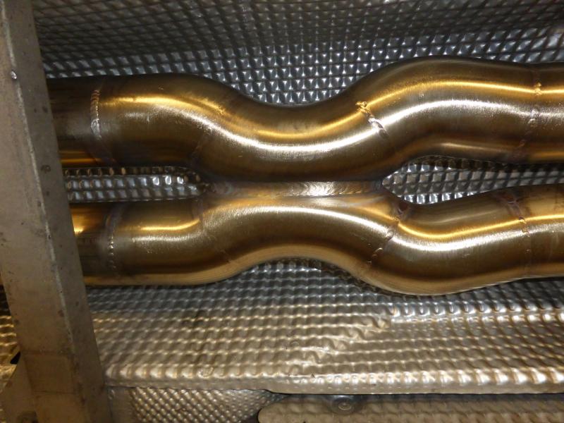

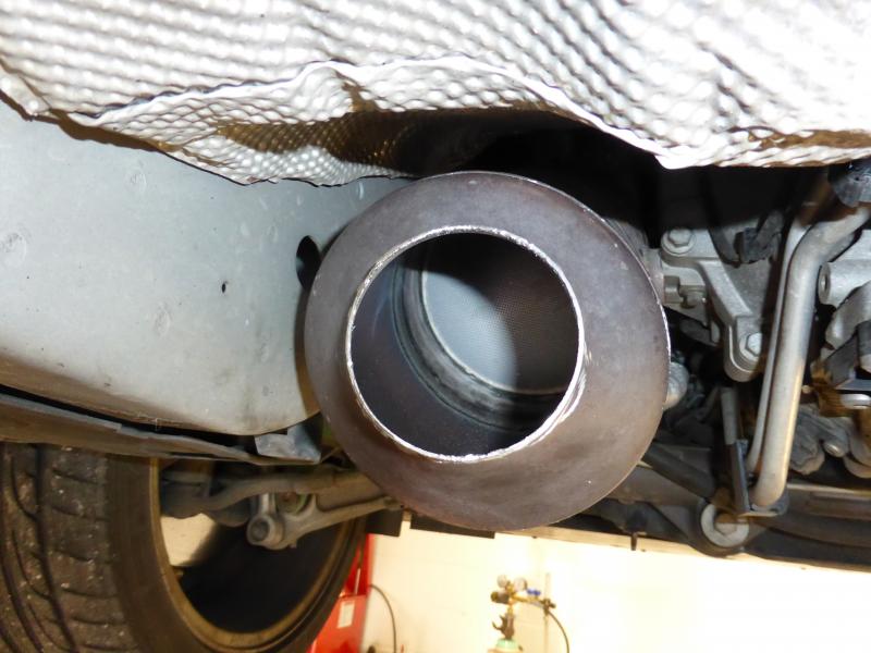

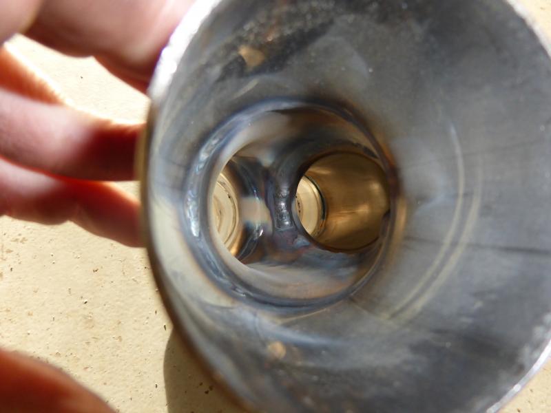

Here's some pictures of the exhaust build -
When I finally figure out how to edit videos properly I'll add the sound meter video
Attached Thumbnails My XFR Exhaust - Modified-p1010048_zps606c9b7b.jpg   My XFR Exhaust - Modified-p1010050_zps1a6e0181.jpg   My XFR Exhaust - Modified-p1010051_zpsf19ecb42.jpg   My XFR Exhaust - Modified-p1010053_zps324c244b.jpg   My XFR Exhaust - Modified-p1010055_zps55170d10.jpg

Attached Thumbnails My XFR Exhaust - Modified-p1010078_zps400e47f7.jpg   My XFR Exhaust - Modified-p1010079_zps3708c950.jpg

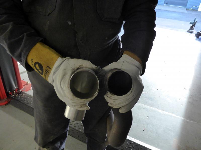

That sounds like exactly what I'm wanting out of the exhaust! I am going to attempt to duplicate every thing you did with it, I wish you had it done in Texas so I could go to the same place for the work!
How did you remove the passive valves in the rear can?
What is the guy holding in the 2nd picture? Sorry, I have zero experience with exhaust - only engines.

The passive valves were removed by grinding the external part of the valve away to expose what's on the inside. It's easy to see what's in there and all the parts that were removed are pictured here. Its a lot more simple than it may sound.
My welder is holding the std slip joint from cats to centre section, this measured 1.9" at its narrowest part!
The system is now a true 2.5" system from front to rear. That's the other pipe he's holding just for comparison.
