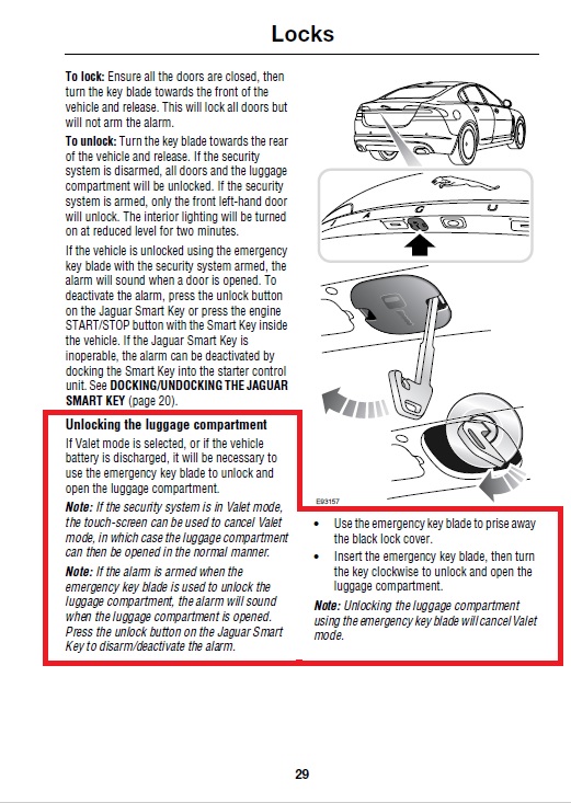

Members with this model will know better than I do but just to eliminate settings before considering possible faults - is the vehicle in Valet Mode? This is from the XF Owner's Handbook:
I only ask the question because Valet Mode disables the lock button on the rear hatch of my XK and Jaguar tend to copy design features across a number of models.
