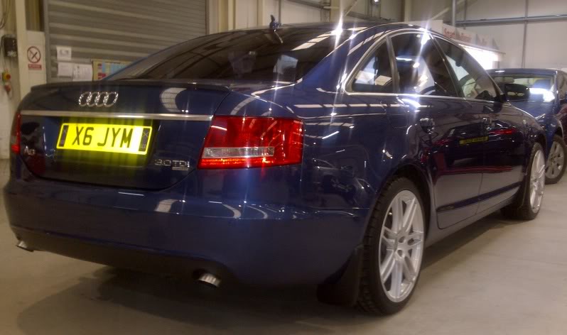

Old Jan 4, 2015 | 07:06 PM
IMO true on all of the above.
Best advice I can offer, is to get the tips as clean as can be, inside n out to start with.
Presumably washing your car regularly, include the tips on every wash giving them plenty of attention
See below the tips on my Audi A6 at around 7 years old and 114k miles, they look good as new.
Being a diesel it suffers probably at least, if not more so from heavy soot deposits under acceleration.
Hope it helps..
Best
