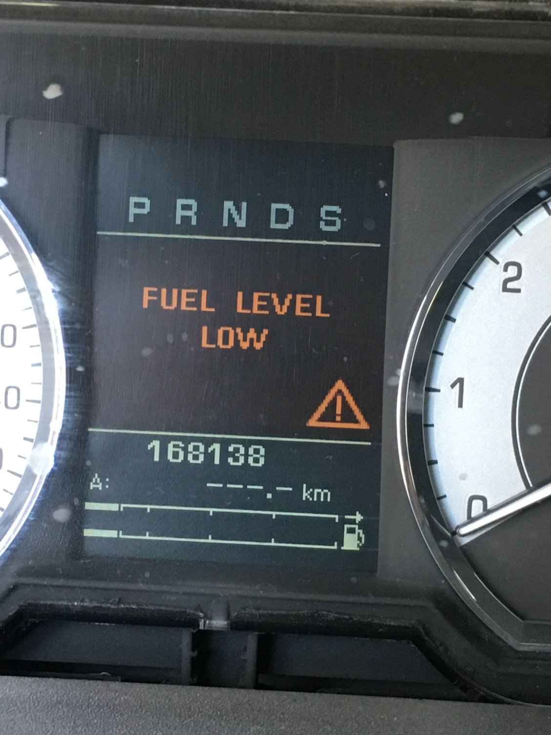

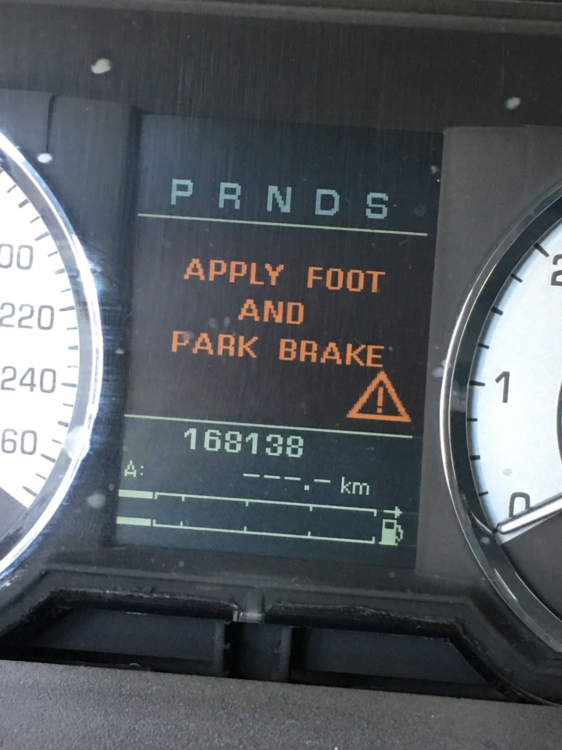

I used a battery tester. It says the battery is fine. And after further research it appears you won’t be able to find the inertia switch as unlike other cars it’s not fitted anywhere else but is part of the restraint system. I’ll reoeat the issue. The car won’t start. It’s besn hit from behind very lightly and after that it won’t start. I even checked the brake switch there’s nothing wrong with that. Any ideas what I should move on to checking next? Please help.

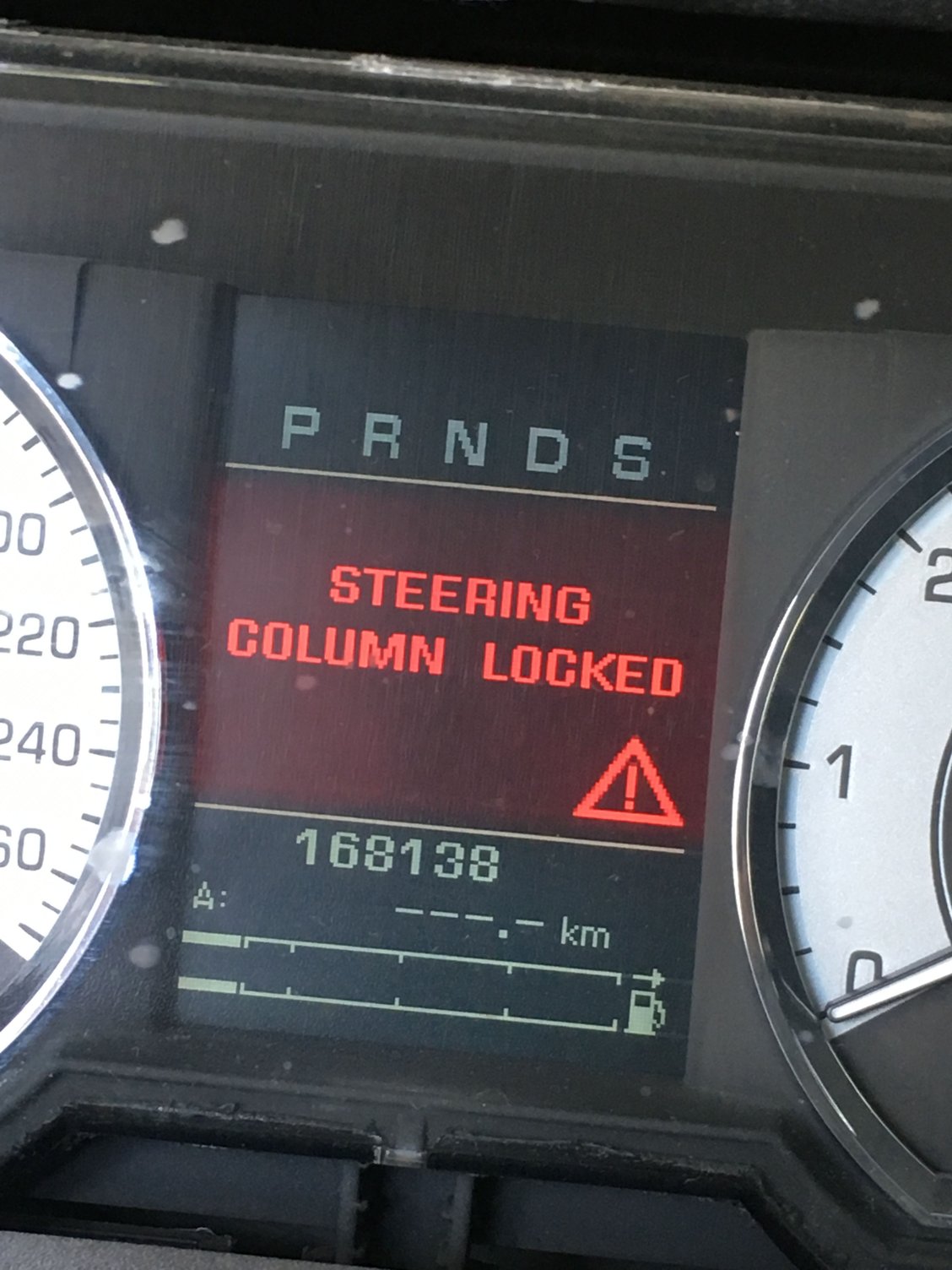

Update - now the key won’t come out as well.
Old Oct 24, 2017 | 01:54 AM
Ebaadremix's Avatar
Joined: Oct 2017
Posts: 8
Default What do you all make of these obd codes and warning lights? Why it won’t taje a self?
