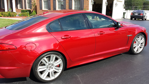

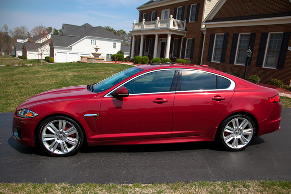

I have Nevis and would be more than willing to sell once I do the swap.
Attached Thumbnails New Wheels & TPMS-p1530826256-3.jpg   New Wheels & TPMS-p2145206629-3.jpg
