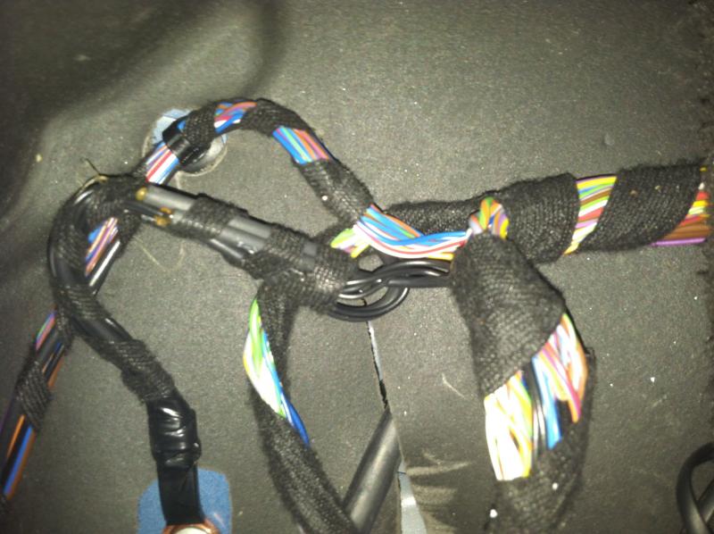

So I'm in the process of hard wiring my V1. I'm placing it right where the dash meets the front windshield, already have that done. I have the wire run to the area in the drivers side footwell and I'm looking for a 12v wire that turns on with the ignition. This is a horrible picture but does anyone know of any of these wires that I can hop onto? I have the V1 kit that makes it super easy to just clamp onto one. I have found a ground point in there so I'm all good on that one. Thanks guys.

I would tap into the Power outlet( Cigar Lighter) fuse in the passenger kick panel so it goes on and off with the ignition.
I would not tap into any of those wires in your pic at all.

I agree with BigCat. Do not cut into those wires, find a terminal, otherwise you are opening yourself up to a world of hurt. Unless, of course, you are an electronics expert, then you can disregard any and all of our sage advice.

Trust me, very simple to tap that fuse I mentioned and your wires are already run over ther to. This is where my V1 Radar is wired to.
