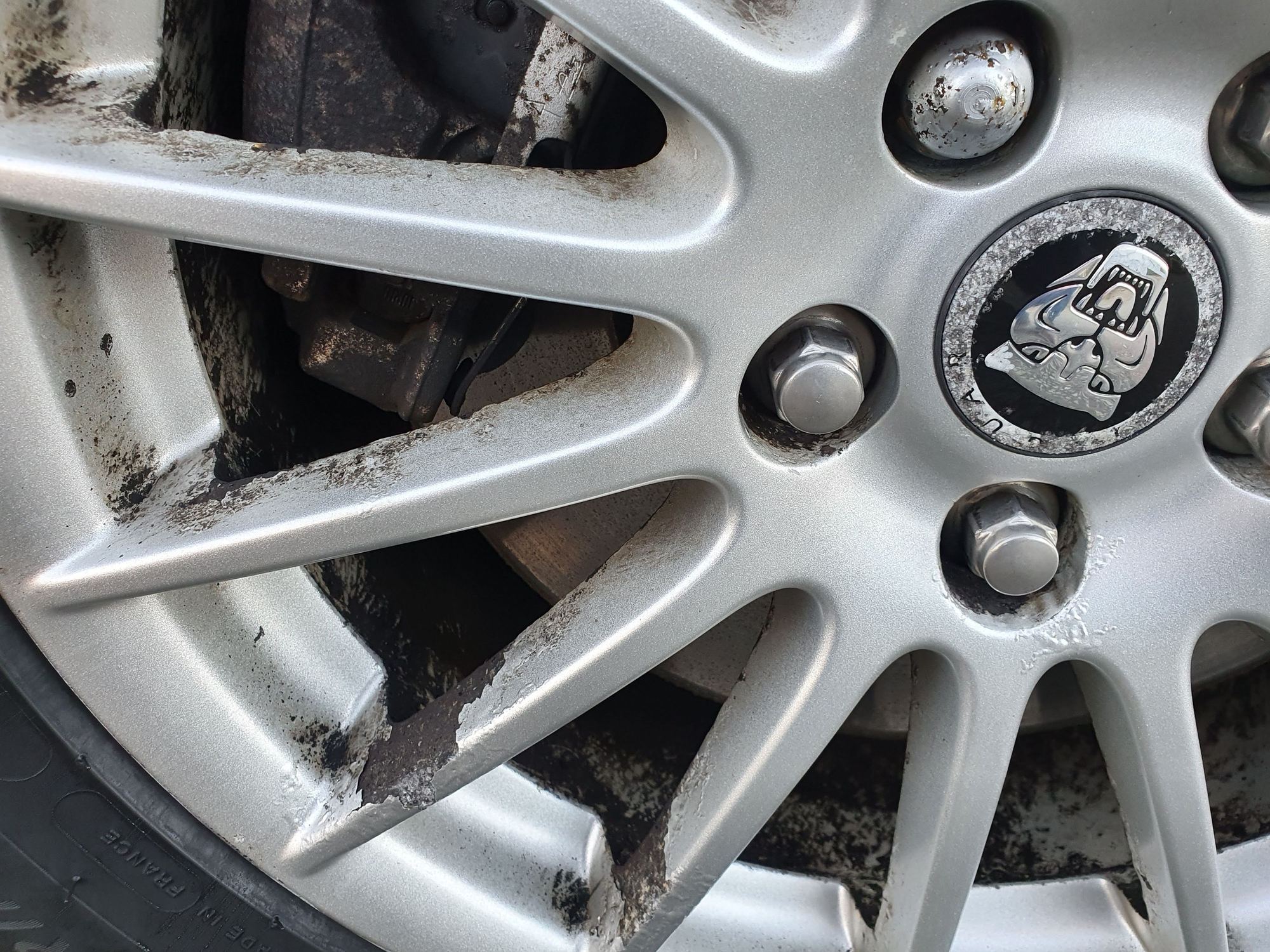

Mine are pretty knackered

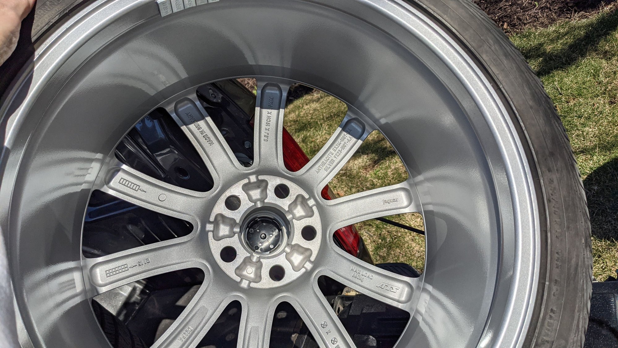

I have attached photos of my XF wheels that just got repaired and refinished at a local wheel shop. (~$500)
They have amazing processes that can do repairs to look like new.
All four wheels had extreme curb rash when we bought the vehicle from the previous owner.
Also had paint peeling from the dealer touch up, and other various blemishes.
Very happy with the repairs. The same shop did work on another set of wheel (different car) several years ago and they still look like new.
Hope these photos help.

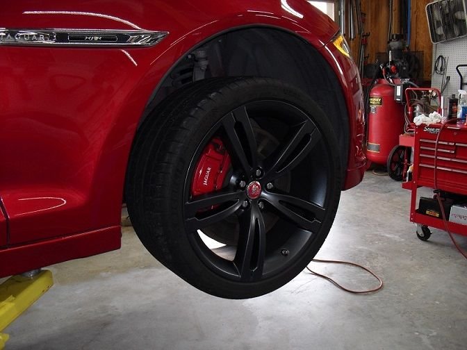

I have to agree strongly. Stay with your factory rims if possible. Just don't know what the aftermarket ones are made of or how they were made. In US at least the reconditioning and powder coating makes them like new. I also paid $500 to get all 4 done plus you can change the color if you want.
I was very happy with the end result. Changed my XJR rims a bit to a nice metallic satin black.
The rear picture is better.
Not sure I am a fan of black yet or not but I have had them for several years now.
