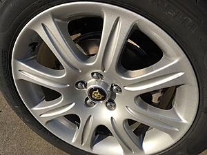

I had mine straitened and trued as well as powder coated here in OKC for $75 each at;
Wheel Works | Oklahoma Wheel Repair - Bent, Cracked, Resurfaced, Curb Rash, Polished, Custom Work
The shot is the finished product done this spring with new Pirelli P-Zero AS+

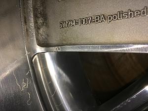

20" Callisto's are really worth being repaired.
Actually, I believe they are not cast but forged.
This is what is indicated in the official Jaguar specs registered for my car. You also see grooves on the surface of the material, probably produced during the machining of the preformed blank.
Once I measured the weight of one Callisto to be only 10.5 kg, which is extremely low for a 20x9J rim.
Unfortunately however, this (as well as maybe not a mechanically optimised design) is maybe a cause of the flats that may be produced by potholes...
