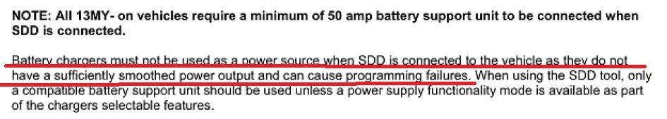

Wrong to use a battery charger. We have gone over this many time. You need a DC power supply of at least 30 amps with LOW ripple. You got very lucky and many have caused problems using improper power supplies.
Attached is what JLR wants you to use for SDD.
Note what's printed in this document!
Sorry clubairth1, I updated my post to reflect accordingly! Appreciate the input!
