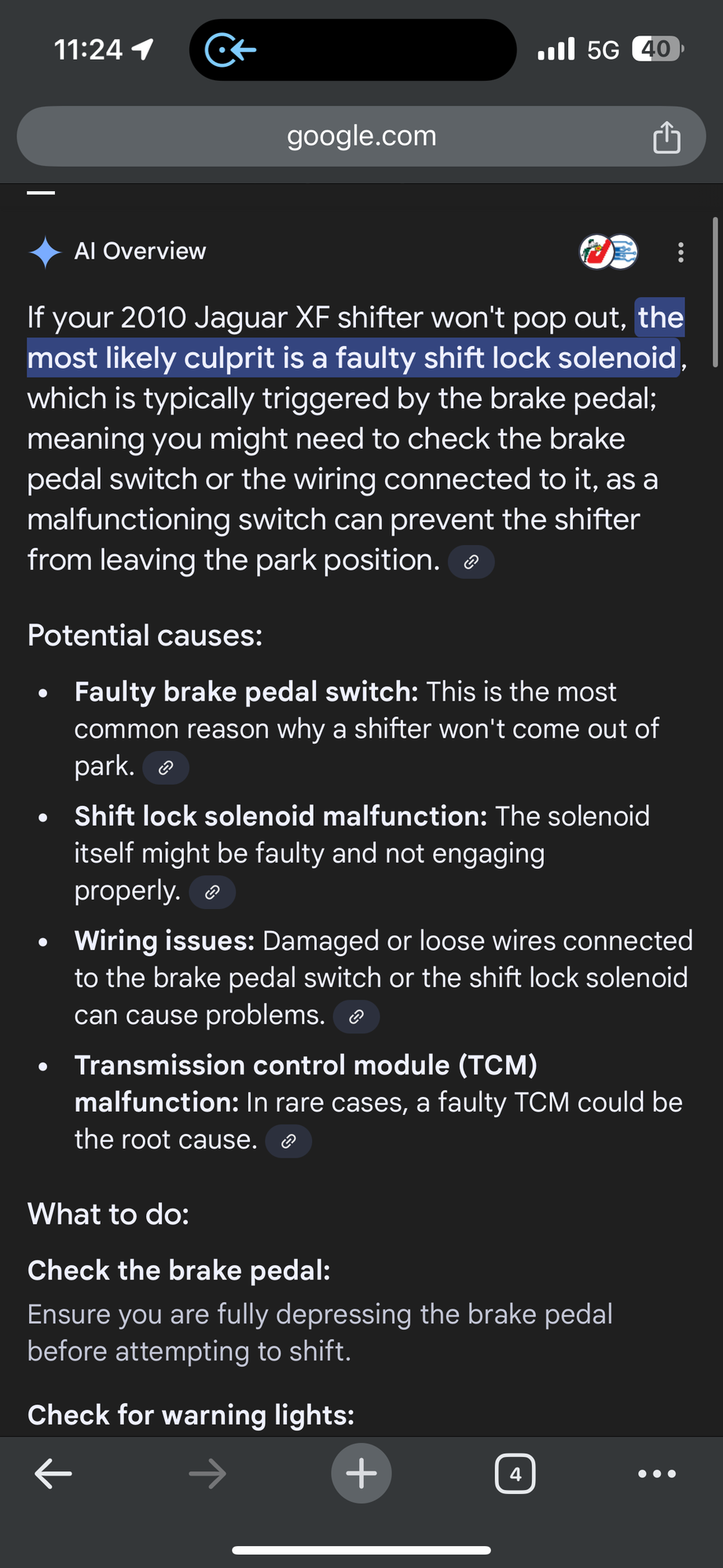

I just restarted the car and I still have the transmission fault message. The AAA technician told me to check the solelioid switch, there doesn’t seem to be any power to the center counsel. See the picture he sent me. Which solenoid switch drives the counsel?

I would dump anything AI. It's just regurgitated garbage. Use the search function as this forum has all the information you need.
We still need the resting battery voltage after it sits all night?
Again we have seen massive problems caused by the battery and I would start there.
