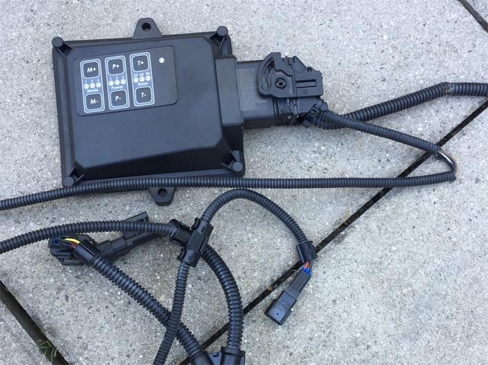

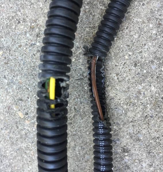

I decided to remove the tuning chip I had installed just in case it was overloading the engine at higher speeds. I installed this chip and set it to the lowest setting possible to increase fuel efficiency and allow quicker Gear upshift (which it did). Anyway, as can be seen in the pics below, two wires became exposed - presumably because the cable housing was against something too hot.
Here is the tuning chip from a company in the UK. Cost about £ 140.
The copper of 2 of the wires became exposed. Presume it was against something too hot (was not near moving parts).
After removing the chip I drove the car pretty hard normal roads and then on motorway at 180 km/h for about an hour and no problems at all. I will not put the chip back and hope that this was the reason.

I had the same thing happen with a performance chip I installed on my old XFS (3.0D 272 hp), the wiring covers "melted" through in two places exposing the wires just a little. Didn't cause any great problems, so I carefully wrapped each exposed wire in insulation tape then wrapped the whole cable in plenty of tape, and made sure I re-routed the cabling well away from any high heat area, and never had a problem afterwards.
I don't think you need to throw away your chip, just rewrap and re-route it like I did and all should be well again.

Thanks and yes, it would make sense to simply re-tape with enough good quality insulation tape however I have the feeling the extra performance due to the chip may have been the cause for my "restricted performance" issue. Car has actually plenty of power without chip, just the earlier shifting and increased torque was nice.
