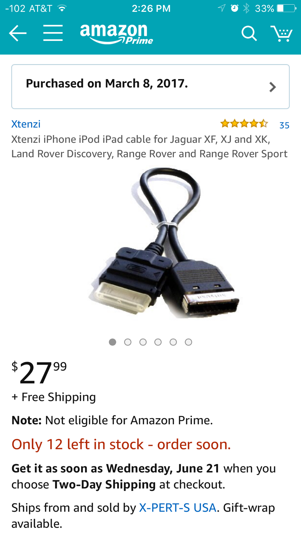

Originally Posted by Michaell
I have a jaguar Xk 2010. Any tips how I can stream bluetooth audio from my iphone 7 to the car?
Tried a bluetooth adapter on the old ipod plug under the armrest. Strangley my touchscreen started to restart non-stop. Maybe because the pjone was connected via the carkit AND the bluetooth adapter.
Tips are very welcome!
You will need these two things. You can use all the steering controls. Works like it was plugged in. I bought March 8th, I'm going back to wired so the phone charges while hooked up. Will sell for $100 free shipping.
Can you ship to the Netherlands?
