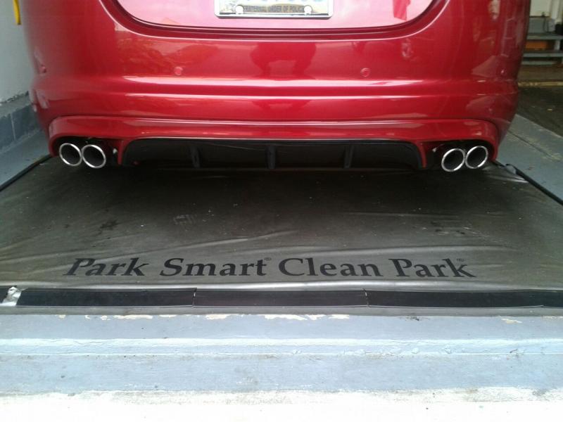

I installed the rear diffuser last summer and it came out awesome.. I had it done in two tone and you can also add the carbon fiber parts as well. Took me all of a hour to install. Reaxion XFR was my inspiration and Mina supplied all the parts.

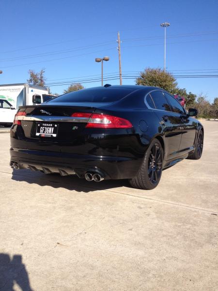

Carbon fiber rear diffuser with upper lip paint matched and new Mina exhausts. Looks great and exhaust sounds MEAN!!!

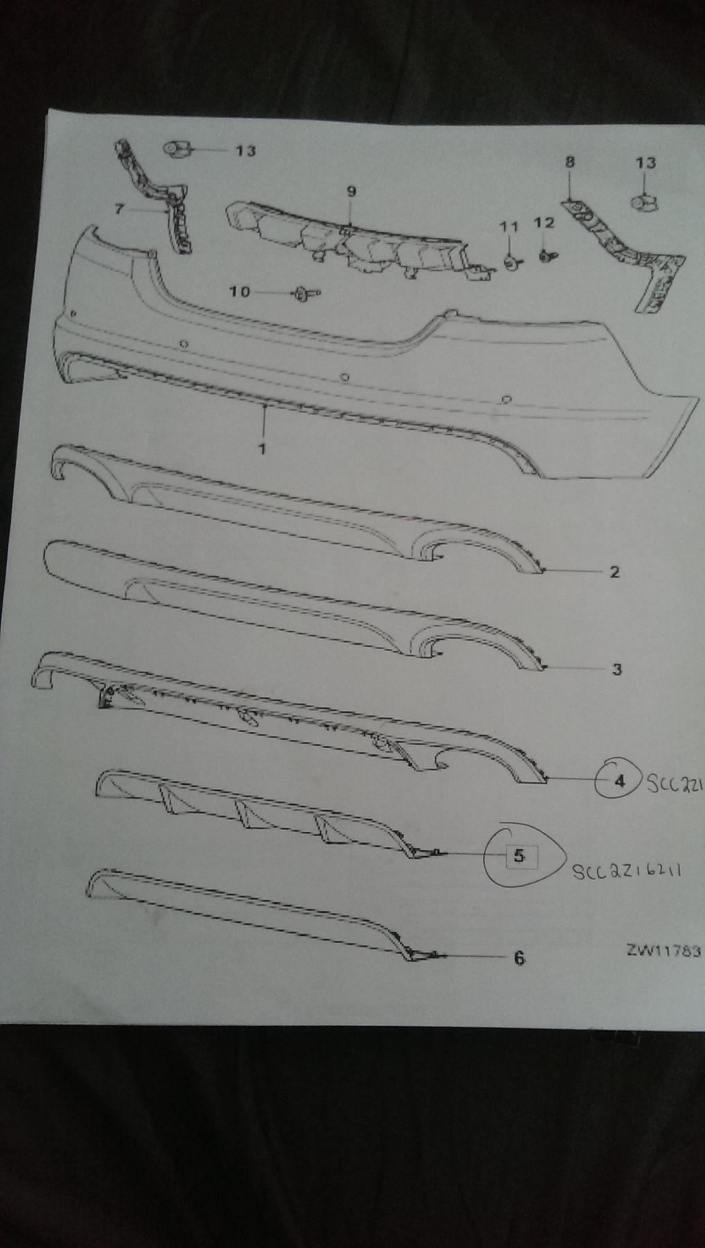

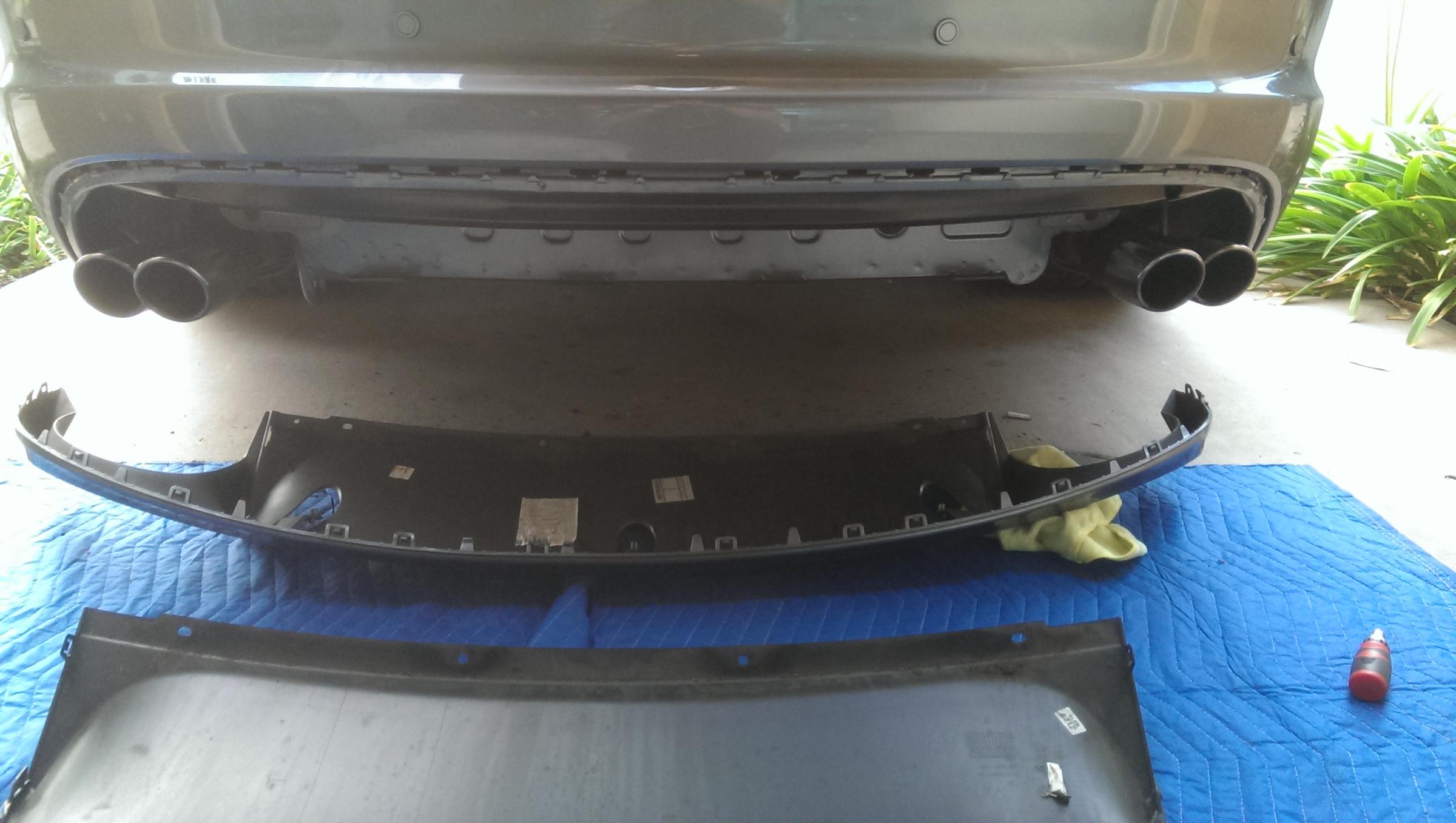

I'm in the process of doing it. From what I know of so far, 2012 and up XF Supercharged and XFR Share the same 3 piece bumpers. So all you need is the fins ( C2Z16211 ). Non-super charged XF's is a 2 piece bumper so you'll need to get the valance ( C2Z16212 ) and fins ( C2Z16211 ).

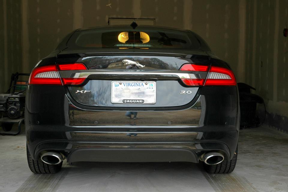

I recently did this upgrade to mine. It was an easy swap.
