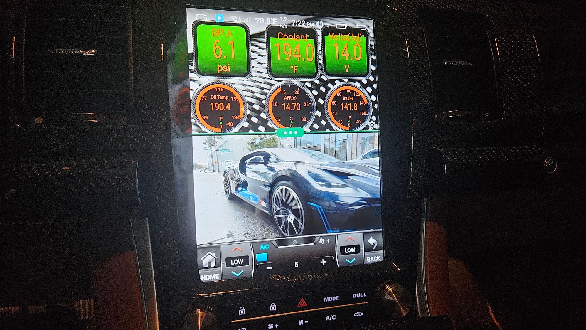

Added gauges

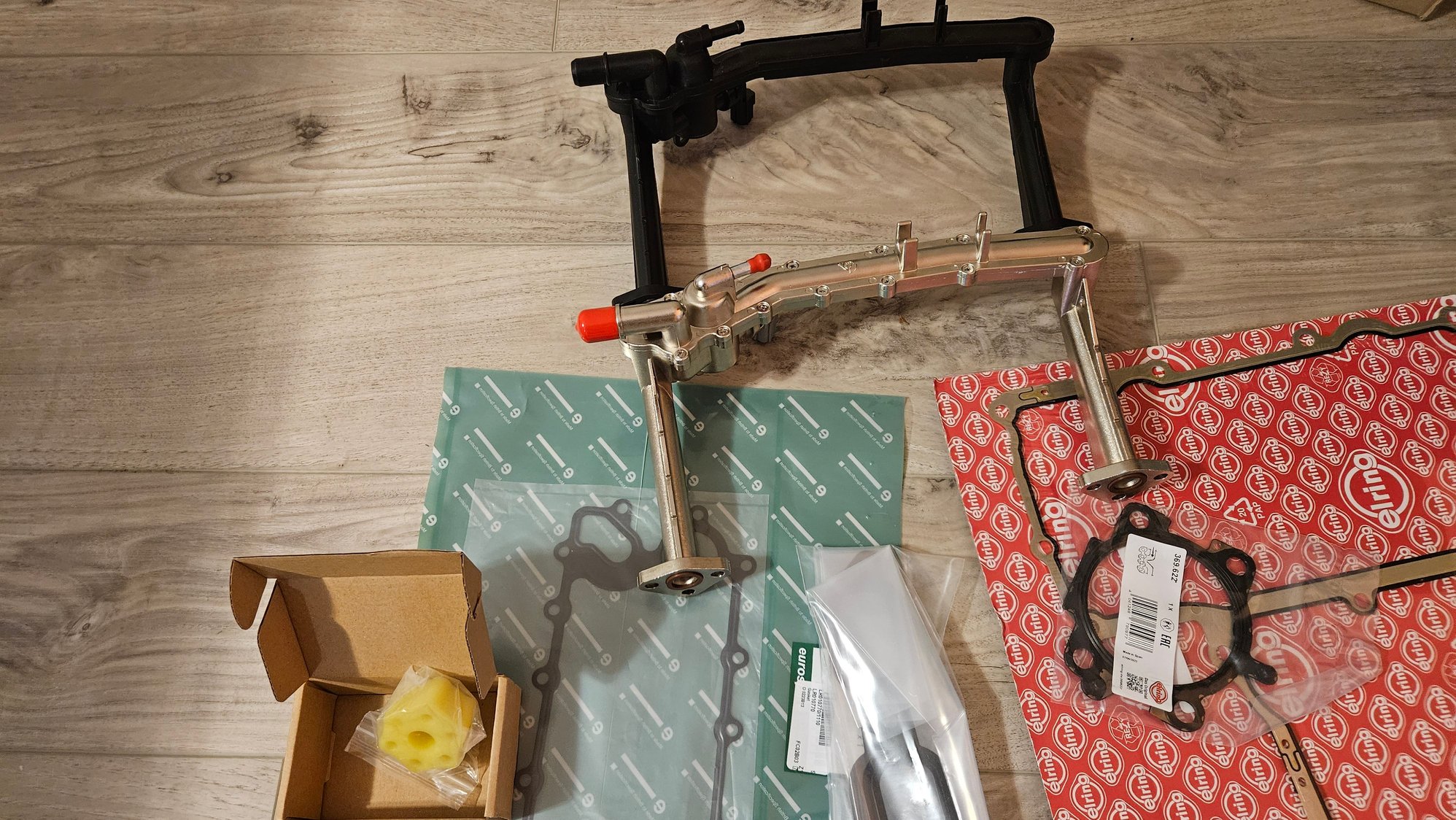

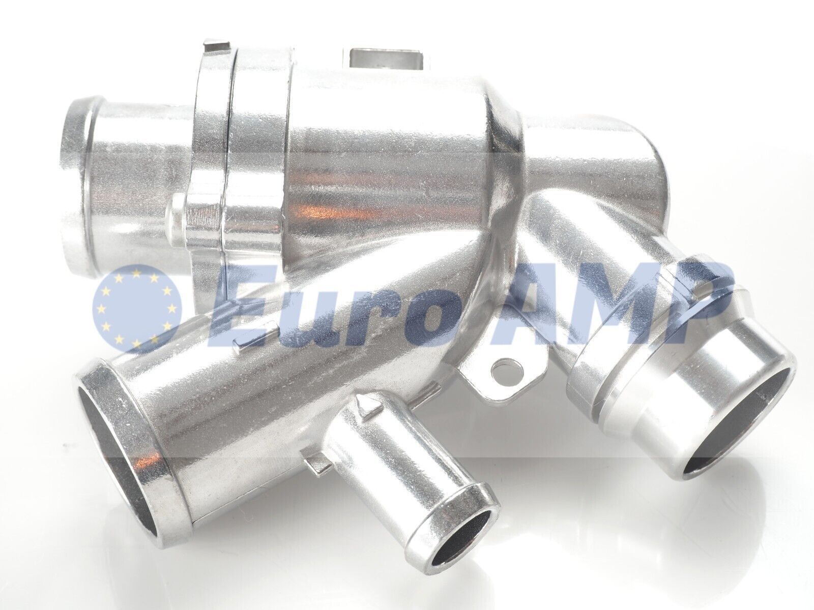

i have another metal part to try out ,a metal thermostat
with sensor
new video

The 4.2 V8 does not have this pipe issue….but it does have a plastic thermostat unit which tends to degrade, allowing plastic bits to jam the thermostat itself. Easy to replace.

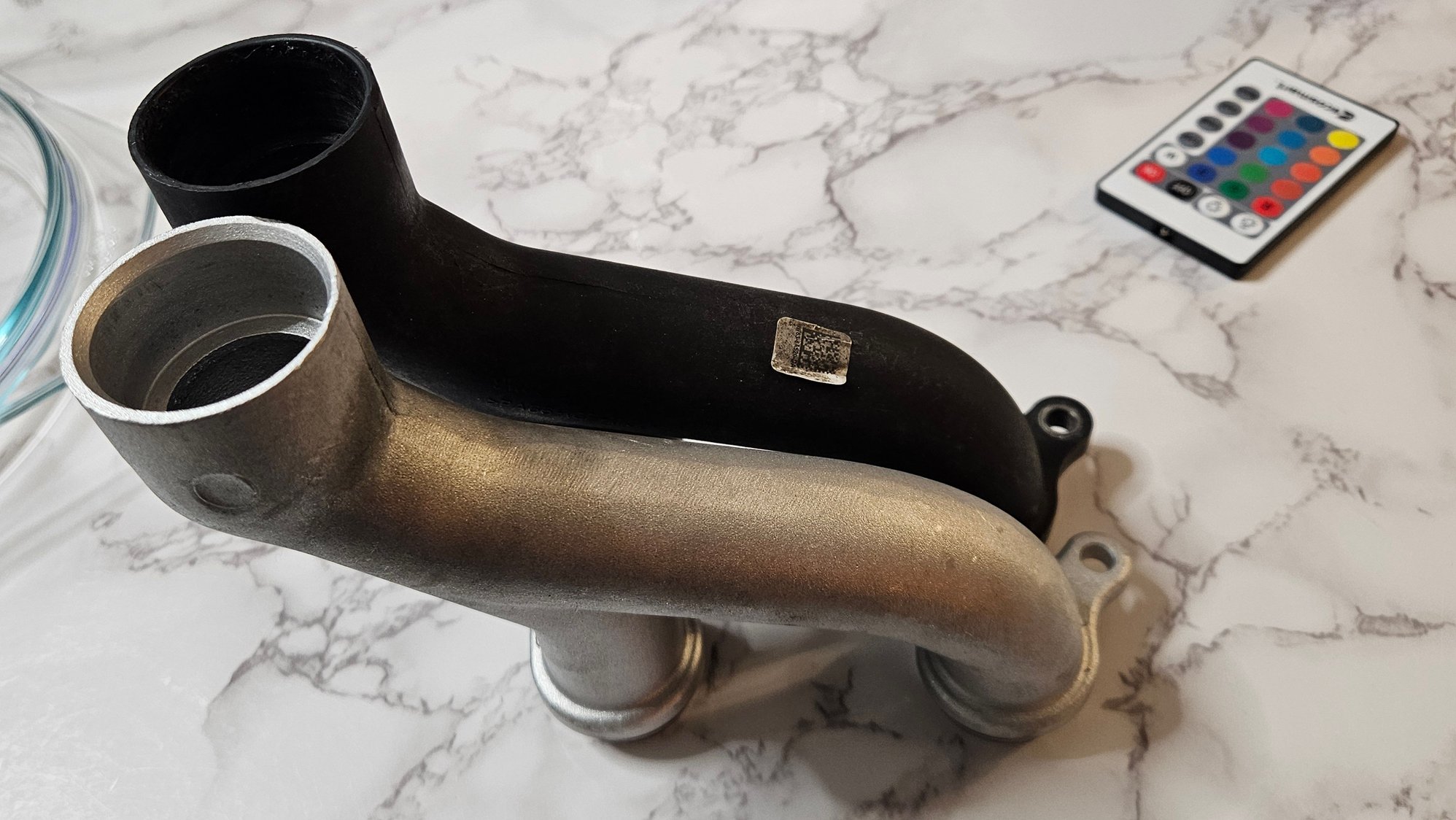

Please guys check your pipes ,before installing, when they first came out a few years ago ,they sent me some prototypes,and were off by a 1/8 inch ,so I contacted them and they resolved the issue, but there are some replicas out there so match everything, to be on the safe side,(just a heads up)
Also I took the o rings of and replaced them with OEM , use lube when inserting them , the F-type and Xj and my Xf are going strong, the F-type is a year and 6 months no issues

I know this thread is pretty old but do they make a metal thermostat housing for the 4.2 V8?
Old Sep 14, 2025 | 07:07 PM
dennis black's Avatar
20 Year Member
Joined: May 2006
Posts: 2,052
Likes: 593
From: connecticut
yes they do
