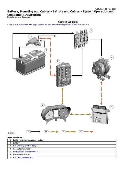

This explains things, take note of the fuselink as if this fails the bms can't monitor the voltage.....https://ibb.co/2sKSSHt

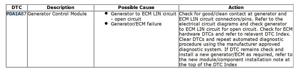

Although you have not given a full code, there is only one extended code for P0A1A87 so the possible cause is unequivocal. Better hope it's not ECM failure!
The only modules in the control system are the BCM and the ECM as the generator has an in-built regulator:
