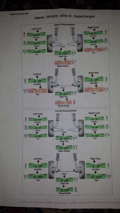

Guys I need some help. I have been experiencing a vibration in the steering wheel for about a year and half now. The dealership told me the tires (Dunlop Sport MAXX) tend to flat spot and that the vibration is a characteristic of the tires. 6 months ago they told me the tires are cupping and that is what now is causing the vibration.
I had all 4 tires replaced today (Continental DWS) and Road Force Balanced by the Dealership. I then had the alignment done which came back in spec.
Guess What...the vibration is still there. Now the steering wheel doesn't "shake" like it used to but you can still feel the vibration when gripping on the steering wheel. Worse when driving into/out of corners.
I am starting to now think I may have an issue with some front end suspension. Can anyone suggest things I should look at or have looked at it by the dealership? Shocks/Busings/Steering column etc? Has anyone else had this issue.
I currently have the 20 inch Draco OEM wheels. The dealership verified no bent wheels.

I am going to have them look at the following:
- Bent/Out of Round Wheels
- Suspension Parts
- Are the tires out of round?
- Issues with the Steering Column
What concerns mean is the previous tires were cupped and the dealership stated it was because the car was out of alignment. Well that turned out to be a false statement when I got the alignment checked and everything was in spec!
