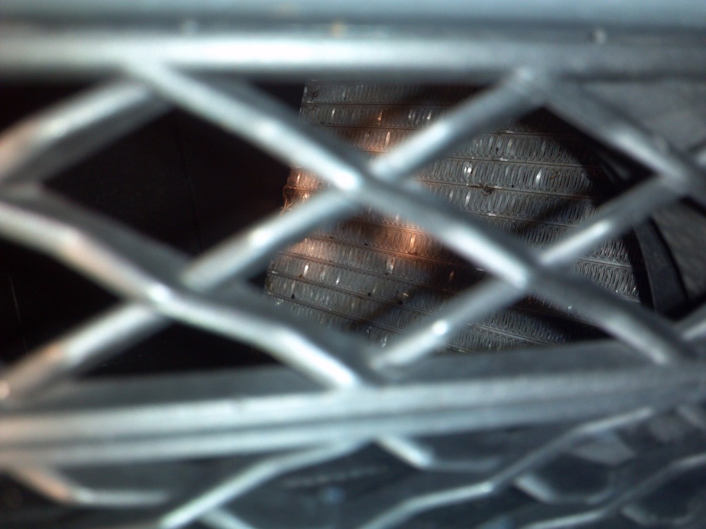

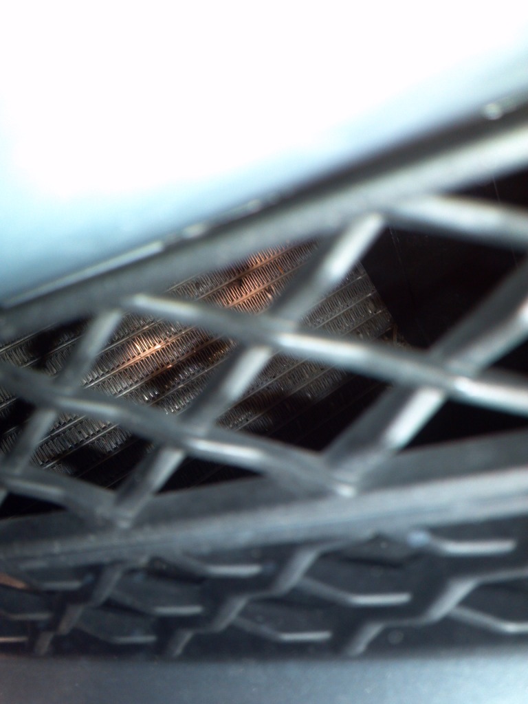

Just verified on my 2011 xfsc an intercooler behind each cat eye bumper opening. Impossible to tell if its air-air or air-water

The cooling system for the supercharged engine is very similar to the normally aspirated engine, but with the addition of a water cooled, intake air charge cooling system. This comprises a radiator, an electrically operated water pump and two charge air cooler assemblies (heat exchangers). The system works independently, but is connected to the main cooling system at the bottom hose to allow for thermal expansion and to help to prevent unwanted circulation.The supercharger cooling system is integrated with in the engine cooling system but uses a separate radiator and electrical water pump.

The coolers behind the openings on each side of the bumper are oil coolers not intercoolers.

The finned design and location tell you these are liquid to air coolers.
