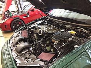

Almost done. Just washing her up now.
The repair "kit" includes the complete snout, isolator, gaskets, and bolts.
Took them about 6 hours (including lunch break). And about an hour of that was trying to remove the snout without taking the SC completely out of the bay. They finally gave in and removed it all the way. Made replacing the snout on the bench a lot easier anyway.
I had a chance to peek at the intake valves, they look great, no buildup of carbon at all (24,000 miles).
This is what it looked like before they realized that they had to remove the left side (right side of the SC assembly if you are looking at it from the front) manifold runner to access a bolt on the snout, which required them to completely remove the SC from the top of the motor.
