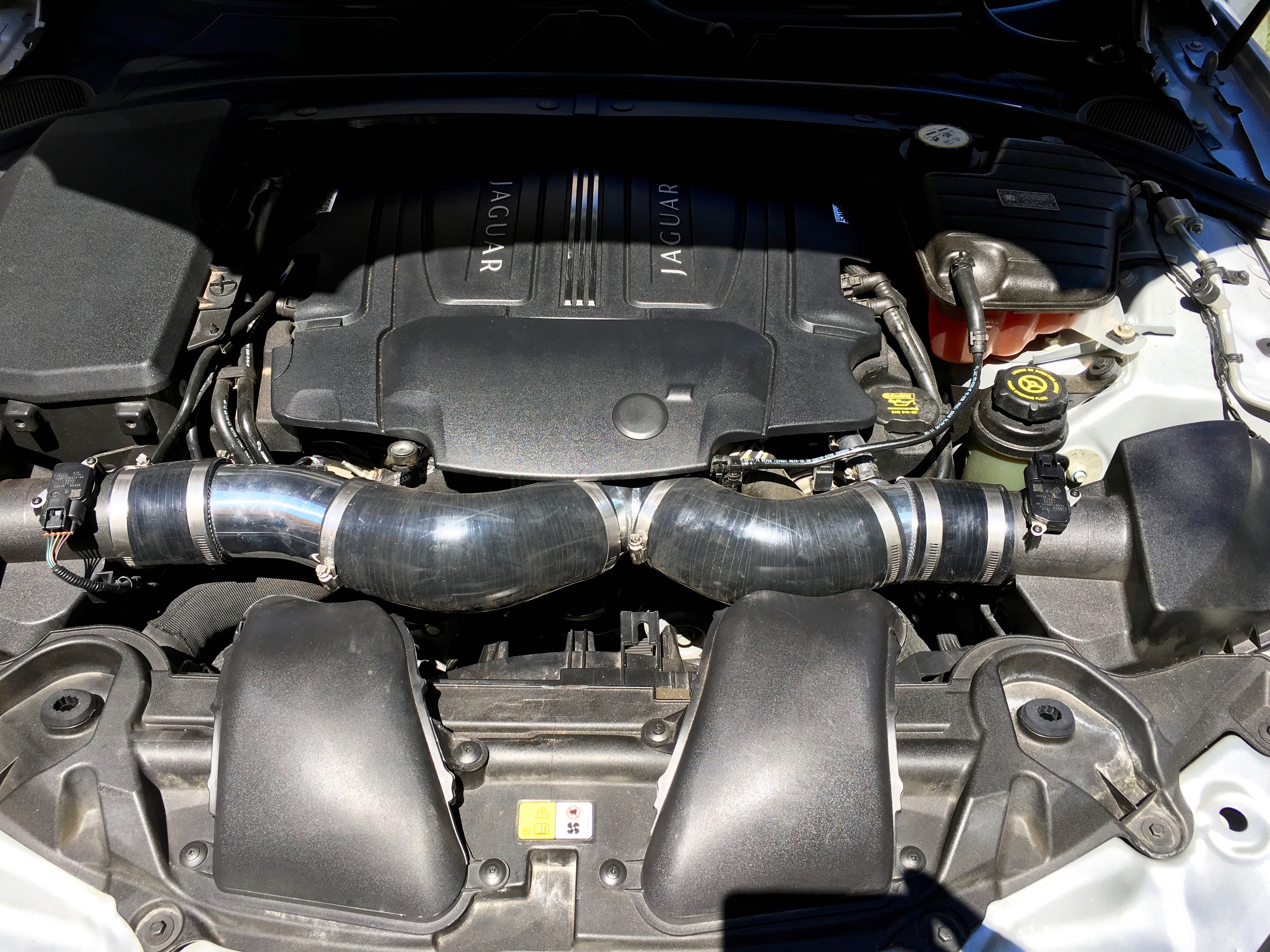

1/ Eurocharged tune
2/ Eurocharged pulley
3/ TCP Intake
Will give it a week or so to settle in and then back on the dyno...

One point/question on the intake upgrade. I have the boost pulley which is smaller than stock and even with that I found it really hard to be sure the intake was clearing the pulley. I'm not sure if I had the stock one, whether I'd have been happy with the clearance. Anybody else with the TCP intake care to comment on their install tips ?
Take your time and be willing to take it all the way apart and then reassemble. Took me just over 3 hours to feel good about it. Did it in pieces multiple times. And I couldn't ever get it where all the silicone wasn't bent just a bit more than I wanted or the clamps parallel to the ends of the silicone.

I've disassembled and reassembled my TCP intake three times now and I still can't get the kinks out of the two 45 degree silicon tubes. In my case they sit on the intake snorkels quite "hard", apparently a lot more than most, but there is nothing I can do about it. I just put it down to factory manufacturing tolerances, it's no fault of TCP at all, they have been very helpful and patient. For install tips, use plenty of WD40 so you can slide parts around with ease. My intake clears the pulley by about 1 cm, if I increased this clearance any more the kinks would be worse, and although 1 cm looks very close to the naked eye it is plenty of clearance. Yes, a bit of supercharger whine now, but still quite subtle and in no way intrusive or annoying, in fact I would like a bit more!

When it's pulling hard, you can now actually hear it. Never too much, but noticeable. You can't hear any of it stock. The increased intake and supercharger noise is the reason I bought it, so it gave me what I wanted.
And I used a little barely soapy water instead of WD-40 for installation because I didn't want to worry about residue keeping things where I wanted them.
