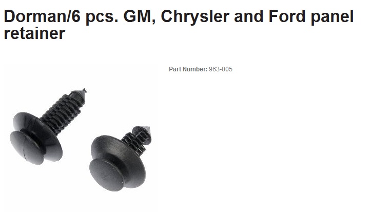

Here's an update - I've been able to complete this job for a lot less than a replacement A Pillar trim
For the plastic clip, I used a Doorman 963-005. There are probably more suitable ones out there but this was readily available at Autozone: Dorman/6 pcs. GM, Chrysler and Ford panel retainer (963-005) | | AutoZone.com - the only downside of this is that it's not QUITE big enough for the hole it goes into, so I put a piece of gaffer tape over the hole in order to make it slightly smaller, and it fits really nicely now.
The bolt I just fitted a standard M6 bolt, 16mm long.
Worked a treat

Good to hear you got it fixed.
