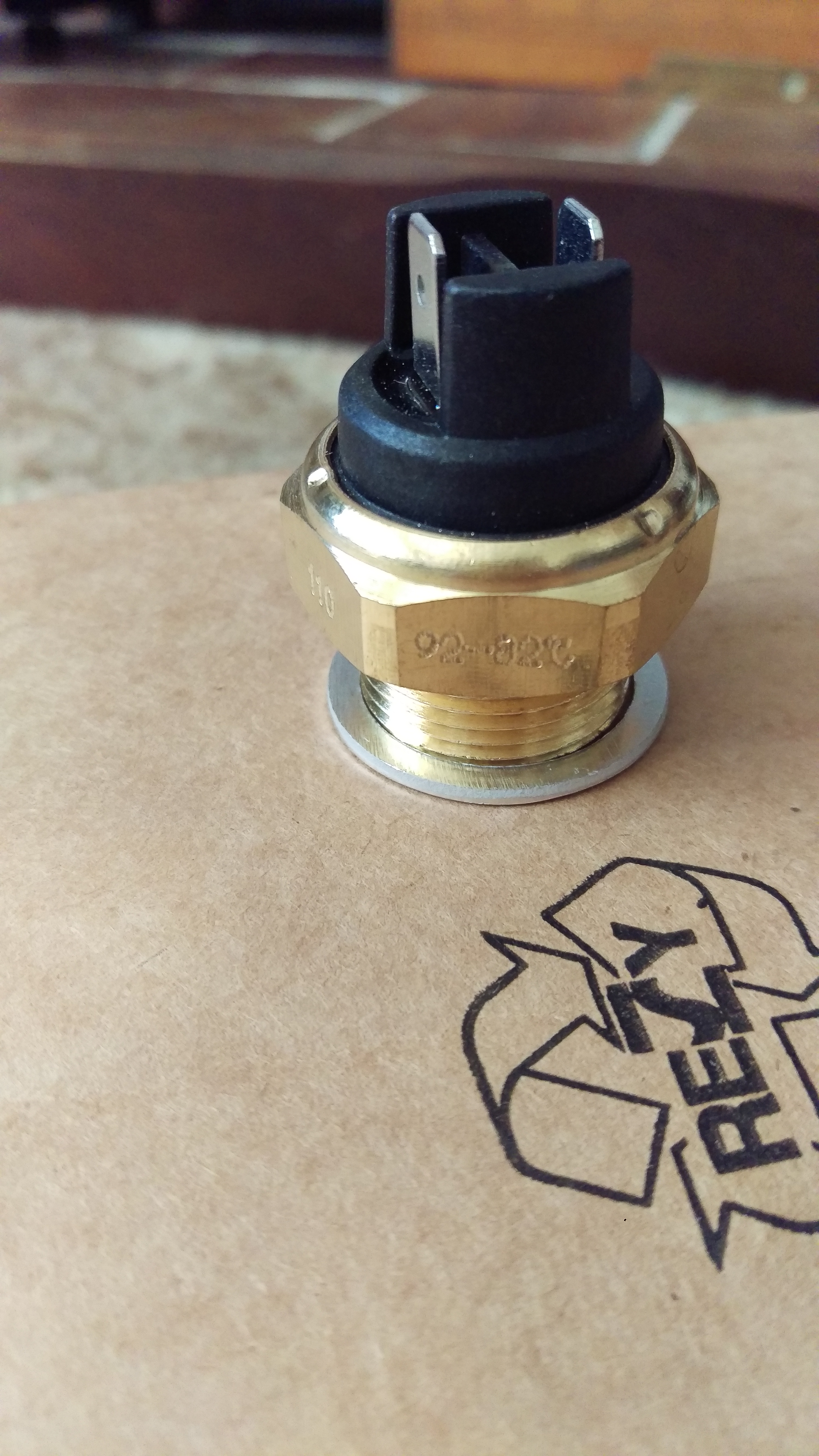

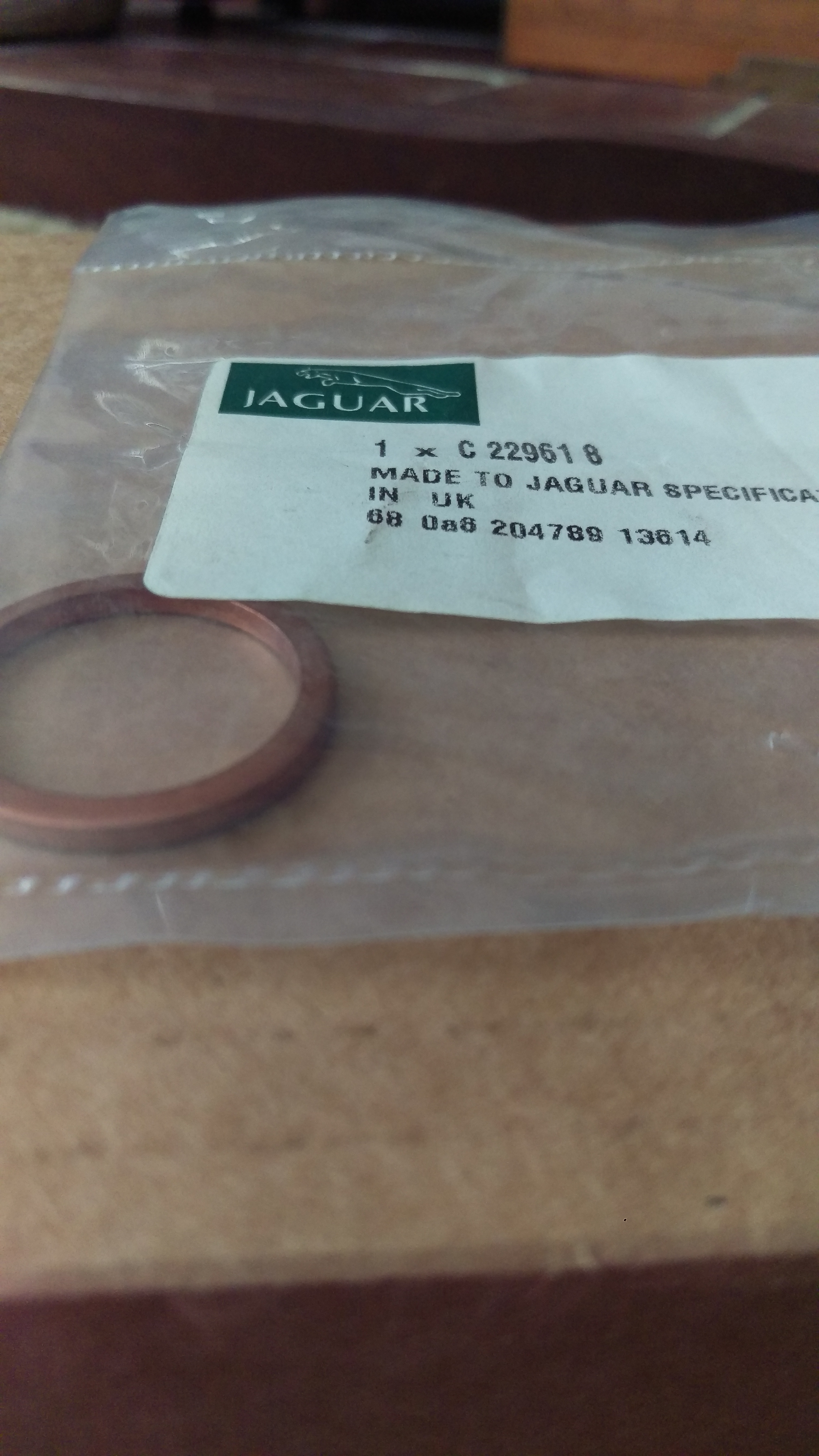

I recently bought this
Jaguar part number C22961
Switch on at 92℃ switch off at 82℃
Attached Thumbnails Auxiliary fan switch, 6.0 V12.-imag0150.jpg   Auxiliary fan switch, 6.0 V12.-imag0147.jpg
