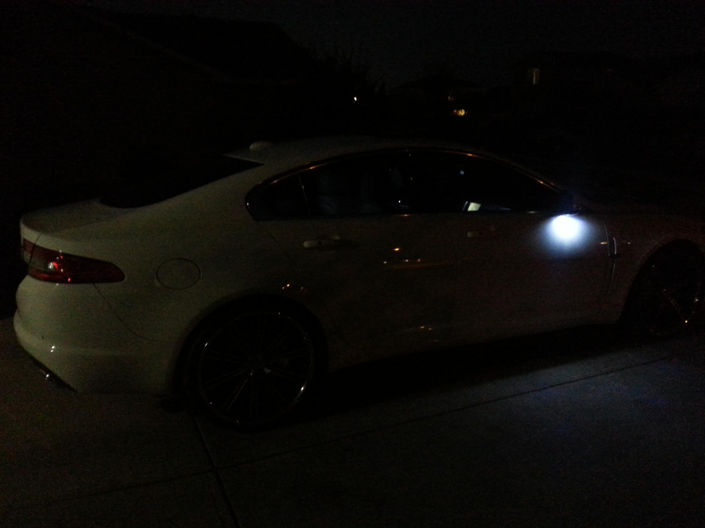

Been meaning to upload these pics for a good while....
Changing out the puddle bulbs for LEDs:
Move the mirror as far up as it can go, pull it away from the housing, then take a narrow bladed flat tip screwdriver, insert into the slot, and pull on the lens assy on the bottom of the housing:
I did manage to break the tab the first time I tried to get the lens assy out...
The bulb just pulls out of the rubber boot. I used the same 5-LED bulb that I did the interior lights with:
Make sure they work before putting everything back together.
Attached Thumbnails The Ultimate LED Q&A Thread-img_6343copy_zps534a1f88.jpg   The Ultimate LED Q&A Thread-img_6344copy_zps23ff9bef.jpg   The Ultimate LED Q&A Thread-img_6353copy_zpsd16984b3.jpg   The Ultimate LED Q&A Thread-img_6349copy_zpsae0bfc58.jpg   The Ultimate LED Q&A Thread-img_6351copy_zpsb2123d45.jpg

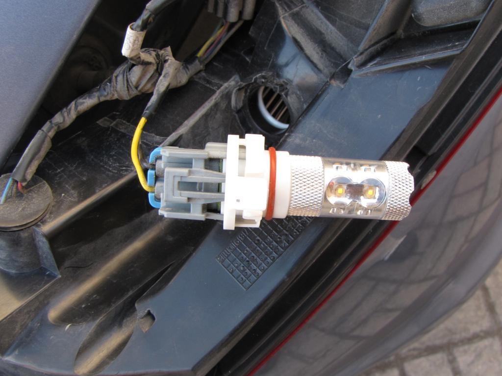

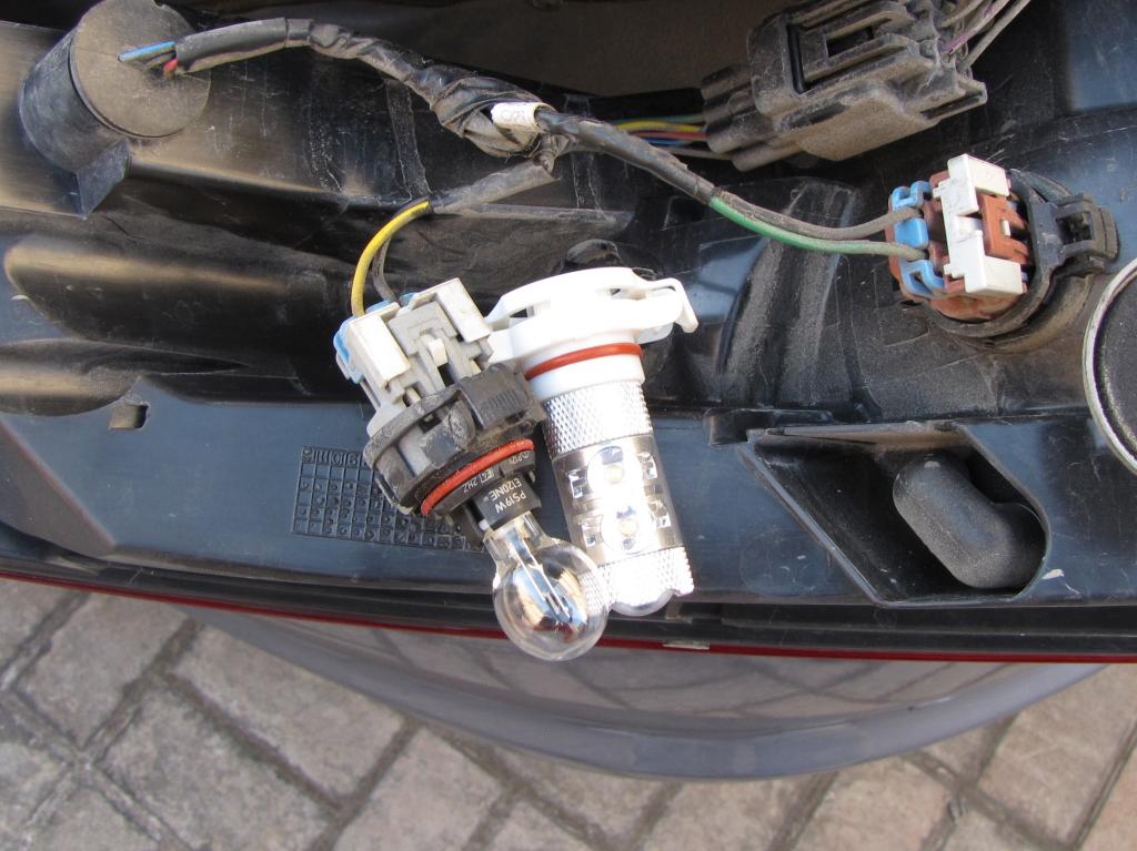

While I'm at it, might as well show how I changed out the reverse lights.
Remove the trunk liners to get access to these three nuts on each side:
OK, bear with me here, I did this almost a year ago, and the memories are a bit fuzzy... Lift up the clips around the circled plug, and pull the plug up:
OEM bulb with the replacement LED bulb. Will have to look up the number of the LED bulb again...
Remove the white clip, and then pull the OEM bulb out of the socket. I left the green o-ring in place.
Press the new bulb in place. You will feel resistance because of the o-ring.
Reinstall the white clip.
Test the light. If it doesn't work, rotate it 180, reinstall and test again. If everything is copastetic, reinstall into the taillight housing, put housing back onto the car and put back on the three nuts. Repeat for the other side.
Original OEM bulbs:
LEDs:
One big thing to take into account. The LEDs get kind of washed out in bright sunlight, to the point that other drivers may not be able to tell with a quick glance that the lights are even on. In all other lighting conditions, especially at night, these suckers really light up the area.

I tried the same thing a couple of months ago, but try as I might I could not move/release the bulb housing.
What worked for me was to lever the cover off from the outside, no need to unclip the mirror glass at all. Gently, with a small flat blade screwdriver covered with a cloth. Only problem was that the cover/housing wouldn't fit back tight and flush, fixed by a careful application of superglue.

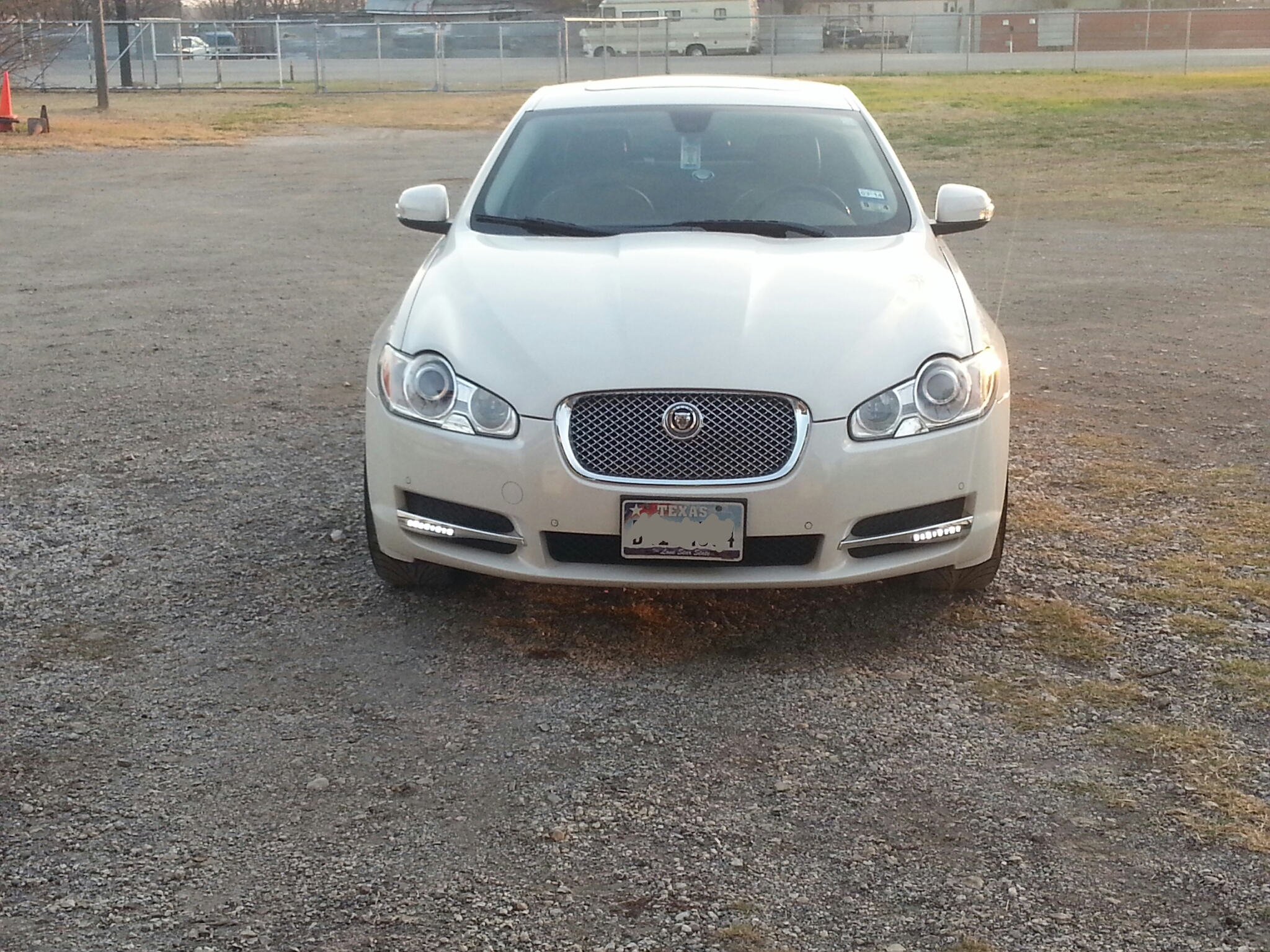

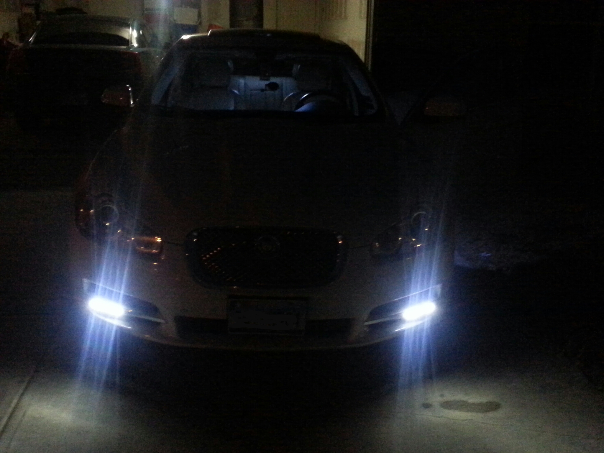

Thanks to this thread I've spent more money upgrading to LEDs...smh. Since this is the official LED thread figured I should put these here. Because Adamesh is not currently making the LED DRL blades and I just couldn't trust the set from China on eBay for their asking price, with no reviews, I decided to buy a set of Philips DRL 8 LEDs, grab a rotary tool, LOTS of time and DIY'd these myself (tell me what ya'll think). All the interior bulbs with the exception of the vanity mirrors (should be in the mail when I get home) have been changed. The reverse lights should be in the mail as well. Haven't decided on doing the turn signals yet but will do the hi-beams in the near future.
Attached Thumbnails The Ultimate LED Q&A Thread-front.jpg   The Ultimate LED Q&A Thread-19036218.jpg   The Ultimate LED Q&A Thread-19036219.jpg   The Ultimate LED Q&A Thread-19036221.jpg   The Ultimate LED Q&A Thread-19036222.jpg
I think you did a great job on the LED running lights!

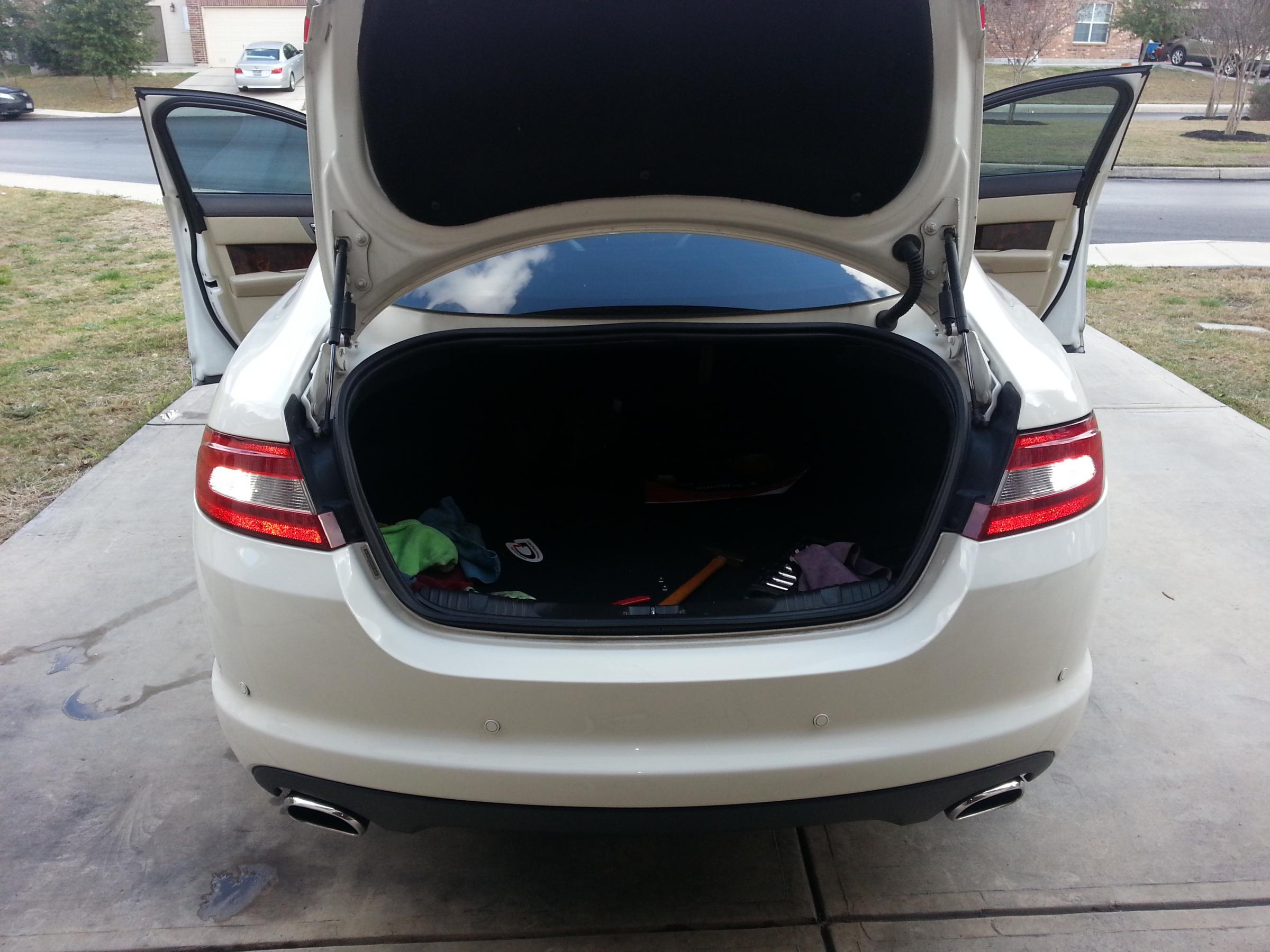

Finally got my vanity mirrors and reverse lights done. Make sure if you're ordering reverse LEDs that they aren't bigger than 17mm in diameter...learned that one the hard way.
Attached Thumbnails The Ultimate LED Q&A Thread-20140315_152044.jpg   The Ultimate LED Q&A Thread-20140315_162920.jpg   The Ultimate LED Q&A Thread-20140316_201506.jpg   The Ultimate LED Q&A Thread-20140316_201544.jpg

The only trouble I have is the rear turn signal led lights. I have tried the "no error" 5202 from an ebay seller, which fits perfect and lights up, but still gives the error after turning on and off the car, driving, after days.
Anyone have a brand they used that didn't give them this error? I don't want to chop into the wires and add a resistor.
Thanks ahead of time guys.
