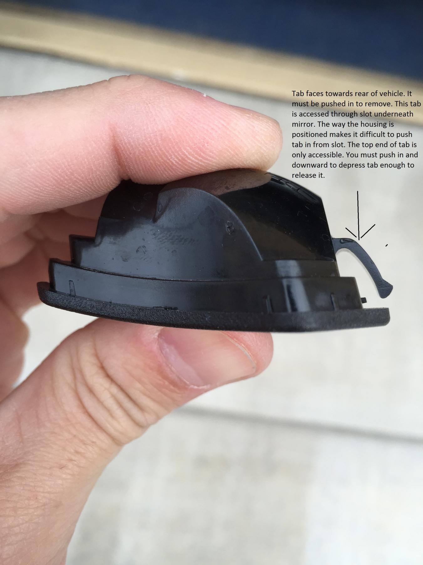

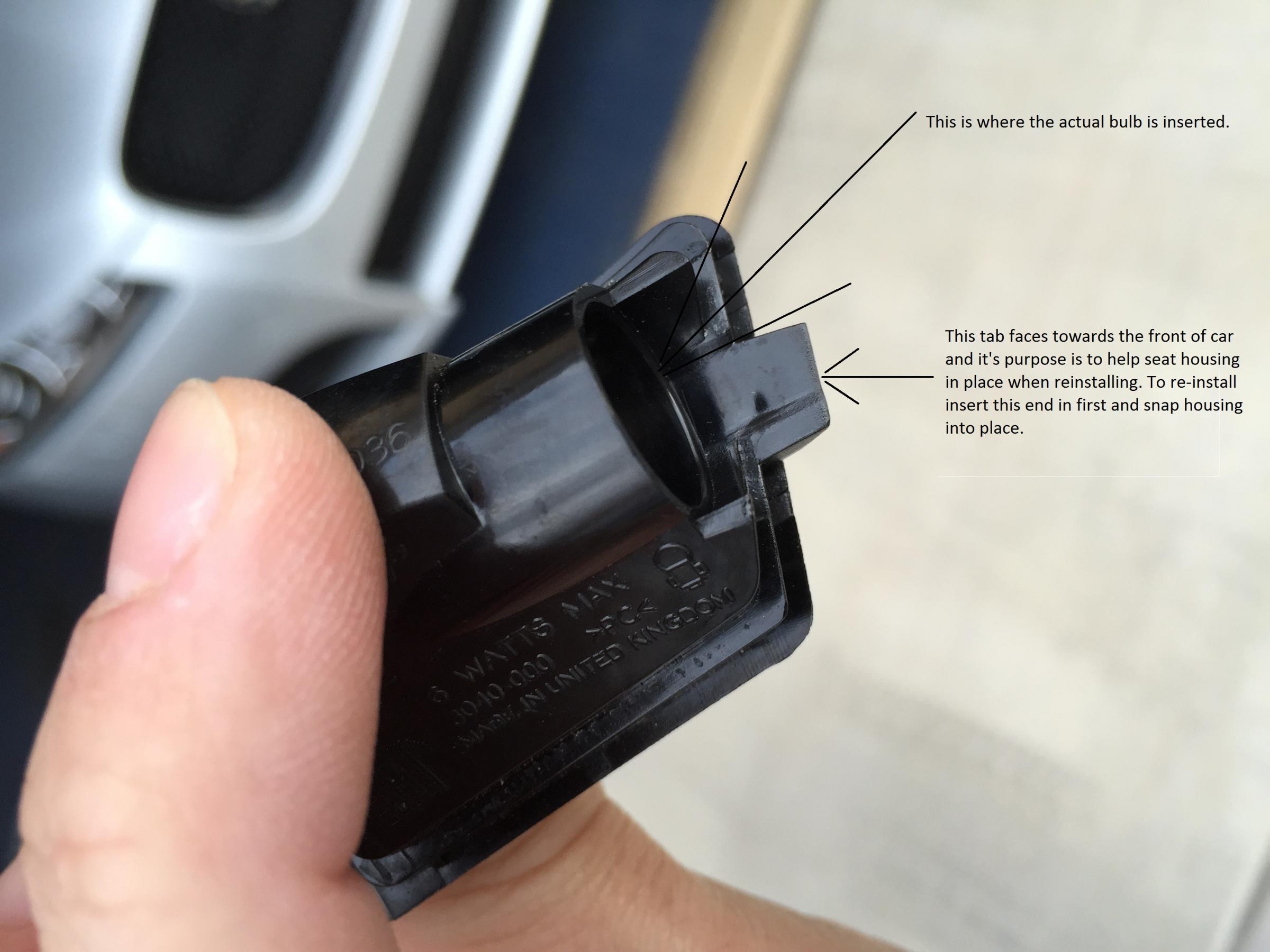

I finally was able to remove puddle lights today. After getting the first one out and examining the housing and tabs the other side was a breeze.
Procedures:
1) Position mirror as far up as it can go.
2) Using a thin flat head screwdriver, insert into slot underneath the mirror.
3) This is the tricky part. Only the very top part of tab is accessible through slot making it difficult to depress tab. You must push in and downward to have enough force to depress tab. If done correctly the housing should pop out just slightly. Then from underneath the outside mirror housing you can use your finger nails or the screwdriver to remove the bulb housing. It should come out very easily, if not then the tab is not depressed enough.
4) Insert your bulb and replace housing by inserting front facing tab and then pushing up and popping rear facing tab into place, should snap right in.

Thanks for that post & pics Gene.
I replaced my puddle light bulbs with multi chip SMD LEDs about a year ago, they look great, with a nice bright white light with blue speckles in it.
I could not get the tabs to depress no matter what I tried, including completely unhooking the mirror glass to give me more room and leverage. Now, thanks to your pics Gene, I can see that both my tabs were totally broken off and there was nothing left to depress!
In the end I levered off the bulb housings from the outside, using two small flat blade screwdrivers and a protective rag, took a bit of effort before they came off.
But they didn't want to stay fully in place when I reinstalled them (no surprise without the locking tabs), so I ended up carefully supergluing them back in place, and never had a problem since.
