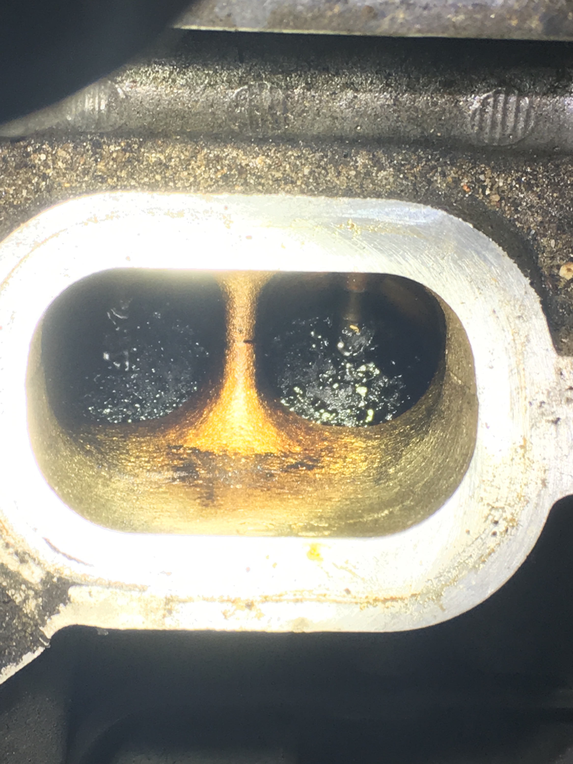

Here is the carbon build up on my N/A 5.0 Jag at 88,000 miles

How was this condition remedied?
Holy **** (America) or the equivalent in UK (Bloody hell)... How did you fix that?
I know definetly going to assume (from now on) there is no DI engine that is not suffering carbon buildup. Thought that this was more common on the german autos but appearantely it is on all vehicles with DI.

It wasn't. This is actually not that bad compared to the German cars, especially Audi! I will put another 40,000 and then have it walnut blasted.
Thank you. The volume of contaminants is not that dissimilar to what was commonly seen in the valves of V8s back in the '60s when leaded fuels were used. Those engines didn't care either.
