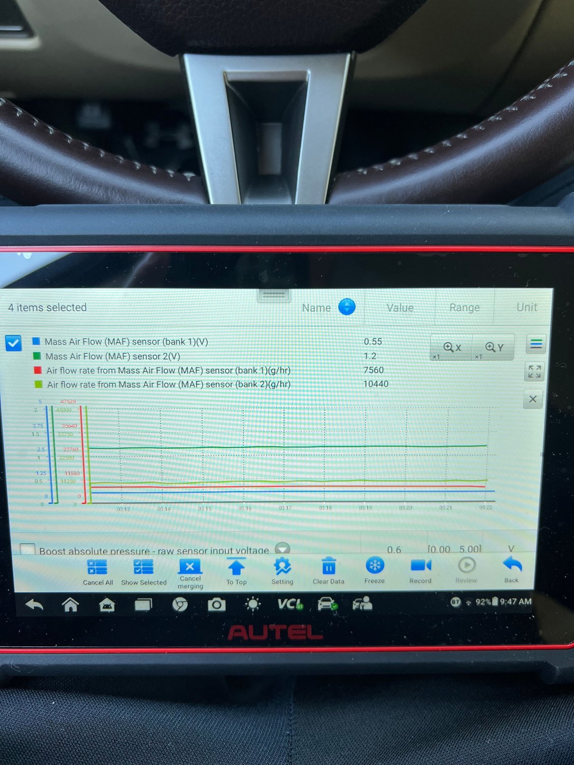

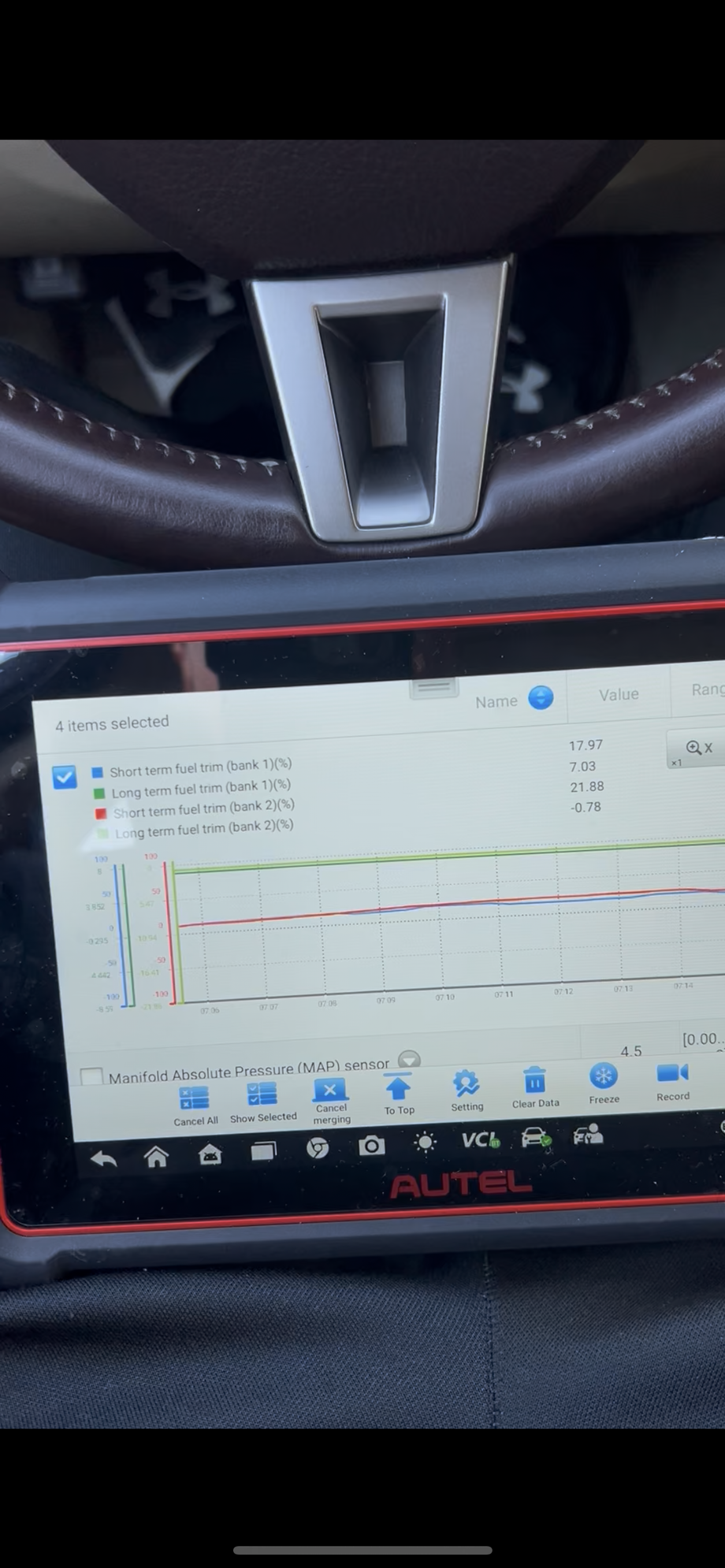

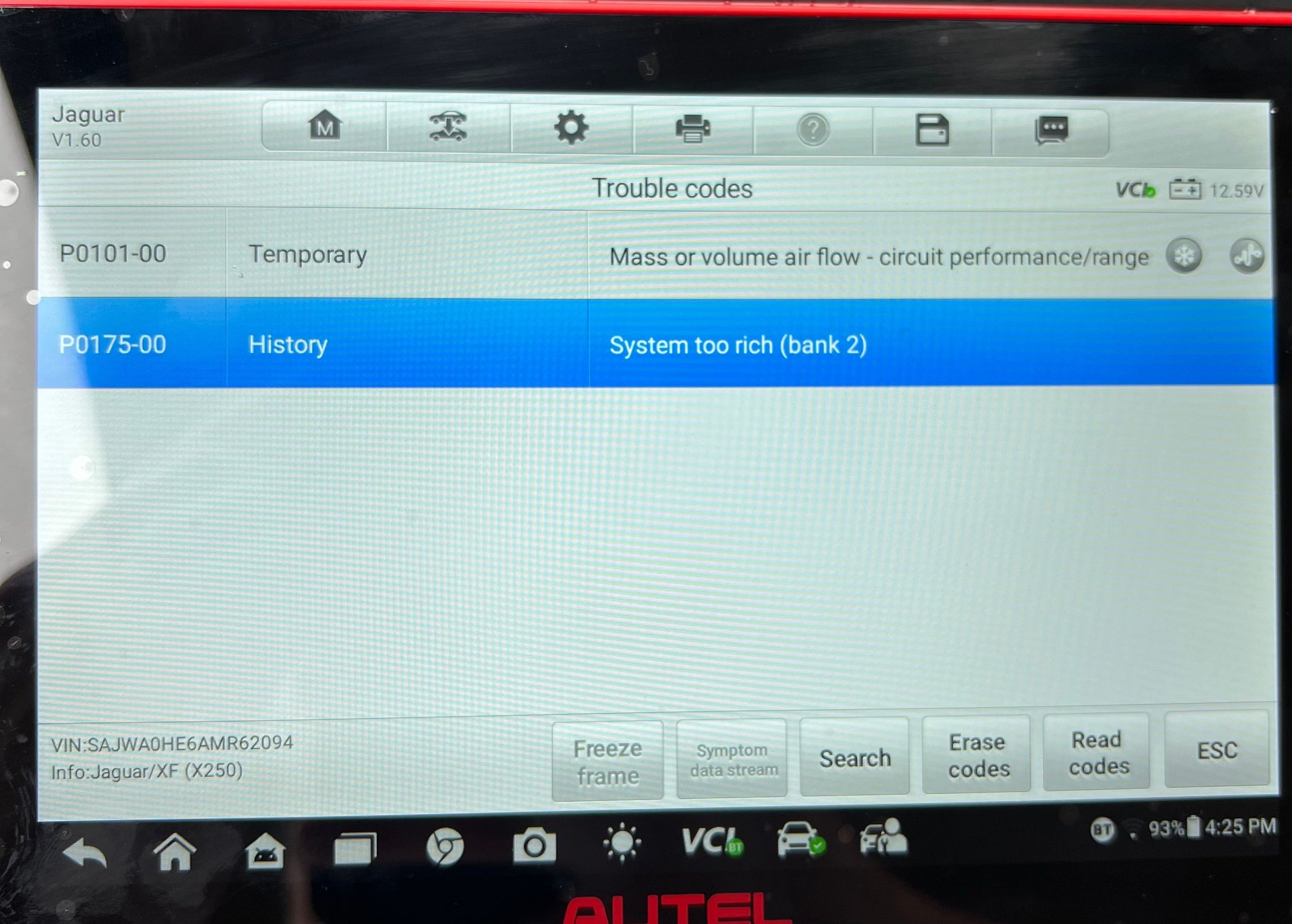

Hey guys I’ve been having an issue with my car running rough for a bit now. Car barely ever throws any codes but as soon as i get on the gas, once I left off it struggles and acting like it’s going to stall out but it doesn’t. Sometimes I will be driving and the car acts like it’s cutting fuel and hesitates but then it goes away. I’m leaning more towards possible maf wiring issue as I have already replaced the maf sensors with new oem ones and still having the issue. I smoked tested my engine and couldn’t find any vacuum leaks either. I
Here are the codes I get sometimes, I have also had all the injectors cleaned and seals replaced. Just trying to get to the bottom of the issue. These pictures are of the car at idle.

Why did your replace the MAF's? What codes/problems did the car have?
Old Sep 2, 2025 | 10:36 AM
gretle_2.0's Avatar
Joined: Jan 2021
Posts: 99
Likes: 8
From: Hershey, PA
the P0101-00 code
