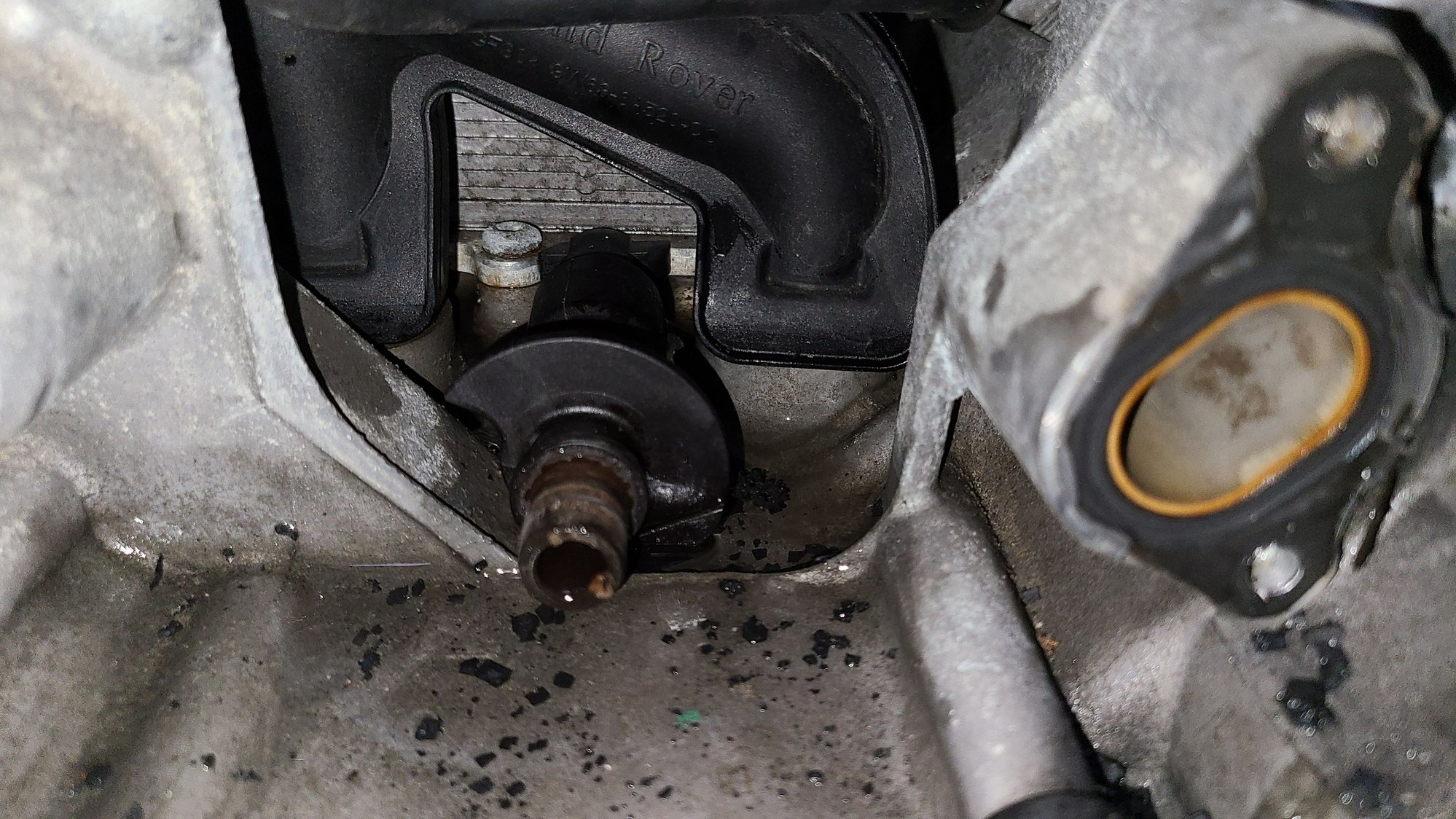

I'm having a mysterious water leak. I have replaced the infamous reservoir line that runs from above the throttle body to the overflow tank. Now, I'm seeing a bunch of coolant under the car and before I took the water pump off I thought it was coming from there. I now have the water pump off it seems fine. But I'm curious as to this black plastic piece back behind the water pump. It has Land Rover markings and when I go to feel it, it feels like it is in two pieces. Kind of like it has split apart at the molding line. Does it transport water? Could my leak be coming from there? How do you tell if a water pump is bad if there's nothing physically wrong with it?
Thanks. I'm trying to do all of this myself, my nearest dealership is over an hour and a half away.
This is just behind the water pump

If you are talking about the U shaped plastic piece with Land Rover printed on it then yes, this piece is prone to split at the seam and it's a well known problem on the AJ126 (and the AJ133 V8).
It's the lower coolant cross-over pipe (also known as the Y-pipe) and the upper pipe above it (in plain view in the engine bay) is also prone to split at it's seam.
You can now get both of those pipes in aluminium alloy, your best bet would be to get this kit which fixes/replaces all the problematic pieces in one go: https://euro-amp.com/products/jaguar...charged-engine

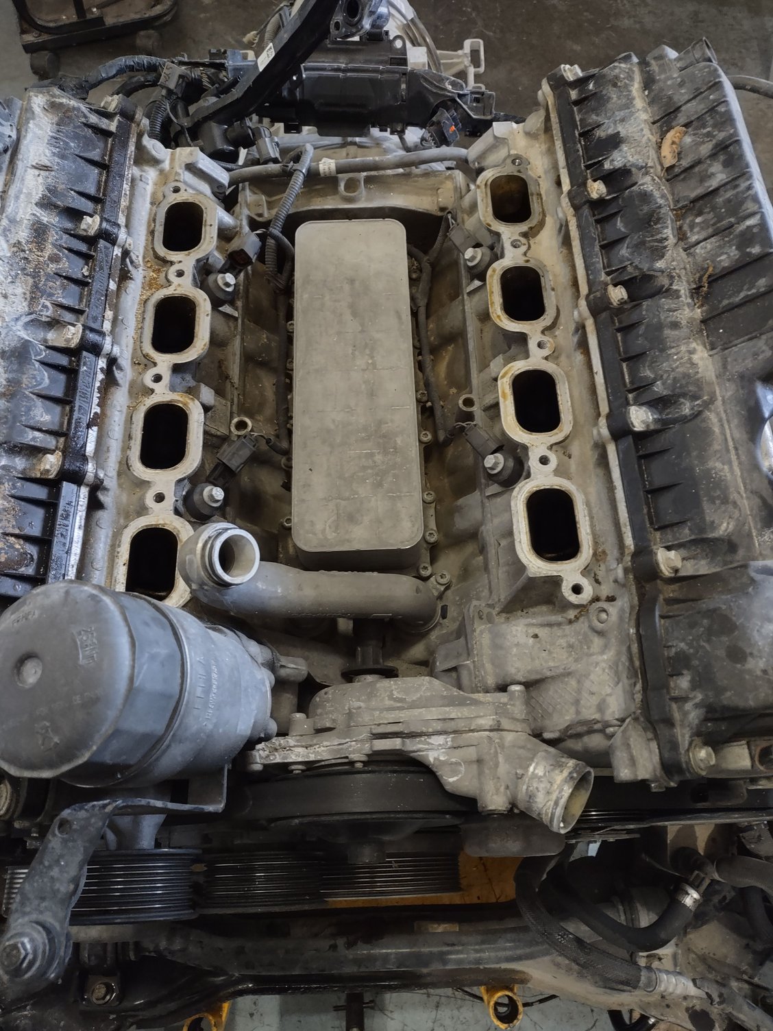

Just reread your post, thought you would were talking about the lower black piece shown in your photo, behind the water pump which connects to the heat exchanger and which just pulls off. It could be the source of your leak.
This is a 5.0 engine below but the photo may help you as I believe the 3.0 is the same in this area.

If you are wanting to replace the Y shaped pipe ( Land Rover branding), you will need to remove the SC to access it & replace. Ideally replace with the metal version. The little black tube behind the waterpump can be removed with WP off ( again ideally replace with the metal option)
