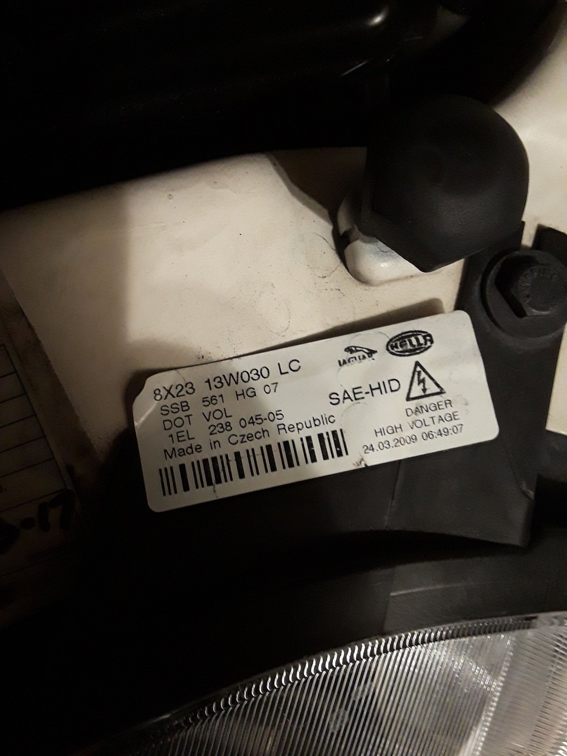

so I just posted a picture of a sticker that's on top of the light assembly when I open the hood looks like it says hid check out the picture and tell me what you think so how do I find the originals and are there brighter ones than the originals or should I just stick with the stock ones I just saw them on my eBay there's a pair for $34 I guess it's 6000 light something I don't know I guess 6000 is how bright it is let me know what you think

If it's a USA spec 2010 XFR then it's definitely bi-xenon. Standard in Premium and XFR.
You should have headlight washers. See the silver shiny piece at the bottom of the headlight assembly between the two main lamps. That pops out and sprays the headlight unit every 5-6 times that you clean the windscreen

A North American 2010 XF Supercharged (which is what yours is, not an XFR although both use the same headlights) comes from the factory with a bi-xenon HID low beam (or "dipped beam") projector lamp set outboard and a separate halogen high beam (or "full beam") lamp set inboard. Later "facelift" models used a combined outboard unit only. And yes, you do have headlight washers, cleverly hidden when not in use. My model uses exactly the same headlights as yours.
