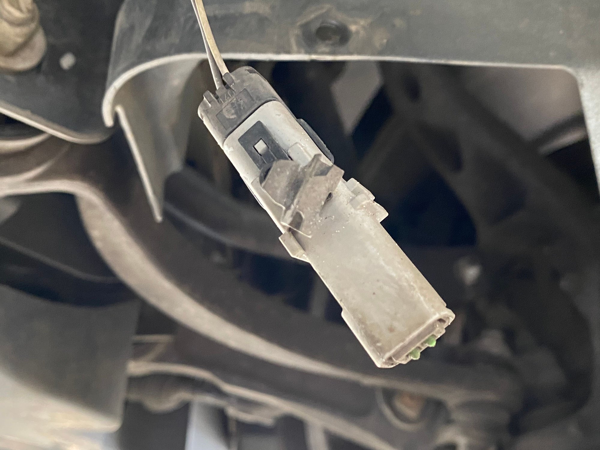

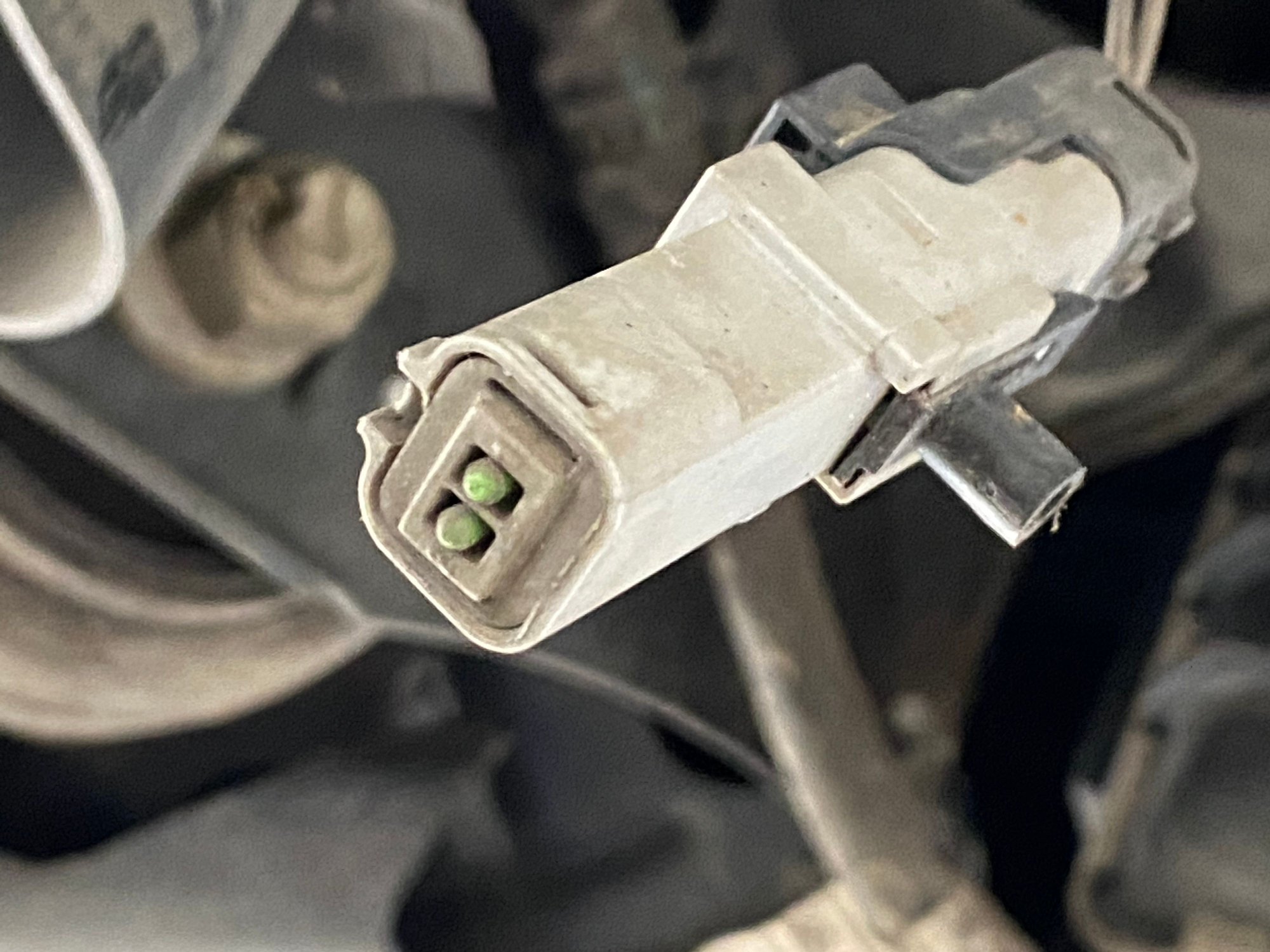

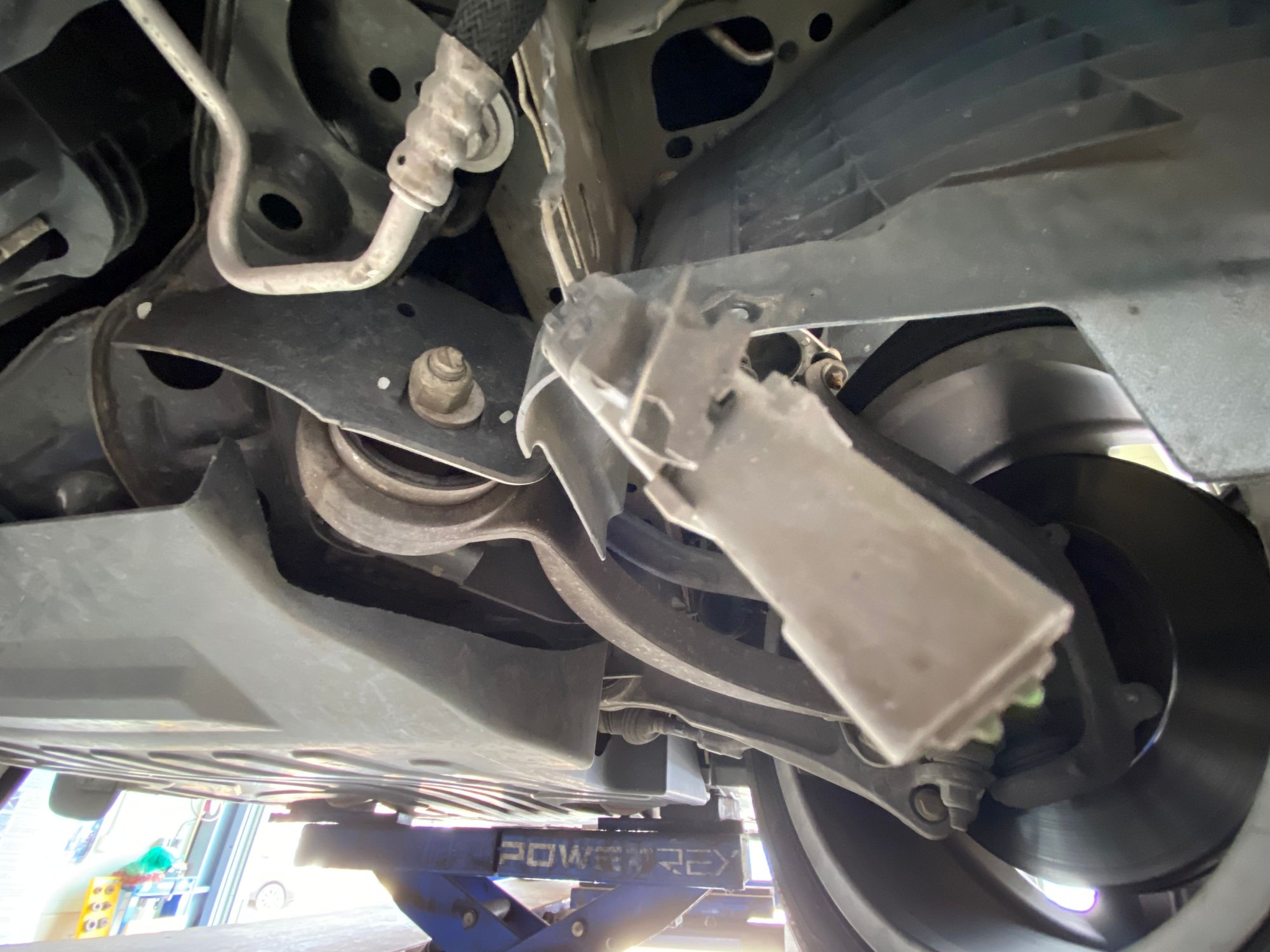

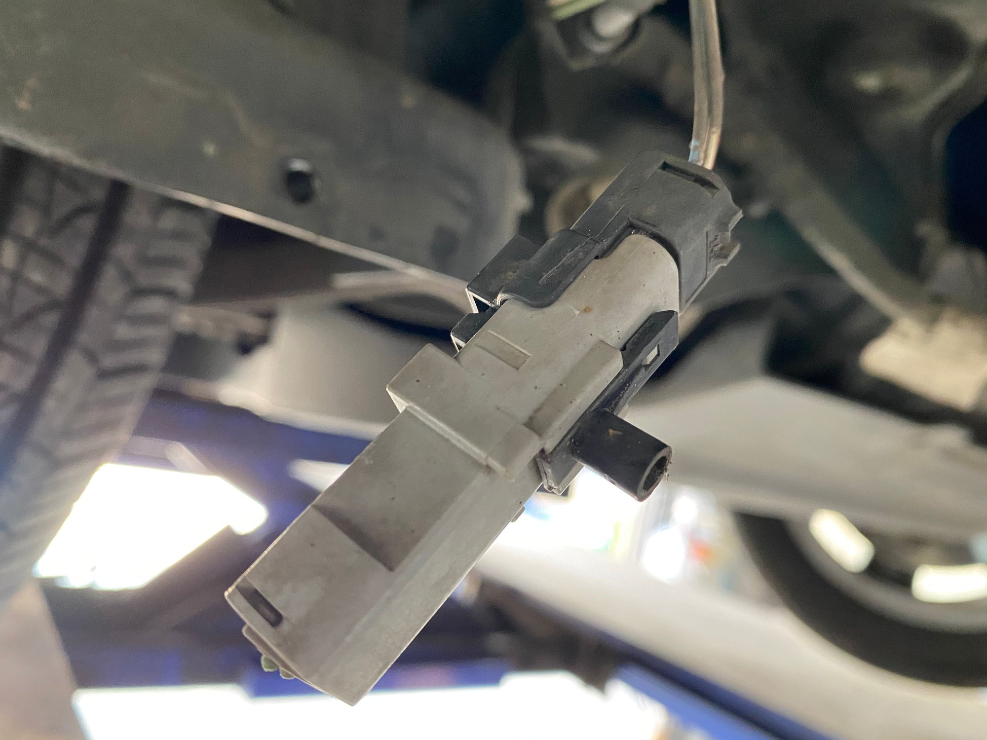

Hello, I have the front under tray off to remove the chrome look blades and discovered the wires with a connector just hanging down, 1 each side of the car. It looks as though the wires have just been cut, leaving both halves of the connector. There are 2 wires going into the connector. Any ideas?

The connector in the picture is a capped connector for an option that wasn’t requested/offered.
Some models come with different factory options. Instead of making different harnesses for every feature, Jaguar makes a harness to allow addition of features in the factory when requested by the customer/dealerships
They cap the connectors for the features that aren’t requested to prevent corrosion from spreading to the rest of the harness.

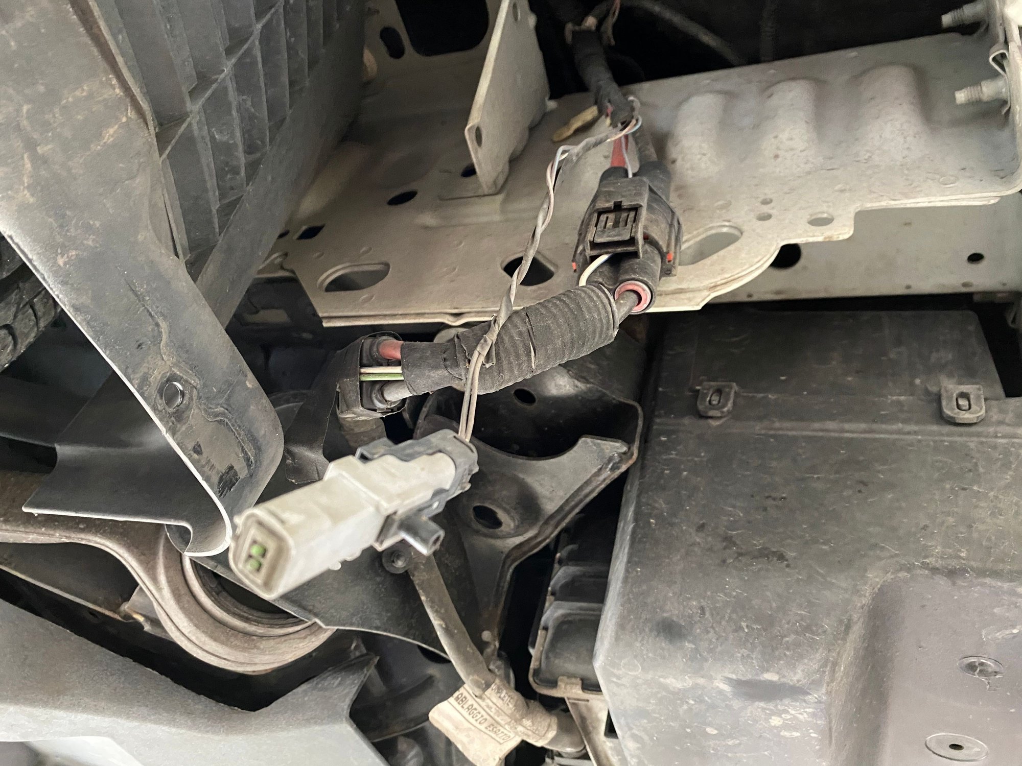

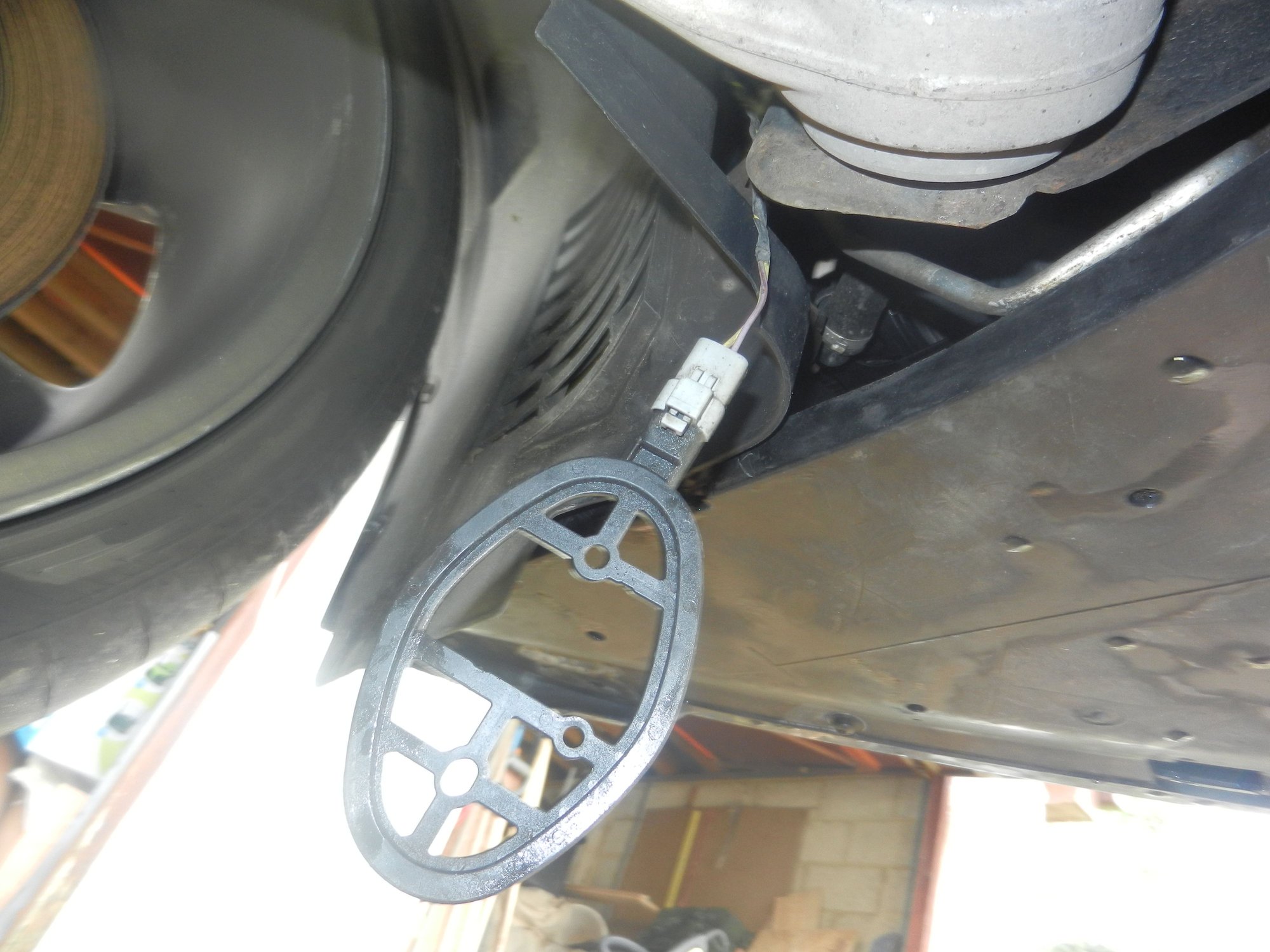

Could be the TPMS connectors........Do you have TPMS?

Looks like this TPMS connector:

Thanks all for the quick responses. I thought they might be for TPMS sensors, which aren't fitted to my car, and you have reassured me thus.
