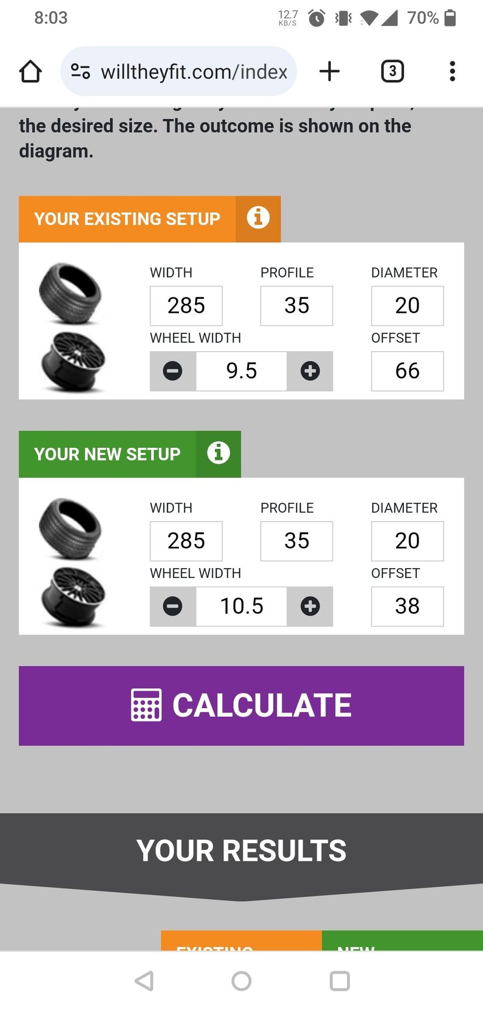

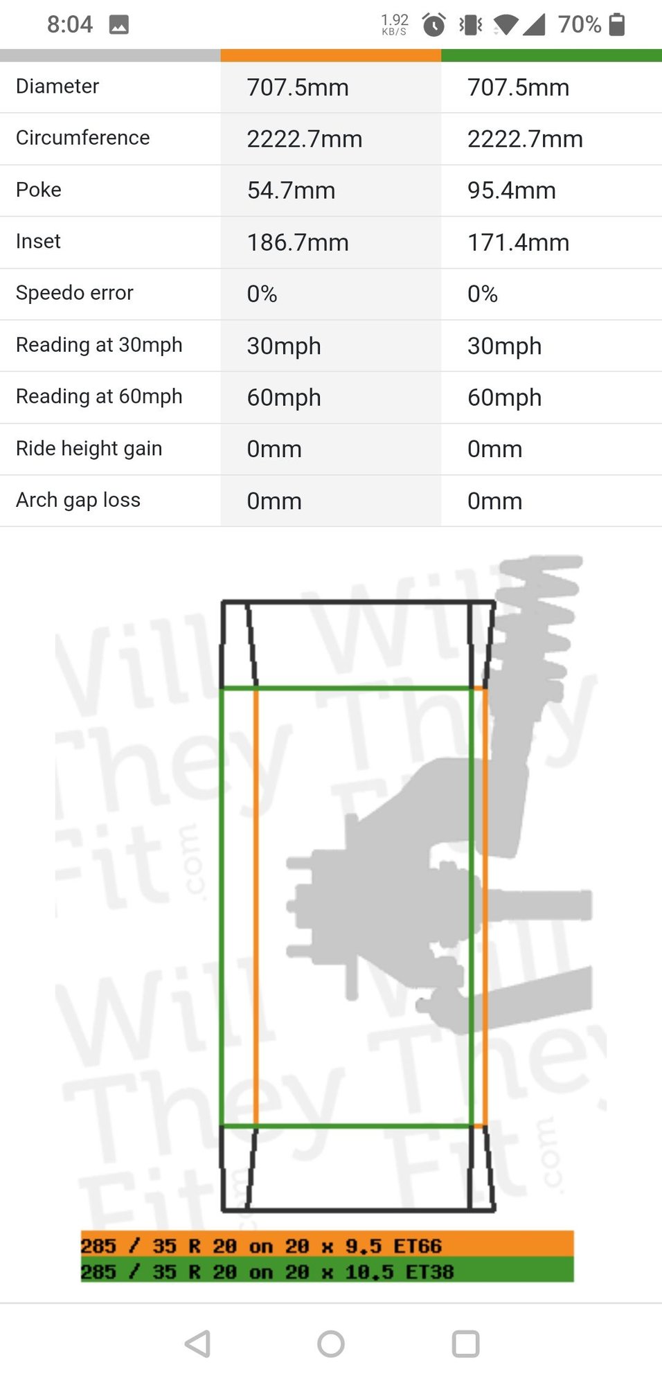

Yea I just found a online calculator...Everyone is saying they will stick out way to far in the rear ..I think it will be a touch past the fender but I don't think it will look to bad ..
this is the tool I used so yea about 41 mm ..which is about 1.5 in ..

So did a little research ..and the xf-rs has a 10.5 rear wheel with a 62 offset which is about 30 mm more than stock xfr .. 1 inch which is 25.4mm and the 4mm less offset ..So the f type wheels will stick out 10mm more than the xf-rs wheels which I think will be fine since they dont sit perfectly flush with the fenders
