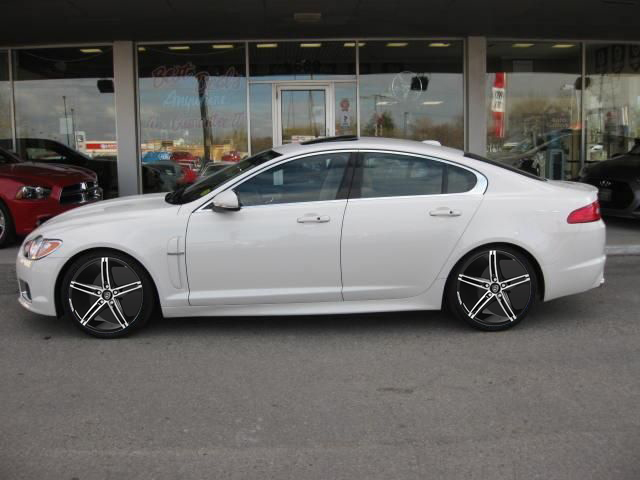

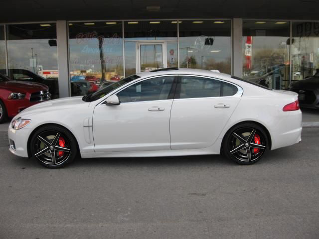

I am needing new rims as I have bent a the factory rims. What a pain in the *** this has been trying to find ones that will fit. I have contacted numerous vendors and manufacturers to find ones that will fit. Hopefully this list will help someone else out when looking. This is not a complete list, so if you know of others that will fit please add to it.
Wheels I am considering: (Sorry for the crappy photos)
Poll 1
Niche Surge

Poll 2
Lexani R3 Black with CNC

Old Aug 6, 2014 | 01:36 PM
XJL's Avatar
XJL
Posts: 835
Likes: 143
From: Southern California, USA
1. Niche Circuit but with a chrome finish (if available)
2. Niche Essen
3. Don't like any others
