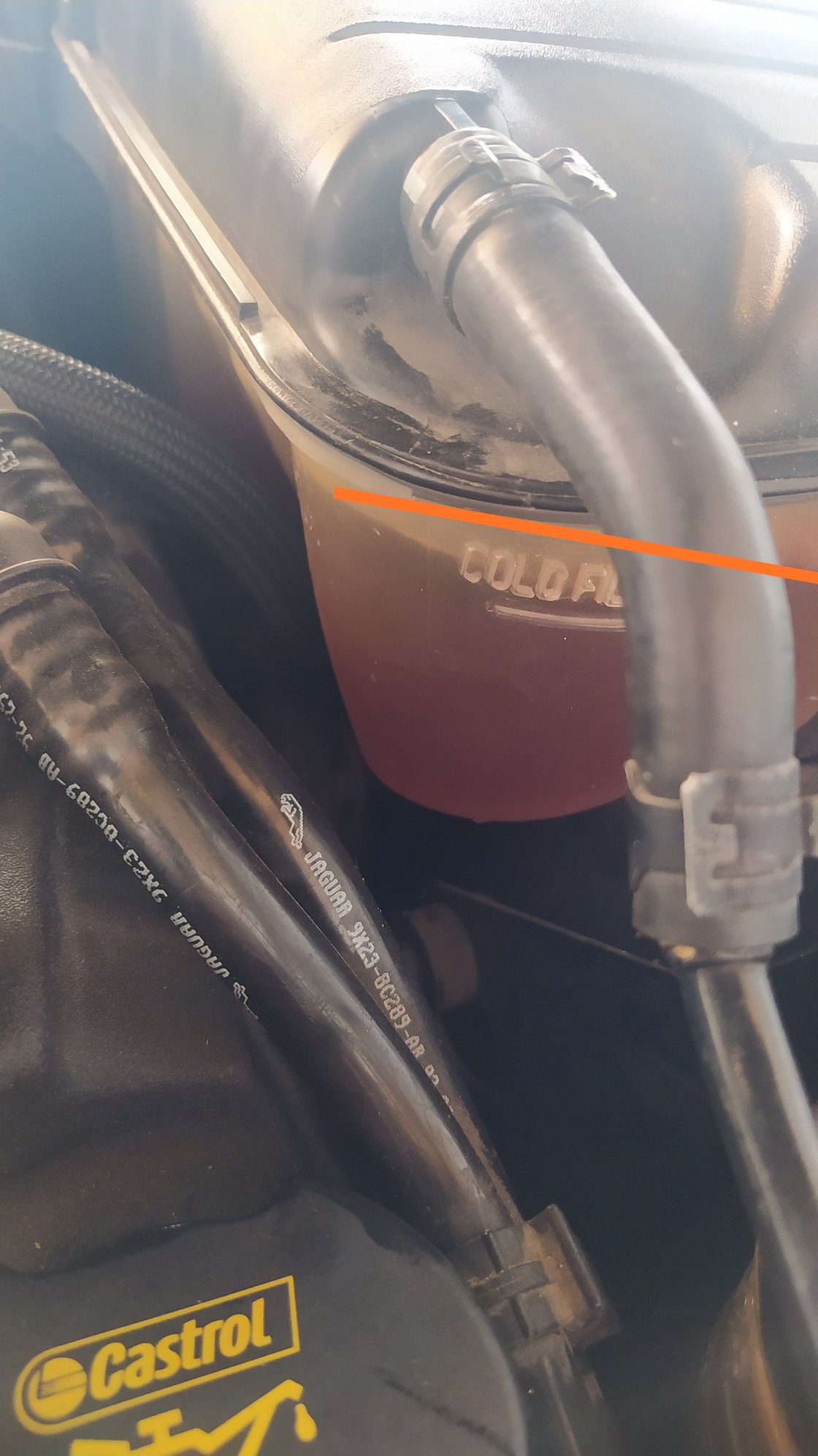

Here's a picture of the coolant level after a 150 km trip, it was filled up to the orange line.

I just checked the coolant level without turning it on after it's been sitting overnight, it dropped a bit more.
Any ideas?

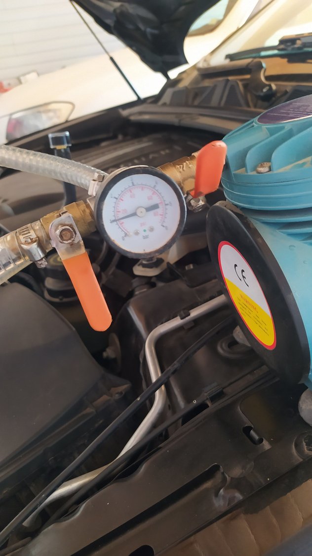

I have a hose and a manometer from an old pump, i might be able to connect it to a small compressor i have.

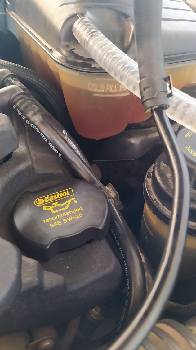

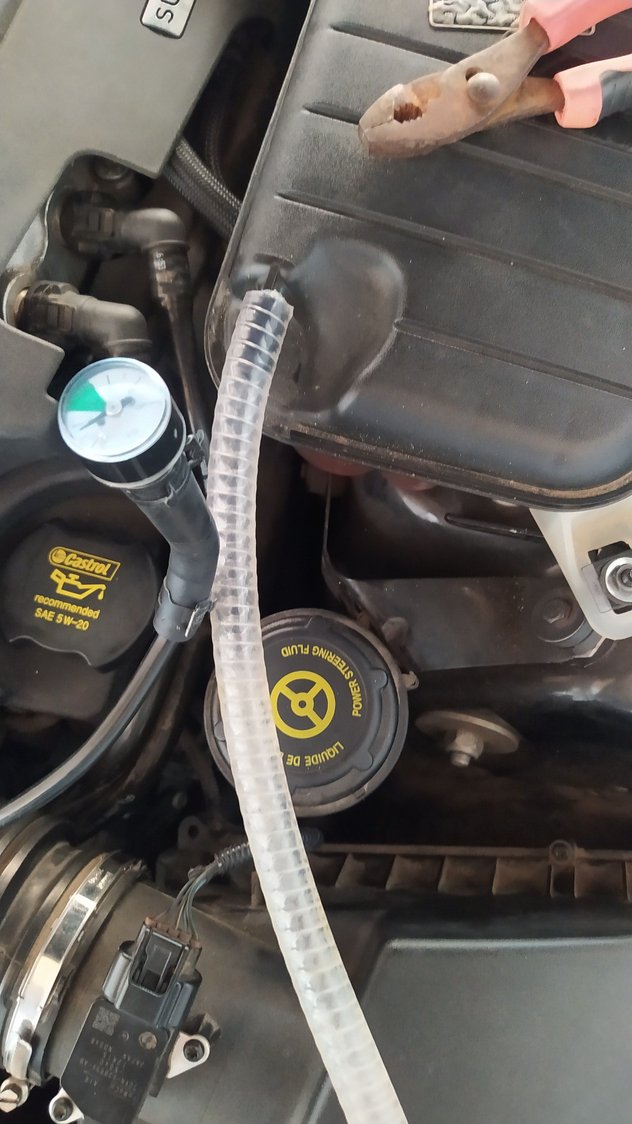

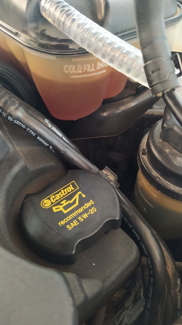

Update:
Thanks guys for all the help.
I managed to do the pressure test with the old stuff i had laying around. I removed the return line and attached the compressor hose, on the other end i added a manometer i had from work, both showed 1 bar as instructed i had it there for 15 min, pressure didn't drop.
But the level in the reservoir did drop while under pressure, as soon as I released the pressure it went back up.
After releasing the pressure.

Swelling rubber hoses or air in the cooling system somewhere?
Pressure test turned out fine don't know if it's normal for the level to drop, when pressurizing, i believe there might be an air pocket. Or the expansion tank cap could be the culprit, it's 11 years old maybe it's not holding up.
I don't know what not look for next, do these system autobleed?

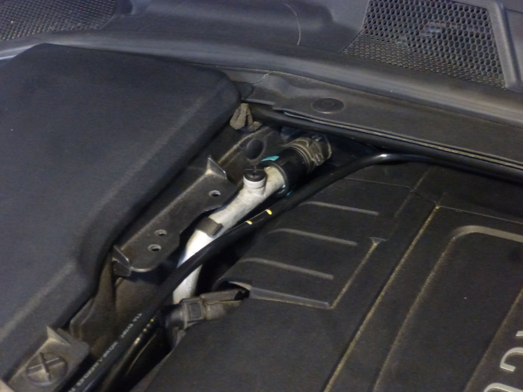

I don't think it will. I have attached a pic from my 2012 NA showing the bleed port. There will be a similar fitting on your cooling system. Care is required to remove the black plastic screw. Some forum members replace this with a brass screw. It's on my to do list!
Is there any specific procedure for bleeding, run the car remove the screw and wait untill all air is out?
Can't seem to find the part number for the screw,
This is the one i found don't know if it's bathe same one.
Bleed screw
