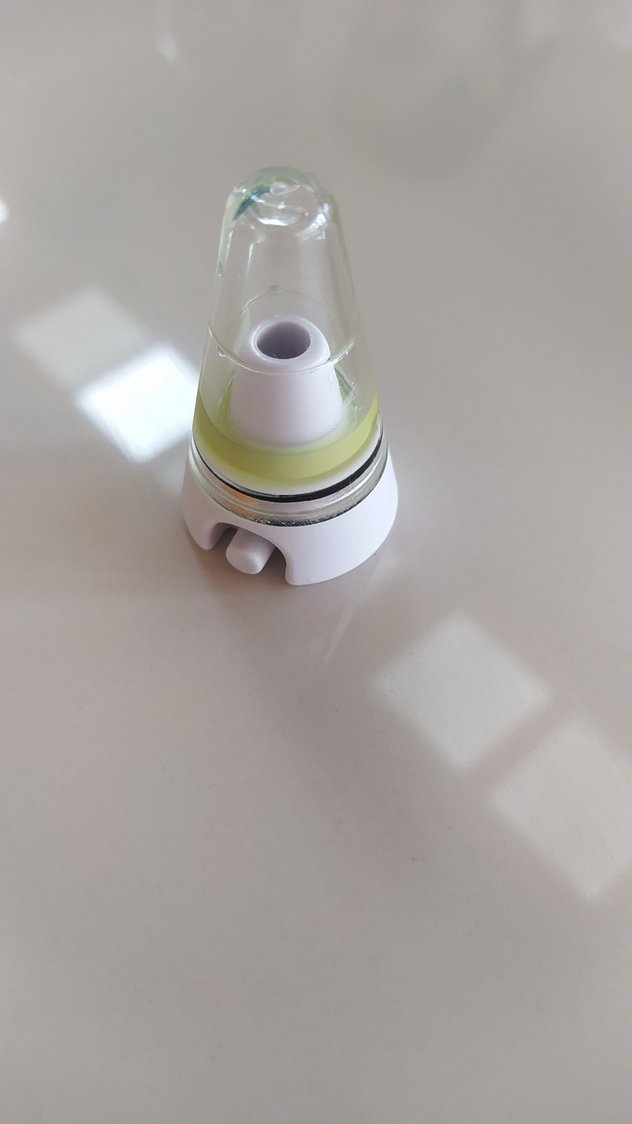

Ok guys so i tried the exhaust leak test, improvising with the aquarium test, stuff actually works it's the same chemical.
Please don't bash me over this test it's the only thing available here, it's not the appropriate tool but it's the same stuff as the leak test, it should be kind of the same thing.
​​​​​​I'm apparently good no head gasket leak.
Don't know if I had it enough time, if someone else has done this , how long time is recommended?
Coolant level haven't dropped in the last days, so again this is a mystery like everything with this car.
Old Sep 1, 2021 | 03:56 PM
  #28
Carlos Saez's Avatar
Joined: Feb 2020
Posts: 280
Likes: 62
I wasn't fully convinced so researched a bit more, 5 minutes it's all it should take more than that it could turn green cause of the coolant vapors.
So i modified it a bit stuck a hose, drilled a release hole, and used a coolant bottle cap that fitted perfectly in the reservoir.
Had is there for a bit more than 5 minutes, after the engine was hot with open thermostat.
I'm pretty sure my head gasket is fine.

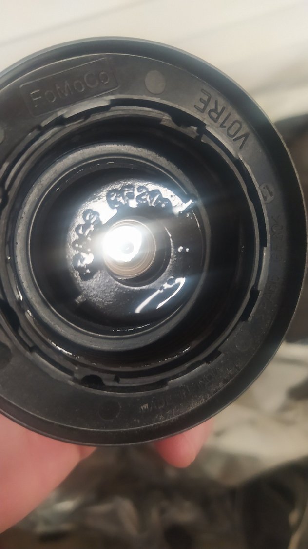

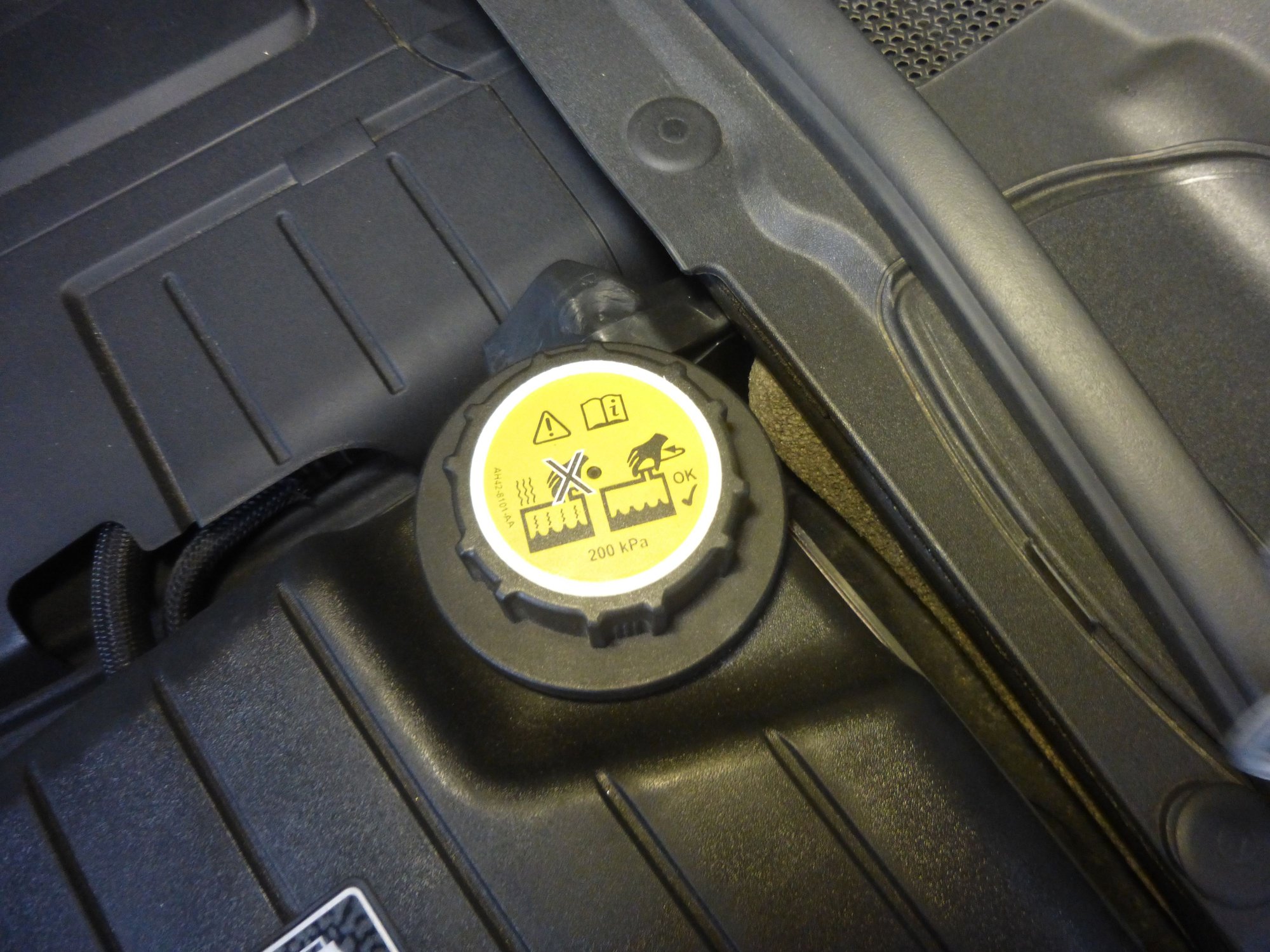

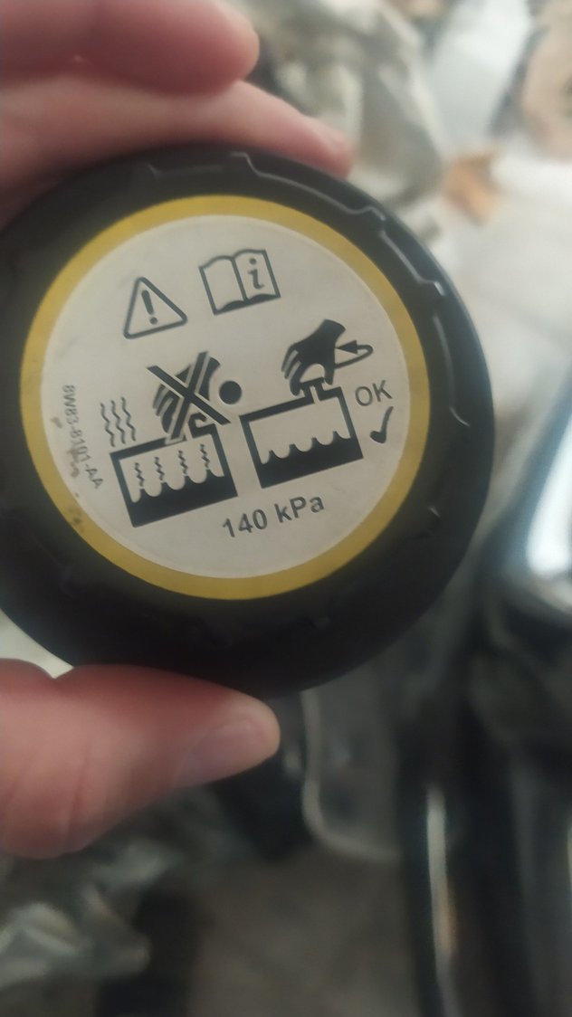

Since i can't find anything wrong, i started checking the cap.
My cap is rated 140 kpa, the part number stamped is 8W83-8101-AA, C2P17700.
The other part number C2P20325, is rated at 200kpa.
both seem to fit the XF, but there are more results for xfr with C2P20325 Cap.
Can anyone with a xfr please check their cap, maybe i have the wrong cap , or there's a newer revised one out there.
After sitting for a day the bottom of my cap is wet don't know if that is normal.
I pressed the spring metal piece in the middle, it seems jammed, needed a bit of force, after that it will depress freely.

According to my parts catalog there is a XF/XFR VIN split at R54396--from that number you need part no C2P20325.
Old Sep 4, 2021 | 08:53 AM
  #33
Joined: Feb 2020
Posts: 280
Likes: 62
MIne is R54542, not sure if I have the correct cap.
Old Sep 4, 2021 | 09:02 AM
  #34
Six Rotors's Avatar
Posts: 953
Likes: 293
From: Toronto,Canada
You need this cap
