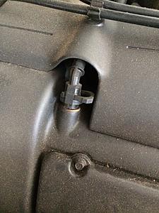

Another odd thing is a whistle from the engine, see the image (the image is not from my car, just took one from the internet, so it could be from a car from one of you, sorry for that :-) ). What could it be? My mechanic insists in doing the valves and the head surface (sorry for my non technical language, but I know you will understand) but my doubt is, why is it not burning oil? It burns white, it doesn't smell and it's only once after hours of not using it. Then no problem. When the car is in use it doesn't smoke at all...weird right?

A by proiduct of combustion in and efficient catalytic convertor is water. It accumulates in the exhaust and burns off as white smoke after start up. If the smoke were to continue while running a warm engine then you might have a water leak but if it is after start up it is normal.
The whistling you are hearing is at some point with enough drive cycles is going to bring back your LEAN condition. The part in your photo is the part load breather tube and vents the crankcase to the base of the throttle body and the evap canister. There is an O-Ring seal in the end of the tube. I would recommend being gentle with it but remove it and change the O-Ring. To replace the part load breather tube requires removing the intake manifold. You need a special tool that should be stored somewhere on a similar line to release the fitting. I have attached a picture and a part number. The line is plastic and gets quite brittle from heat. While you have the fitting off, if you look into the cam cover you will find a small hole. That orifice gets plugged with debris. Use a thin piece of wire and clean the opening. You can remove the O-Ring and match it up at the auto parts store.

Thanks a lot for your comment. It's just after startup but for sure is not normal. Have you seen the video? Do you think it could be the o-ring?
