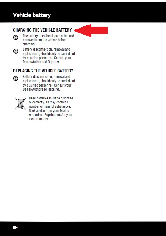

Old Feb 4, 2014 | 12:51 PM
Likes: 17,008
Originally Posted by timecode2
I am thinking it should be around 6 hours or more but wondered if anyone got any idea?
If it's flat then it will take around twelve hours to fully charge.
The Driver's Handbook gives the warning that the battery should be charged off the vehicle:
This probably isn't absolutely critical as many of us use battery tenders (e.g. CTEK) on modern Jaguars not in regular use) without disconnection.
The warning about battery removal and replacement only being "carried out by qualified personnel" is because a number of settings are lost when the battery is disconnected. With a flat battery, this will already have happened.
